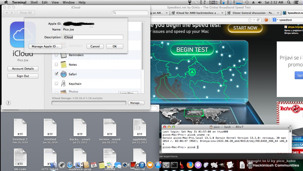

Thanks for this wonderful new kernel for old AMD CPUs like Phenom x4 9850 BE .
It is working for them in MB like Asus M3A  for Mavericks 10.9.3 (13D65) and 10.9.1.
No more need boot with -f after rename boot kernel to mach_kernel and create system cache with kext utility (2.5.6)
No more green glitch of Flash player in both 10.9.1 and 10.9.3 for Phenom x4 9850 BE in Asus M3A MB.

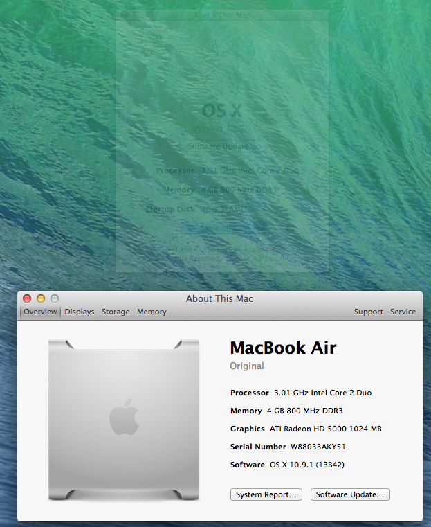

Booting is fine for Athlon x2 6000+ at Asus M4A78 PLus MB, but quite unstable after login Desktop.
Severe graphics ghost remains almost everytime.
P.S.
This bug are caused by no VoodooTSCSyncAMD.kext. You need to install this kext and bugs will finish. Also, try good FakeSMC and corecrypto if needed. I had this problem on my old AMD Athlon 64 X2 6000+, so this is the solution :)
Thanks for your advice.
After installation of VoodooTSCSyncAMD.kext previous graphics ghost disappeared.
