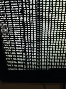

Hi bronya, exactly the same I did "sysctl -a" and suddenly frozen while desktop.
Edit.:
I do not get panic message. ., only desktop, mouse and keyboard freeze.
Tested with clover and chameleon bootloader.
With and withouth flag -cpuEFI

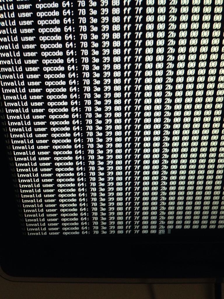

I found one odd , i tried write in terminal "sysctl -a" and i get panic .
@ Bronya
rc7 good for Fx, responds well to all applications, graphics Ok
but if you do the terminal command hangs
sysctl -a

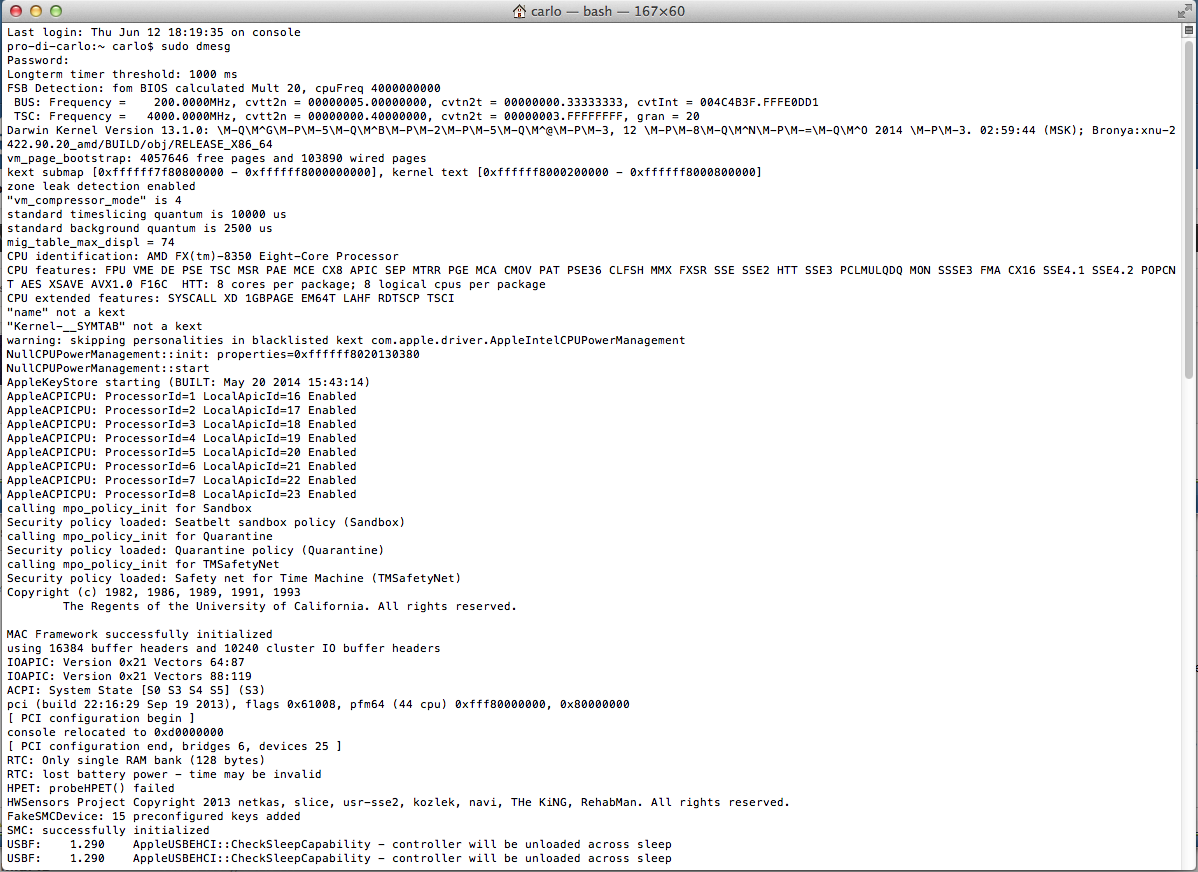

that's what I get with Kernel rc7
However, it must be said that I booted my system without bootflag "npci=0x2000".

Last login: Thu Jun 12 10:52:20 on ttys000
sosos-imac:~ soso$ sudo dmesg
r(0x89) fKeyHashTable=0x0xffffff801b4dd800
SMC::smcReadKeyAction ERROR Th0H kSMCBadArgumentError(0x89) fKeyHashTable=0x0xffffff801b4dd800
SMC::smcReadKeyAction ERROR TN0P kSMCBadArgumentError(0x89) fKeyHashTable=0x0xffffff801b4dd800

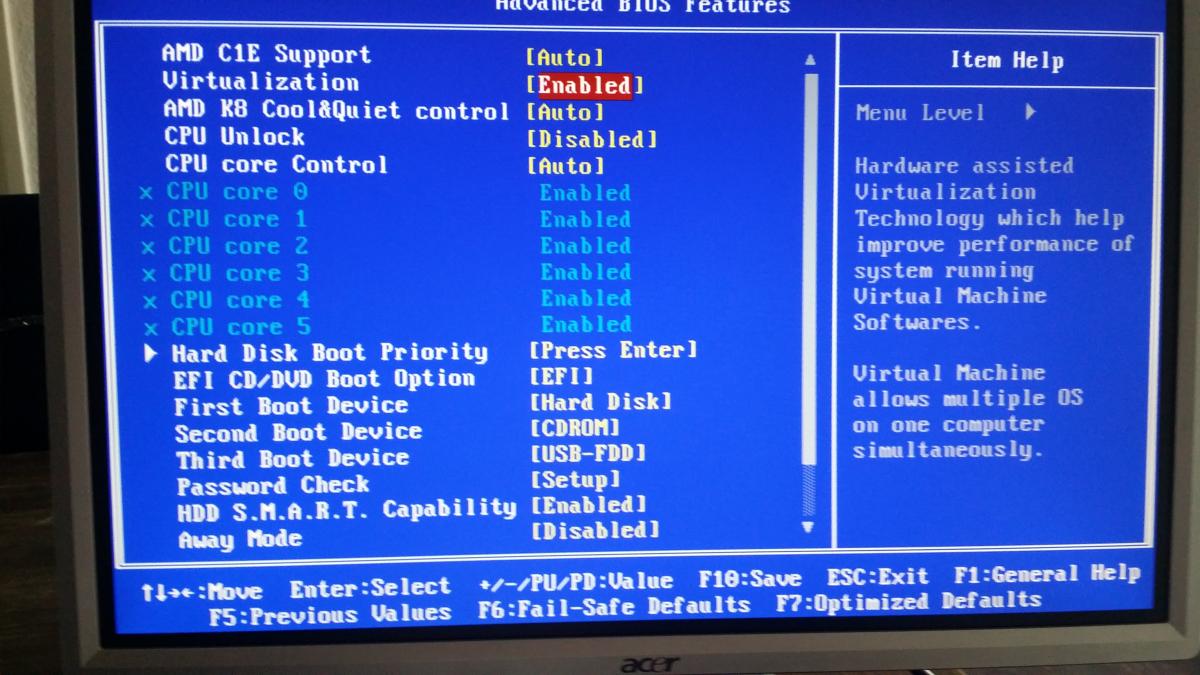

1) I have everything checked again and found that the boot flag: npci=0x2000 was included in my chameleon.boot.plist. (see Figure 1)
2) with the previous kernel, it was not possible for me to check this with sysctl.
now after a new revised kernel rc7 from Bronya , I realized my error, sorry
Conclusion: we have to boot with : npci=0x2000 or 3000 !
other changes I can confirm (see Figure 2) BIOS settings:
The system will now boot with "AMD C1E support: Auto"
"Virtualization: Enabled"
AMD K8 Cool & Quiet control: Auto
previously amd kernel it was not possible boot with BIOS settings "AMD C1E support: Auto"
here the result with mach_10_9_2__fx_bronya_rc7_fix
