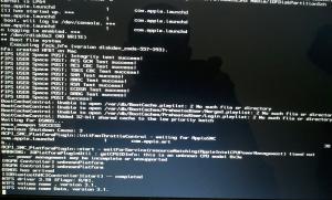

FavleX Posted March 19, 2013 Share Posted March 19, 2013 I rerun finalize but I got this error: picture sharing Any suggestions? Link to comment https://www.insanelymac.com/forum/topic/281192-guide-a-fast-and-easy-way-to-install-mountain-lion/page/8/#findComment-1898779 Share on other sites More sharing options...
tseug Posted March 21, 2013 Author Share Posted March 21, 2013 I rerun finalize but I got this error: picture sharing Any suggestions? finalize was meant to run from the USB pen drive. If you want to run it directly you would need to "cd /Volumes/mLion/Users/ema/Desktop/install" first, but I still recommend running it from the USB drive. Link to comment https://www.insanelymac.com/forum/topic/281192-guide-a-fast-and-easy-way-to-install-mountain-lion/page/8/#findComment-1899307 Share on other sites More sharing options...
FavleX Posted March 26, 2013 Share Posted March 26, 2013 yes, Thanks Tseug, I got it solved with manual kext installation. I got a different issue. With my videocard, a GeForce GT 520 2048 MB, when I attach the second display on vga port the computer power on regularly but no one display switch on. Everyone communicate's Not Signal. Neither the dvi one. Do you know is a problem videocard related or something else? Thanks Link to comment https://www.insanelymac.com/forum/topic/281192-guide-a-fast-and-easy-way-to-install-mountain-lion/page/8/#findComment-1901067 Share on other sites More sharing options...

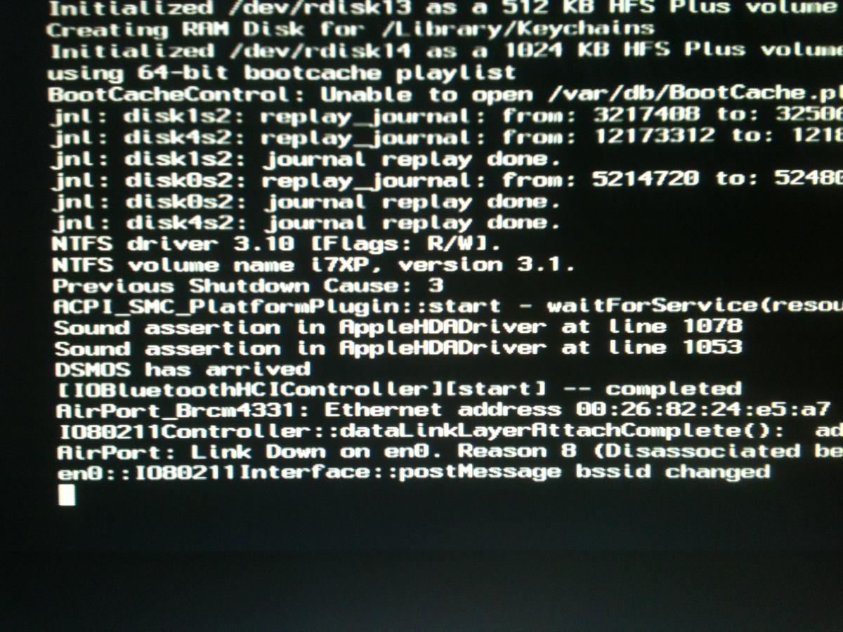

animani Posted August 31, 2013 Share Posted August 31, 2013 Anyone would know why I get stuck here after all prior to that was done successfully? Should I remove the airport card first or something? X58A UD5 Original Airport card using an adaptor Instead of a USB I am using a 10Gb partition Link to comment https://www.insanelymac.com/forum/topic/281192-guide-a-fast-and-easy-way-to-install-mountain-lion/page/8/#findComment-1942506 Share on other sites More sharing options...

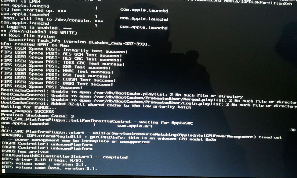

Kirill_AGA Posted September 26, 2013 Share Posted September 26, 2013 Dell OptiPlex 9020 Intel i7 (Hashwell) 16 GB RAM AMD Graphics Can't boot Chameleon, stuck on the boot screen, no error messages shown. Link to comment https://www.insanelymac.com/forum/topic/281192-guide-a-fast-and-easy-way-to-install-mountain-lion/page/8/#findComment-1948835 Share on other sites More sharing options...
