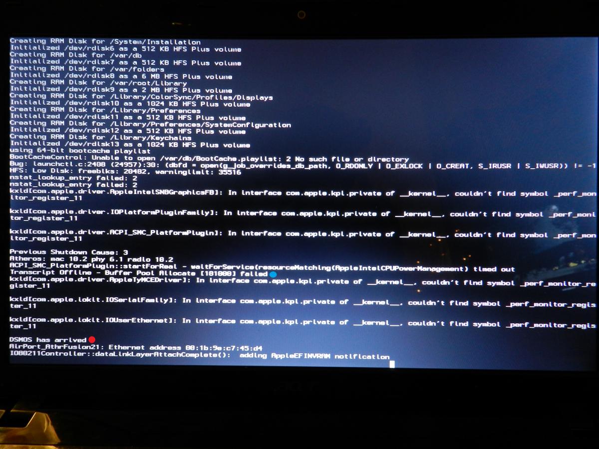

I feel quite guilty posting this here as i know its probably nothing to do with the excellent guide op :) but im not even sure i will be able to describe the problem to anyone esle out of context so i will just try my luck. i might ring apple technical support ;)
see the blue dot that is what i think is causing the hang, as this hang happens in 10.6.8 kernel and apparently 10.7.x kernal (whatever the details are about that are)
i hope sombody will be able to help me off this topic and in the right direction.
there isnt a osx DVD per-say its usb or app store download (as long as your cpu is recognised) some countries cannot buy a usb installer from apple store.

i used my hack method but i guess its just an automated version of this method. i would like to say that i have resolved my issue by adding my smbios to the usb extra including smcputype=2305 for i3 systems. i then added fake smc that i was using to boot and also fake smc to S/L/E on the installer for good measure. i then edited the usbs com.chameleon.plist and added the string to point it to my smbios. that made it boot! lots of errors came up but it booted, i now type to you on my absolutely brilliant almost a mac book pro Acer 5750 and I'm so so happy!
