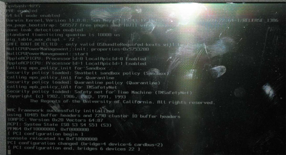

also i think i am facing a kernel panic .
http://imageshack.us/photo/my-images/202/img0726ud.jpg/
it say " no hpets found......." and then it is mentioning applecpupowermanagement ....
this is happening when i paste the extra folder and i am not running dsdt auto patcher. after i get an aml file will this error go ??
Is HPET enabled in BIOS?
http://olarila.com/forum/viewtopic.php?f=17&t=134
To prevent KP you can use:
NullCPUPowerManagement.kext
Almost the last download file on bottom of post.

done with the install . i enabled hpet in bios . nice work maldon. thanks everyone for the help.
