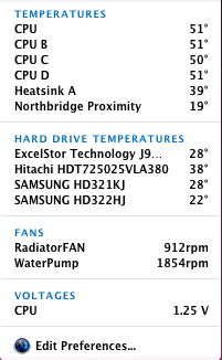

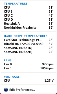

FKA Posted November 5, 2010 Share Posted November 5, 2010 Hi Mozodojo Thanks so much for your work! I'm not getting fan monitoring anymore with this latest build? FakeSMC: Opensource SMC device emulator by netkas © 2009 FakeSMC: Modified for plugins support by mozodojo © 2010 FakeSMC: Idea of FakeSMC plugins and code sample by usr-sse2 FakeSMC: Thanks to slice for help with hardware support code and plugins FakeSMCDevice: 16 keys added IntelThermal: CPU family 0x6, model 0x17, stepping 0x7, cores 4, threads 0 IntelThermal: CPU Tjmax 100 FakeSMC: adding key TC0D with handler, type sp78, size 2 FakeSMC: adding key TC1D with handler, type sp78, size 2 FakeSMC: adding key TC2D with handler, type sp78, size 2 FakeSMC: adding key TC3D with handler, type sp78, size 2 AppleIntelCPUPowerManagement: initialization completeVoodooMonitor: © 2009 Mojodojo, All Rights Reserved. Based on VoodooPower code by superhai. Special thanks to markswell for cpuid utilities. FireWire runtime power conservation disabled. (2) FireWire (OHCI) VendorID 1106 ID 3403 PCI now active, GUID xxxxxxxxxxxxxx; max speed s400. W836x: found Winbond W83667HG FakeSMC: adding key Th0H with handler, type sp78, size 2 FakeSMC: adding key TN0P with handler, type sp78, size 2 FakeSMC: adding key VC0C with handler, type fp2e, size 2 mbinit: done (64 MB memory set for mbuf pool) EDIT - just to confirm have corrected key for my Mac model (iMac9,1) And this is what I get from Everest: --------[ Sensor ]------------------------------------------------------------------------------------------------------ Sensor Properties: Sensor Type Winbond W83667HG (ISA 290h) GPU Sensor Type Diode (ATI-Diode) Motherboard Name Asus P5Q / P5Q3 / P5QL Series Chassis Intrusion Detected No Temperatures: Motherboard 20 °C (68 °F) CPU 38 °C (100 °F) CPU #1 / Core #1 50 °C (122 °F) CPU #1 / Core #2 49 °C (120 °F) CPU #1 / Core #3 51 °C (124 °F) CPU #1 / Core #4 52 °C (126 °F) GPU Diode (DispIO) 44 °C (111 °F) GPU Diode (MemIO) 48 °C (118 °F) GPU Diode (Shader) 50 °C (122 °F) ExcelStor Technology J9250S 29 °C (84 °F) Hitachi HDT725025VLA380 38 °C (100 °F) SAMSUNG HD321KJ 28 °C (82 °F) SAMSUNG HD322HJ 22 °C (72 °F) Cooling Fans: CPU 917 RPM Chassis #2 1854 RPM GPU 35% Voltage Values: CPU Core 1.25 V +3.3 V 3.31 V +5 V 5.02 V +12 V 12.10 V +5 V Standby 5.14 V Current Values: CPU 19.53 A Power Values: CPU 19.56 W Debug Info F FF 5C FF / 5B FF Debug Info T 20 38 43 / 00 Debug Info V 9C D8 D1 CF D1 FF 58 (03) Debug Info I C1 A513 Cheers D Link to comment https://www.insanelymac.com/forum/topic/234452-hwsensors-project/page/8/#findComment-1577058 Share on other sites More sharing options...

FKA Posted November 6, 2010 Share Posted November 6, 2010 Hi Mozodojo Thanks so much for your work! I'm not getting fan monitoring anymore with this latest build? Solved by changing W836x.kext info.plist <key>FANINLIMIT</key> <integer>0</integer> to <key>FANINLIMIT</key> <integer>4</integer> Bit odd to default it to 0 ?? Or even better: with <key>FANIN0</key> <string></string> <key>FANIN1</key> <string>Radiator FAN</string> <key>FANIN2</key> <string></string> <key>FANIN3</key> <string>Water Pump</string> <key>FANIN4</key> <string></string> <key>FANINLIMIT</key> <integer>4</integer> Very nice. Thanks a lot again Cheers D Link to comment https://www.insanelymac.com/forum/topic/234452-hwsensors-project/page/8/#findComment-1577901 Share on other sites More sharing options...

kozlek Posted November 7, 2010 Author Share Posted November 7, 2010 Bit odd to default it to 0 ?? Value 0 means not to override default hardcoded value. I've got default values from the datasheets. If you think default value is wrong you could override it. Im not a senior developer. I don't want to make second everest. My drivers sometimes not working properly oob so you need to configure it manually. Link to comment https://www.insanelymac.com/forum/topic/234452-hwsensors-project/page/8/#findComment-1578279 Share on other sites More sharing options...

FKA Posted November 7, 2010 Share Posted November 7, 2010 Value 0 means not to override default hardcoded value. I've got default values from the datasheets. If you think default value is wrong you could override it. Im not a senior developer. I don't want to make second everest. My drivers sometimes not working properly oob so you need to configure it manually. I knew it would be for some reason I didn't understand LOL. and I'm more than happy to have to tweak things a wee bit D Link to comment https://www.insanelymac.com/forum/topic/234452-hwsensors-project/page/8/#findComment-1578325 Share on other sites More sharing options...
