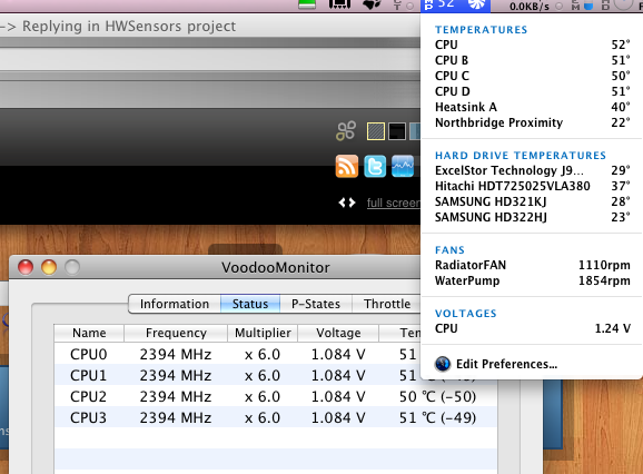

kozlek Posted November 8, 2010 Author Share Posted November 8, 2010 I can tell mine is wrong because it never changes and the voltage it shows (1.23v) is higher than the highest set by both my BIOS and in my DSDT.aml which is 1.196 after the vdroop of my board and this latter voltage is the highest I see when I open the Voodoo Monitor. Even if it was picking up the default VID of my chip then it is still wrong as that is 1.2125. What you see in iStat is a near real value. It must be different from what you set in BIOS or DSDT. This is how your speedstep working... Seems not working. Link to comment https://www.insanelymac.com/forum/topic/234452-hwsensors-project/page/9/#findComment-1578599 Share on other sites More sharing options...
MacUser2525 Posted November 8, 2010 Share Posted November 8, 2010 What you see in iStat is a near real value. It must be different from what you set in BIOS or DSDT. This is how your speedstep working... Seems not working. My speed stepping works I can see it in the Voodoo monitor it steps through all my p-states and even pops up with the one c-state I have on occasion that is how I know that part of it works as well. So I am not really sure what you mean there all I know is no matter what the voltage is always 1.23v even when I watch it jumping back and forth in the Voodoo monitor between the various states it never changes in iStat. Link to comment https://www.insanelymac.com/forum/topic/234452-hwsensors-project/page/9/#findComment-1578605 Share on other sites More sharing options...
kozlek Posted November 8, 2010 Author Share Posted November 8, 2010 VoodooMonitor doesn't shows real voltage but requested by the CPU. Request doesn't means motherboard will provide it. Like mine - after overclocking if I leave CPU voltage on AUTO in BIOS I get frozen 1.29 Vcore. Link to comment https://www.insanelymac.com/forum/topic/234452-hwsensors-project/page/9/#findComment-1578607 Share on other sites More sharing options...
MacUser2525 Posted November 8, 2010 Share Posted November 8, 2010 VoodooMonitor doesn't shows real voltage but requested by the CPU. Request doesn't means motherboard will provide it. Like mine - after overclocking if I leave CPU voltage on AUTO in BIOS I get frozen 1.29 Vcore. I am no expert at this but I know if I have nothing in my DSDT.aml that requests lower voltages through the p/c-states being defined my CPU is a full 10-12C higher just like when I run it at full 100% load ie. no speed stepping at all being used, so I have to tend to think that it is actually getting the lower voltages/speeds that are requested and shown in the monitor also without the p/c-states being defined the monitor shows my highest voltage and speed that is there when its defined which I think supports my assertion that its working. Now you could be onto something with the AUTO though I only over clock to the highest the board will go with no screwing around with the voltages and I do believe that it is set to AUTO will have to check next time I reboot and get back to you on this one. Thanks for the work I do appreciate the effort you have put into it. Link to comment https://www.insanelymac.com/forum/topic/234452-hwsensors-project/page/9/#findComment-1578617 Share on other sites More sharing options...

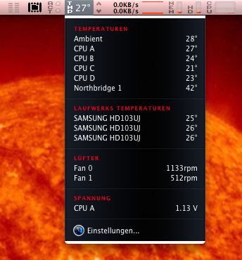

FKA Posted November 8, 2010 Share Posted November 8, 2010 Same here - I am overclocked but voltages in BIOS are set to AUTO. Must admit I hadn't payed much attention to the CPU volts in istats! Please note my CPU volts in istats does change! D Link to comment https://www.insanelymac.com/forum/topic/234452-hwsensors-project/page/9/#findComment-1578654 Share on other sites More sharing options...
kozlek Posted November 8, 2010 Author Share Posted November 8, 2010 Same here - I am overclocked but voltages in BIOS are set to AUTO. Must admit I hadn't payed much attention to the CPU volts in istats! Please note my CPU volts in istats does change! D It's not surprising. It must be deviations on all readings in real world. But still with this tool you could see what's going on. Link to comment https://www.insanelymac.com/forum/topic/234452-hwsensors-project/page/9/#findComment-1578658 Share on other sites More sharing options...
mm67 Posted November 8, 2010 Share Posted November 8, 2010 I am no expert at this but I know if I have nothing in my DSDT.aml that requests lower voltages through the p/c-states being defined my CPU is a full 10-12C higher just like when I run it at full 100% load ie. no speed stepping at all being used, so I have to tend to think that it is actually getting the lower voltages/speeds that are requested and shown in the monitor also without the p/c-states being defined the monitor shows my highest voltage and speed that is there when its defined which I think supports my assertion that its working. Now you could be onto something with the AUTO though I only over clock to the highest the board will go with no screwing around with the voltages and I do believe that it is set to AUTO will have to check next time I reboot and get back to you on this one. Thanks for the work I do appreciate the effort you have put into it. On my Gigabyte boards C -states only work when Cpu voltage is set to Normal or Auto in bios. With Auto option FSB has to be at stock value. Same thing happens with my Asus P5Q Deluxe board, my MSI P43 doesn't care about Cpu voltage, C - states always work. Link to comment https://www.insanelymac.com/forum/topic/234452-hwsensors-project/page/9/#findComment-1578678 Share on other sites More sharing options...
Pietruszka Posted November 8, 2010 Share Posted November 8, 2010 Stock voltage is normal if you overclock there is DVID (dynamic VID) function (in BIOS) that can help to overclock and keep cpu cool --> dynamic voltage mobo must support this function...not all mobos got it Link to comment https://www.insanelymac.com/forum/topic/234452-hwsensors-project/page/9/#findComment-1578939 Share on other sites More sharing options...
