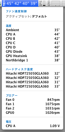

kantok Posted October 21, 2010 Share Posted October 21, 2010 It really got to me. With all in E/E, works great for me! Thanks a lot!!!! Link to comment https://www.insanelymac.com/forum/topic/234452-hwsensors-project/page/6/#findComment-1567933 Share on other sites More sharing options...
XLR Posted October 21, 2010 Share Posted October 21, 2010 It really got to me. With all in E/E, works great for me!Thanks a lot!!!! Wow! Even ambient temperature, even GPU fan! What motherboard are you using? Link to comment https://www.insanelymac.com/forum/topic/234452-hwsensors-project/page/6/#findComment-1567957 Share on other sites More sharing options...
kantok Posted October 22, 2010 Share Posted October 22, 2010 Wow! Even ambient temperature, even GPU fan! What motherboard are you using? @XLR Yeah, it's wonderful! My M/B is EP45-UD3P and set model name as MacPro 3,1. Link to comment https://www.insanelymac.com/forum/topic/234452-hwsensors-project/page/6/#findComment-1568004 Share on other sites More sharing options...

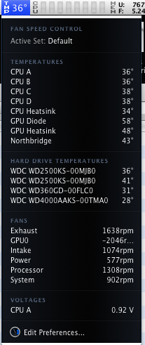

THe KiNG Posted October 22, 2010 Share Posted October 22, 2010 @mozodojo I tested your latest comit, and have some small bugs to report on W83667HG(ASUS P6T7 WS SC): - I saw u limited this chip fans to 2, dunno why but works just fine here with all 5(see pic bellow) - Ambient didn't worked for me, but as is in source now CPU Heatsink is gone, I did a small change in source to get it back: case W83667HG: { // Heatsink if (!addSensor(KEY_CPU_HEATSINK_TEMPERATURE, TYPE_SP78, 2, kSuperIOTemperatureSensor, 0)) WarningLog("error adding heatsink temperature sensor"); // Northbridge if (!addSensor(KEY_NORTHBRIDGE_TEMPERATURE, TYPE_SP78, 2, kSuperIOTemperatureSensor, 2)) WarningLog("error adding system temperature sensor"); break; } - On NVClock, I get negative fan value, I know is not your work but I saw Slice fixed same bug on his ACPIMonitor, maybe you can look on what he did... Looking forward for your next updates. Thanks! Link to comment https://www.insanelymac.com/forum/topic/234452-hwsensors-project/page/6/#findComment-1568101 Share on other sites More sharing options...

Gringo Vermelho Posted October 22, 2010 Share Posted October 22, 2010 I tested your latest comit, and have some small bugs to report on W83667HG(ASUS P6T7 WS SC):- I saw u limited this chip fans to 2, dunno why but works just fine here with all 5(see pic bellow) Yes, mine is missing a fan (and AUXTIN) as well - it's a Winbond 83627DHG, pics in post#5: http://www.insanelymac.com/forum/index.php...t&p=1564661 Link to comment https://www.insanelymac.com/forum/topic/234452-hwsensors-project/page/6/#findComment-1568383 Share on other sites More sharing options...

Maniac10 Posted October 24, 2010 Share Posted October 24, 2010 Wow, I can see every sensor of my h55m-usb3, now all that's left is an Ati Graphics card plugin Link to comment https://www.insanelymac.com/forum/topic/234452-hwsensors-project/page/6/#findComment-1569068 Share on other sites More sharing options...

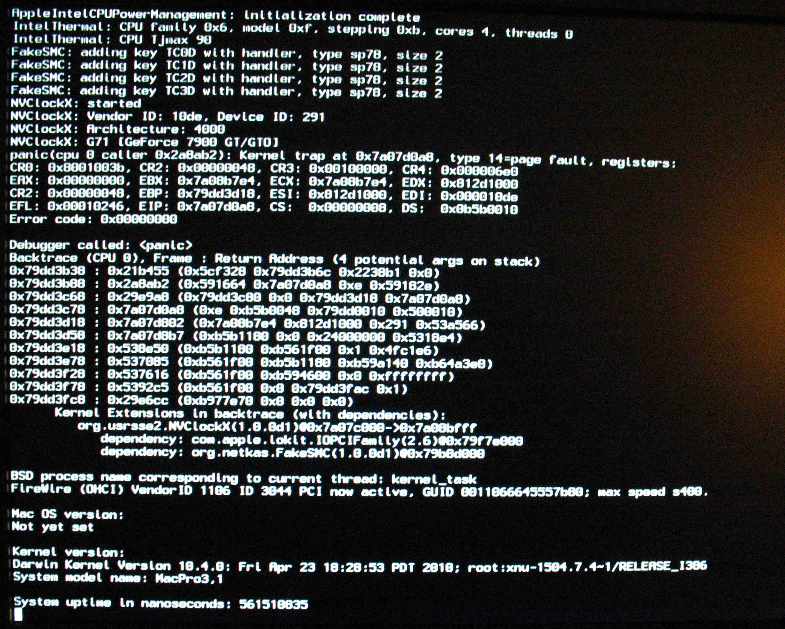

chibchan Posted October 24, 2010 Share Posted October 24, 2010 KP with NVclockX.kext from E/E. If i remove it then no more kp. Here's a boot log. btw, can some please explain to me how to use the bdmesg utility. Link to comment https://www.insanelymac.com/forum/topic/234452-hwsensors-project/page/6/#findComment-1569446 Share on other sites More sharing options...
