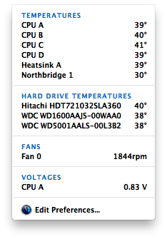

DarwinX Posted October 20, 2010 Share Posted October 20, 2010 There is no voltage support in NSC part of FakeSMCSuperIO. Maybe chip does not support voltage readings. Slice's FakeSMC iStat 3.10: Link to comment Share on other sites More sharing options...

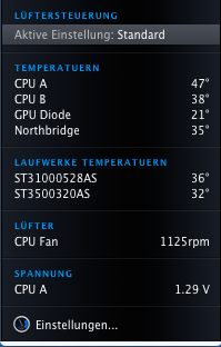

kozlek Posted October 20, 2010 Author Share Posted October 20, 2010 Slice's FakeSMC iStat 3.10: Why don't you say me that you're using IntelMonitor? There is no voltage support in NSC code, but IntelMonitor could calculate "voltage" from P-States information and provide voltage reading. If you don't believe, check the code from assembla: void NSC::Start() { IOMemoryDescriptor * theDescriptor; UInt32 adr = (ListenPortByte(NSC_MEM)&0xff)+((ListenPortByte(NSC_MEM+1)<<8)&0xff00)+ ((ListenPortByte(NSC_MEM+2)&0xff)<<16)+((ListenPortByte(NSC_MEM+3)&0xff)<<24); IOPhysicalAddress bar = (IOPhysicalAddress)(adr & ~0xf); // IOLog("Fx3100: register space=%08lx\n", (long unsigned int)bar); theDescriptor = IOMemoryDescriptor::withPhysicalAddress (bar, 0x200, kIODirectionOutIn); // | kIOMapInhibitCache); if(theDescriptor != NULL) { mmio = theDescriptor->map (); if(mmio != NULL) { // UInt32 addr = map->getPhysicalAddress(); mmio_base = (volatile UInt8 *)mmio->getVirtualAddress(); #if 0 UInt32 base_phys = (UInt32)mmio->getPhysicalAddress(); InfoLog(" Memory mapped at address %08lx\n", (long unsigned int)base_phys); for (int i=0; i<0x2f; i +=16) { IOLog("%04lx: ", (long unsigned int)i); for (int j=0; j<16; j += 1) { IOLog("%02lx ", (long unsigned int)mmio_base[i+j]); } IOLog("\n"); } //mmio->release(); #endif } else { InfoLog(" MCHBAR failed to map\n"); return; } } // Heatsink AddSensor(new NSCTemperatureSensor(this, 2, KEY_CPU_HEATSINK_TEMPERATURE, TYPE_SP78, 2)); // Northbridge AddSensor(new NSCTemperatureSensor(this, 0, KEY_NORTHBRIDGE_TEMPERATURE, TYPE_SP78, 2)); // Heatsink AddSensor(new NSCTemperatureSensor(this, 1, KEY_DIMM_TEMPERATURE, TYPE_SP78, 2)); // Northbridge AddSensor(new NSCTemperatureSensor(this, 3, KEY_AUX_TEMPERATURE, TYPE_SP78, 2)); char key[5]; int id=GetNextUnusedKey(KEY_FORMAT_FAN_ID, key); int ac=GetNextUnusedKey(KEY_FORMAT_FAN_SPEED, key); if (id!=-1 || ac!=-1) { int no=id>ac ? id : ac; char name[] = "System Fan"; int lname = sizeof(name); // snprintf (name, 10, "System Fan"); snprintf(key, 5, KEY_FORMAT_FAN_ID, no); FakeSMCAddKey(key, TYPE_CH8, lname, name); snprintf(key, 5, KEY_FORMAT_FAN_SPEED, no); AddSensor(new NSCTachometerSensor(this, 4, key, TYPE_FP2E, 2)); UpdateFNum(); FanCount = 1; } Even the NSCVoltageSensor class not present in NSC part of FakeSMCSuperIO plugin. Link to comment Share on other sites More sharing options...

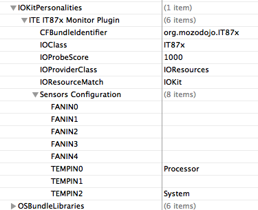

MacKonsti Posted October 20, 2010 Share Posted October 20, 2010 You need to edit info.plist of IT87x.kext Like TjMax on the screnshot, you need to play with "Sensors Configuration". There is 3 temperature inputs for ITE chip. By default first is the CPU, and 3-rd is the chipset or simular.Hello mozodojo and thanks for your tip. I checked the Info.plist of your work over at ProjectOSX (FakeSMCSuperIO.kext) and the entries are exactly the same as the ones in your new plugin, here in this thread: <key>Sensors Configuration</key> <dict> <key>FANIN0</key> <string>Chassis</string> <--mine <key>FANIN1</key> <string></string> <key>FANIN2</key> <string></string> <key>FANIN3</key> <string></string> <key>FANIN4</key> <string></string> <key>TEMPIN0</key> <string>System</string> <-- same <key>TEMPIN1</key> <string></string> <key>TEMPIN2</key> <string>Processor</string> <-- same </dict> ...with the only difference that (from /S/L/E/) I do get an extra reading for the Northbridge chip (or whatever). So, could it be a different implementation of this new kext? Or the fact it's loading from /E/E? Could the second sensor be the HDD temperatures of the system? Sorry if I may get on your nerves and request more info What other options except System and Processor do we have as strings in the section above of Info.plist? Thank you again! In the meantime, I will reboot a few times and change the order of the System and Processor entries and see what happens (hope I don't get KP otherwise I am screwed!) SERIOUS EDIT: I get Kernel Panics if I change the sequence of System and Processor to anything else than the original list in your Info.plist. Sorry.... I had a hard time reverting to a stable system! Link to comment Share on other sites More sharing options...

kozlek Posted October 20, 2010 Author Share Posted October 20, 2010 Hello mozodojo and thanks for your tip. I checked the Info.plist of your work over at ProjectOSX (FakeSMCSuperIO.kext) and the entries are exactly the same as the ones in your new plugin, here in this thread: <key>Sensors Configuration</key> <dict> <key>FANIN0</key> <string>Chassis</string> <--mine <key>FANIN1</key> <string></string> <key>FANIN2</key> <string></string> <key>FANIN3</key> <string></string> <key>FANIN4</key> <string></string> <key>TEMPIN0</key> <string>System</string> <-- same <key>TEMPIN1</key> <string></string> <key>TEMPIN2</key> <string>Processor</string> <-- same </dict> ...with the only difference that (from /S/L/E/) I do get an extra reading for the Northbridge chip (or whatever). So, could it be a different implementation of this new kext? Or the fact it's loading from /E/E? Could the second sensor be the HDD temperatures of the system? Sorry if I may get on your nerves and request more info What other options except System and Processor do we have as strings in the section above of Info.plist? Thank you again! In the meantime, I will reboot a few times and change the order of the System and Processor entries and see what happens (hope I don't get KP otherwise I am screwed!) SERIOUS EDIT: I get Kernel Panics if I change the sequence of System and Processor to anything else than the original list in your Info.plist. Sorry.... I had a hard time reverting to a stable system! So, kext working from E/E/ and S/L/E for me and other people. I'll try to change sensors. If it'll be work without KP, so 99% the problem is in your system, Mac OS X. Why wouldn't I believe you, you're the expert?! I had erroneously assumed that the SuperIO was responsible for the CPU voltage.So, how do I get the CPU voltage then? You couldn't before I'll port IntelMonitor. Link to comment Share on other sites More sharing options...

kozlek Posted October 21, 2010 Author Share Posted October 21, 2010 Hello mozodojo and thanks for your tip. I checked the Info.plist of your work over at ProjectOSX (FakeSMCSuperIO.kext) and the entries are exactly the same as the ones in your new plugin, here in this thread: <key>Sensors Configuration</key> <dict> <key>FANIN0</key> <string>Chassis</string> <--mine <key>FANIN1</key> <string></string> <key>FANIN2</key> <string></string> <key>FANIN3</key> <string></string> <key>FANIN4</key> <string></string> <key>TEMPIN0</key> <string>System</string> <-- same <key>TEMPIN1</key> <string></string> <key>TEMPIN2</key> <string>Processor</string> <-- same </dict> ...with the only difference that (from /S/L/E/) I do get an extra reading for the Northbridge chip (or whatever). So, could it be a different implementation of this new kext? Or the fact it's loading from /E/E? Could the second sensor be the HDD temperatures of the system? Sorry if I may get on your nerves and request more info What other options except System and Processor do we have as strings in the section above of Info.plist? Thank you again! In the meantime, I will reboot a few times and change the order of the System and Processor entries and see what happens (hope I don't get KP otherwise I am screwed!) SERIOUS EDIT: I get Kernel Panics if I change the sequence of System and Processor to anything else than the original list in your Info.plist. Sorry.... I had a hard time reverting to a stable system! Reverted System and Processor, added Auxiliary and removed = working without any issue. P.S. still weird stuff happens for some users when they loading plugins from extra. Link to comment Share on other sites More sharing options...
