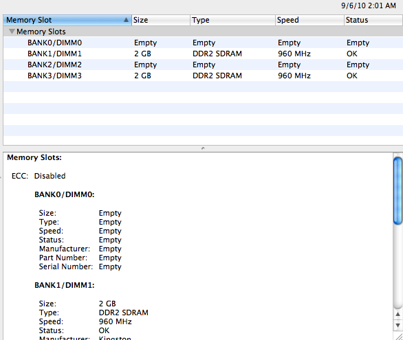

iRipper Posted September 5, 2010 Share Posted September 5, 2010 Chameleon detects my RAM running at 960 instead of 800 I have 3 setings in my BIOS for RAM - Auto, 800 and 667. If I select Auto or 800 - Chameleon detects it as 960, but if I select 667, Chameleon shows 800. Link to comment https://www.insanelymac.com/forum/topic/225766-chameleon-rc5-mode-with-mem-detection-enabled-and-automatic-p-states-c-states-generation-for-native-power-managment/page/33/#findComment-1543463 Share on other sites More sharing options...
kup Posted September 5, 2010 Share Posted September 5, 2010 That is probably due to an FSB overclock? Link to comment https://www.insanelymac.com/forum/topic/225766-chameleon-rc5-mode-with-mem-detection-enabled-and-automatic-p-states-c-states-generation-for-native-power-managment/page/33/#findComment-1543470 Share on other sites More sharing options...
Gringo Vermelho Posted September 5, 2010 Share Posted September 5, 2010 He's not using the smbios.plist I made and uploaded for him earlier. That was a waste of time apparently, I guess I'm a fool for trying to help people. I'll make sure to be less helpful in the future. He has this in his smbios.plist: 960/4 = 240. Here: http://www.insanelymac.com/forum/index.php...t&p=1541530 I've polished your Mac Pro smbios.plist a bit, added more Mac Pro DMI data, and removed redundant memory and bus speed settings - Chameleon 2.0 RC5 takes care of that now. Link to comment https://www.insanelymac.com/forum/topic/225766-chameleon-rc5-mode-with-mem-detection-enabled-and-automatic-p-states-c-states-generation-for-native-power-managment/page/33/#findComment-1543471 Share on other sites More sharing options...
iRipper Posted September 5, 2010 Share Posted September 5, 2010 I am using your smbios.plist smbios.plist.zip Link to comment https://www.insanelymac.com/forum/topic/225766-chameleon-rc5-mode-with-mem-detection-enabled-and-automatic-p-states-c-states-generation-for-native-power-managment/page/33/#findComment-1543484 Share on other sites More sharing options...
Gringo Vermelho Posted September 5, 2010 Share Posted September 5, 2010 Right then..sorry for assuming things above. Still..this just keeps getting weirder all the time. Are you sure you don't have another /Extra folder somewhere? It's seems to be more than a coincidence how the bus speed override you had in your old smbios.plist is a perfect match with the wrong memory speed reported by Chameleon - 240*4=960. Link to comment https://www.insanelymac.com/forum/topic/225766-chameleon-rc5-mode-with-mem-detection-enabled-and-automatic-p-states-c-states-generation-for-native-power-managment/page/33/#findComment-1543492 Share on other sites More sharing options...

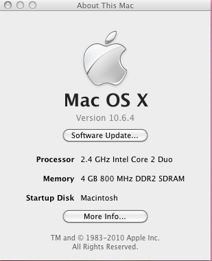

iRipper Posted September 5, 2010 Share Posted September 5, 2010 In about this Mac it shows the memory at correct speed. In more info --> Memory - shows 960. And I have only 1 Extra folder Link to comment https://www.insanelymac.com/forum/topic/225766-chameleon-rc5-mode-with-mem-detection-enabled-and-automatic-p-states-c-states-generation-for-native-power-managment/page/33/#findComment-1543496 Share on other sites More sharing options...
Gringo Vermelho Posted September 5, 2010 Share Posted September 5, 2010 A long-shot...but try placing your RAM in the first and the third slot instead of the second and the fourth. Maybe System Profiler just needs a little nudge.. *shrugs* Link to comment https://www.insanelymac.com/forum/topic/225766-chameleon-rc5-mode-with-mem-detection-enabled-and-automatic-p-states-c-states-generation-for-native-power-managment/page/33/#findComment-1543501 Share on other sites More sharing options...
