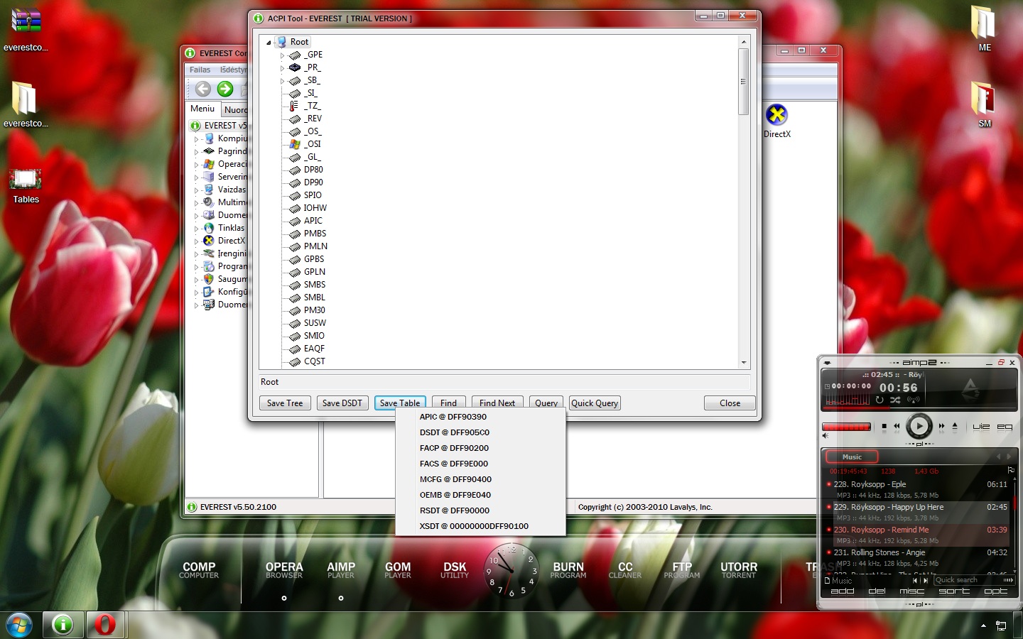

Gringo Vermelho Posted September 1, 2010 Share Posted September 1, 2010 Now we're getting somewhere! I'm guessing you have no SSDT tables to extract because you're overclocking. Overclocking automatically disables speedstepping and other ACPI CPU power management features on ASUS boards. Disable your overclock and enable all advanced CPU features in the BIOS, except "Max CPU ID Value Limit" and "Single Logical Processor Mode". Refer to page 22-23 of your motherboard manual. Then try running Everest again, the SSDT tables should hopefully appear...? If not then I have no idea what's going on. Link to comment https://www.insanelymac.com/forum/topic/225766-chameleon-rc5-mode-with-mem-detection-enabled-and-automatic-p-states-c-states-generation-for-native-power-managment/page/29/#findComment-1541430 Share on other sites More sharing options...
iRipper Posted September 1, 2010 Share Posted September 1, 2010 Nope. All advanced features enabled,except Max CPU ID. My BIOS doesn't show anything about Single Logical Processor. No overclock. No SSDT or HPET tables show in Everest. All the same In OS X AppleHPET and AppleLPC are NOT loaded. Link to comment https://www.insanelymac.com/forum/topic/225766-chameleon-rc5-mode-with-mem-detection-enabled-and-automatic-p-states-c-states-generation-for-native-power-managment/page/29/#findComment-1541438 Share on other sites More sharing options...
Gringo Vermelho Posted September 1, 2010 Share Posted September 1, 2010 This can't be happening. lol Enter the BIOS again, set "AI Overclock Tuner" to "Auto" and enable ACPI APIC and ACPI 2.0. Then try again. I'm using a paid version of Everest Corporate Edition, I noticed you're using Ultimate. Does anybody know if you have to pay for Everest in order for it to dump SSDT tables? It seems odd to lock out something like that - but I guess it's possible. In the meantime, try the Corporate edition as well. Link to comment https://www.insanelymac.com/forum/topic/225766-chameleon-rc5-mode-with-mem-detection-enabled-and-automatic-p-states-c-states-generation-for-native-power-managment/page/29/#findComment-1541445 Share on other sites More sharing options...
iRipper Posted September 1, 2010 Share Posted September 1, 2010 Overclock on Auto and running default 2.0 GHz. Adding ACPI 2.0 support adds XSDT table in Everest So how come I can boot with and without DSDT.aml? Is this normal and common? Corporate Everest shows the same: Link to comment https://www.insanelymac.com/forum/topic/225766-chameleon-rc5-mode-with-mem-detection-enabled-and-automatic-p-states-c-states-generation-for-native-power-managment/page/29/#findComment-1541451 Share on other sites More sharing options...
Gringo Vermelho Posted September 1, 2010 Share Posted September 1, 2010 I can boot with no DSDT as well, since using Chameleon 2.0 RC5 from this thread. If you've tried everything I said, then I really don't understand what's going on. Did you enable ACPI 2.0 and ACPI APIC? I edited my post several times, so you might have missed that part. EDIT hmm yes you did.. well at least you got an XSDT table, that's got to count for something. You can try booting with a Linux Live CD (I recommend this: http://www.linuxmint.com/edition.php?id=52 ) and run ACPIDump to get your SSDT tables - there's a guide somewhere around here that will show you how. Now for the famous last straw - maybe it's a bit drastic, but I'm out of ideas. Do a CMOS reset. Unplug the power supply from the mains, take out the motherboard battery, close the CLRRTC jumper on the motherboard (refer to your motherboard manual) and leave it like this for 5 minutes. Then do it in reverse (power supply last). When you start it up again, enter the BIOS and enable ACPI 2.0, ACPI APIC and make sure all advanced CPU features (except CPUID Limit) are enabled and that the AI Overclock thing is set to Auto. Then boot into Windows and try Everest again. Link to comment https://www.insanelymac.com/forum/topic/225766-chameleon-rc5-mode-with-mem-detection-enabled-and-automatic-p-states-c-states-generation-for-native-power-managment/page/29/#findComment-1541457 Share on other sites More sharing options...

iRipper Posted September 2, 2010 Share Posted September 2, 2010 Okay, so I used this Python script to extract tables straight from OS X and SSDT and SSDT-1 tables were generated. Is it what I need? I dropped both SSDT's to my Extra folder and rebooted, now my bdmesg dump looks like this Last login: Thu Sep 2 03:26:37 on ttys000 /Extra/Util/bdmesg ; exit; 84-32-86-149-ip:~ CoolCat$ /Extra/Util/bdmesg ; exit; msr(221): ia32_perf_stat 0x06000a28 max: 10 current: 10 CPU: Vendor/Model/ExtModel: 0x756e6547/0xf/0x0 CPU: Family/ExtFamily: 0x6/0x0 CPU: MaxCoef/CurrCoef: 0xa/0xa CPU: MaxDiv/CurrDiv: 0x0/0x0 CPU: TSCFreq: 2400MHz CPU: FSBFreq: 240MHz CPU: CPUFreq: 2400MHz CPU: NoCores/NoThreads: 2/2 CPU: Features: 0x0000024f Attempting to read GPT Read GPT Reading GPT partition 1, type C12A7328-F81F-11D2-BA4B-00A0C93EC93B Reading GPT partition 2, type 48465300-0000-11AA-AA11-00306543ECAC Reading GPT partition 3, type 48465300-0000-11AA-AA11-00306543ECAC Reading GPT partition 4, type 48465300-0000-11AA-AA11-00306543ECAC Read HFS+ file: [hd(0,2)/Extra/com.apple.Boot.plist] 2806 bytes. Read HFS+ file: [hd(0,2)/Extra/Themes/Default/theme.plist] 2720 bytes. Read HFS+ file: [hd(0,2)/Extra/Themes/Default/background.png] 727414 bytes. Read HFS+ file: [hd(0,2)/Extra/Themes/Default/logo.png] 333 bytes. Read HFS+ file: [hd(0,2)/Extra/Themes/Default/device_generic.png] 92927 bytes. Read HFS+ file: [hd(0,2)/Extra/Themes/Default/device_hfsplus.png] 456092 bytes. Read HFS+ file: [hd(0,2)/Extra/Themes/Default/device_ext3.png] 201604 bytes. Read HFS+ file: [hd(0,2)/Extra/Themes/Default/device_fat16.png] 88658 bytes. Read HFS+ file: [hd(0,2)/Extra/Themes/Default/device_fat32.png] 89144 bytes. Read HFS+ file: [hd(0,2)/Extra/Themes/Default/device_ntfs.png] 373283 bytes. Read HFS+ file: [hd(0,2)/Extra/Themes/Default/device_cdrom.png] 206454 bytes. Read HFS+ file: [hd(0,2)/Extra/Themes/Default/device_selection.png] 14941 bytes. Read HFS+ file: [hd(0,2)/Extra/Themes/Default/device_scroll_prev.png] 4046 bytes. Read HFS+ file: [hd(0,2)/Extra/Themes/Default/device_scroll_next.png] 4133 bytes. Read HFS+ file: [hd(0,2)/Extra/Themes/Default/menu_boot.png] 1747 bytes. Read HFS+ file: [hd(0,2)/Extra/Themes/Default/menu_verbose.png] 4116 bytes. Read HFS+ file: [hd(0,2)/Extra/Themes/Default/menu_ignore_caches.png] 4051 bytes. Read HFS+ file: [hd(0,2)/Extra/Themes/Default/menu_single_user.png] 4114 bytes. Read HFS+ file: [hd(0,2)/Extra/Themes/Default/menu_memory_info.png] 1634 bytes. Read HFS+ file: [hd(0,2)/Extra/Themes/Default/menu_video_info.png] 1593 bytes. Read HFS+ file: [hd(0,2)/Extra/Themes/Default/menu_help.png] 1711 bytes. Read HFS+ file: [hd(0,2)/Extra/Themes/Default/menu_verbose_disabled.png] 1370 bytes. Read HFS+ file: [hd(0,2)/Extra/Themes/Default/menu_ignore_caches_disabled.png] 1445 bytes. Read HFS+ file: [hd(0,2)/Extra/Themes/Default/menu_single_user_disabled.png] 1485 bytes. Read HFS+ file: [hd(0,2)/Extra/Themes/Default/menu_selection.png] 323 bytes. Read HFS+ file: [hd(0,2)/Extra/Themes/Default/progress_bar.png] 250 bytes. Read HFS+ file: [hd(0,2)/Extra/Themes/Default/progress_bar_background.png] 366 bytes. Read HFS+ file: [hd(0,2)/Extra/Themes/Default/text_scroll_prev.png] 733 bytes. Read HFS+ file: [hd(0,2)/Extra/Themes/Default/text_scroll_next.png] 739 bytes. Read HFS+ file: [hd(0,2)/Extra/Themes/Default/font_console.png] 5562 bytes. Read HFS+ file: [hd(0,2)/Extra/Themes/Default/font_small.png] 83288 bytes. Read HFS+ file: [hd(0,2)/Extra/com.apple.Boot.plist] 2806 bytes. Setting boot-uuid to: 14B32D9B-FE15-36A3-933F-060F0807381A Read HFS+ file: [hd(0,2)/System/Library/CoreServices/SystemVersion.plist] 479 bytes. Loading Darwin 10.6 Loading kernel mach_kernel Read HFS+ file: [hd(0,2)/mach_kernel] 4096 bytes. Read HFS+ file: [hd(0,2)/mach_kernel] 5576574 bytes. Read HFS+ file: [hd(0,2)/Extra/Extensions/Disabler.kext/Contents/Info.plist] 1800 bytes. Read HFS+ file: [hd(0,2)/Extra/Extensions/Fakesmc.kext/Contents/Info.plist] 2333 bytes. Read HFS+ file: [hd(0,2)/Extra/Extensions/IOAHCIBlockStorageInjector.kext/Contents/Info.plist] 1271 bytes. Read HFS+ file: [hd(0,2)/Extra/Extensions/JMicronATA.kext/Contents/Info.plist] 1932 bytes. Read HFS+ file: [hd(0,2)/Extra/Extensions/NullCPUPowerManagement.kext/Contents/Info.plist] 1498 bytes. LoadDrivers: Loading from [/system/Library/Caches/com.apple.kext.caches/Startup/Extensions.mkext] Read HFS+ file: [hd(0,2)/System/Library/Caches/com.apple.kext.caches/Startup/Extensions.mkext] 4096 bytes. Read HFS+ file: [hd(0,2)/System/Library/Caches/com.apple.kext.caches/Startup/Extensions.mkext] 4049521 bytes. Read HFS+ file: [hd(0,2)/Extra/Extensions/Disabler.kext/Contents/MacOS/Disabler] 4096 bytes. Read HFS+ file: [hd(0,2)/Extra/Extensions/Disabler.kext/Contents/MacOS/Disabler] 28976 bytes. Read HFS+ file: [hd(0,2)/Extra/Extensions/Fakesmc.kext/Contents/MacOS/fakesmc] 4096 bytes. Read HFS+ file: [hd(0,2)/Extra/Extensions/Fakesmc.kext/Contents/MacOS/fakesmc] 59920 bytes. Read HFS+ file: [hd(0,2)/Extra/Extensions/JMicronATA.kext/Contents/MacOS/JMicronATA] 4096 bytes. Read HFS+ file: [hd(0,2)/Extra/Extensions/JMicronATA.kext/Contents/MacOS/JMicronATA] 67404 bytes. Read HFS+ file: [hd(0,2)/Extra/Extensions/NullCPUPowerManagement.kext/Contents/MacOS/NullCPUPowerManagement] 4096 bytes. Read HFS+ file: [hd(0,2)/Extra/Extensions/NullCPUPowerManagement.kext/Contents/MacOS/NullCPUPowerManagement] 33240 bytes. Using PCI-Root-UID value: 0 Read HFS+ file: [hd(0,2)/Extra/SMBIOS.plist] 749 bytes. Intel P35/G33 DRAM Controller [8086:29c0] at 00:00.0 Frequency detected: 480 MHz (960) Dual Channel 5-5-5-18 Slot: 1 Type 19 2048MB (DDR2 SDRAM) 960MHz Vendor=Kingston PartNo= SerialNo=47CC243E Slot: 3 Type 19 2048MB (DDR2 SDRAM) 960MHz Vendor=Kingston PartNo= SerialNo=33CC6441 Patched DMI Table Found SMBIOS System Information Table 1 Customizing SystemID with : 00b8cdc7-873c-dd11-8324-001fc6c67019 efi_inject_get_devprop_string NULL trying stringdata Read HFS+ file: [hd(0,2)/Extra/DSDT.aml] 26972 bytes. Read HFS+ file: [hd(0,2)/Extra/SSDT.aml] 165 bytes. Read HFS+ file: [hd(0,2)/Extra/SSDT-1.aml] 302 bytes. ACPI table not found: SSDT-2.aml FADT: Restart Fix applied! FADT: Using custom DSDT! Found ACPI CPU: CPU1 Found ACPI CPU: CPU2 Found ACPI CPU: CPU3 Found ACPI CPU: CPU4 SSDT with CPU C-States generated successfully SSDT with CPU P-States generated successfully RSDT: Added 4 SSDT table(s) Starting Darwin x86_64 Read HFS+ file: [hd(0,2)/Extra/Themes/Default/boot.png] 10950 bytes. logout [Process completed] ACPI_tables.zip get_acpi_tables.py.zip Link to comment https://www.insanelymac.com/forum/topic/225766-chameleon-rc5-mode-with-mem-detection-enabled-and-automatic-p-states-c-states-generation-for-native-power-managment/page/29/#findComment-1541509 Share on other sites More sharing options...
Gringo Vermelho Posted September 2, 2010 Share Posted September 2, 2010 It looks like you have dumped the SSDT tables that are generated by the bootloader ("SSDT with CPU C/P-States generated successfully"), not the ones from your BIOS! Delete Disabler.kext from /Extra/Extensions - there's no need for Disabler.kext when you're already using NullCPUPM.kext. This must be why Deleting NullCPUPM.kext doesn't work for you - Disabler.kext takes over and does the same thing. Are you still overclocking? Your RAM speed looks wrong so...either you're still overclocking, you have odd values in /extra/smbios.plist or there's a bug in Chameleon. Please don't overclock until we get this working. Link to comment https://www.insanelymac.com/forum/topic/225766-chameleon-rc5-mode-with-mem-detection-enabled-and-automatic-p-states-c-states-generation-for-native-power-managment/page/29/#findComment-1541511 Share on other sites More sharing options...
