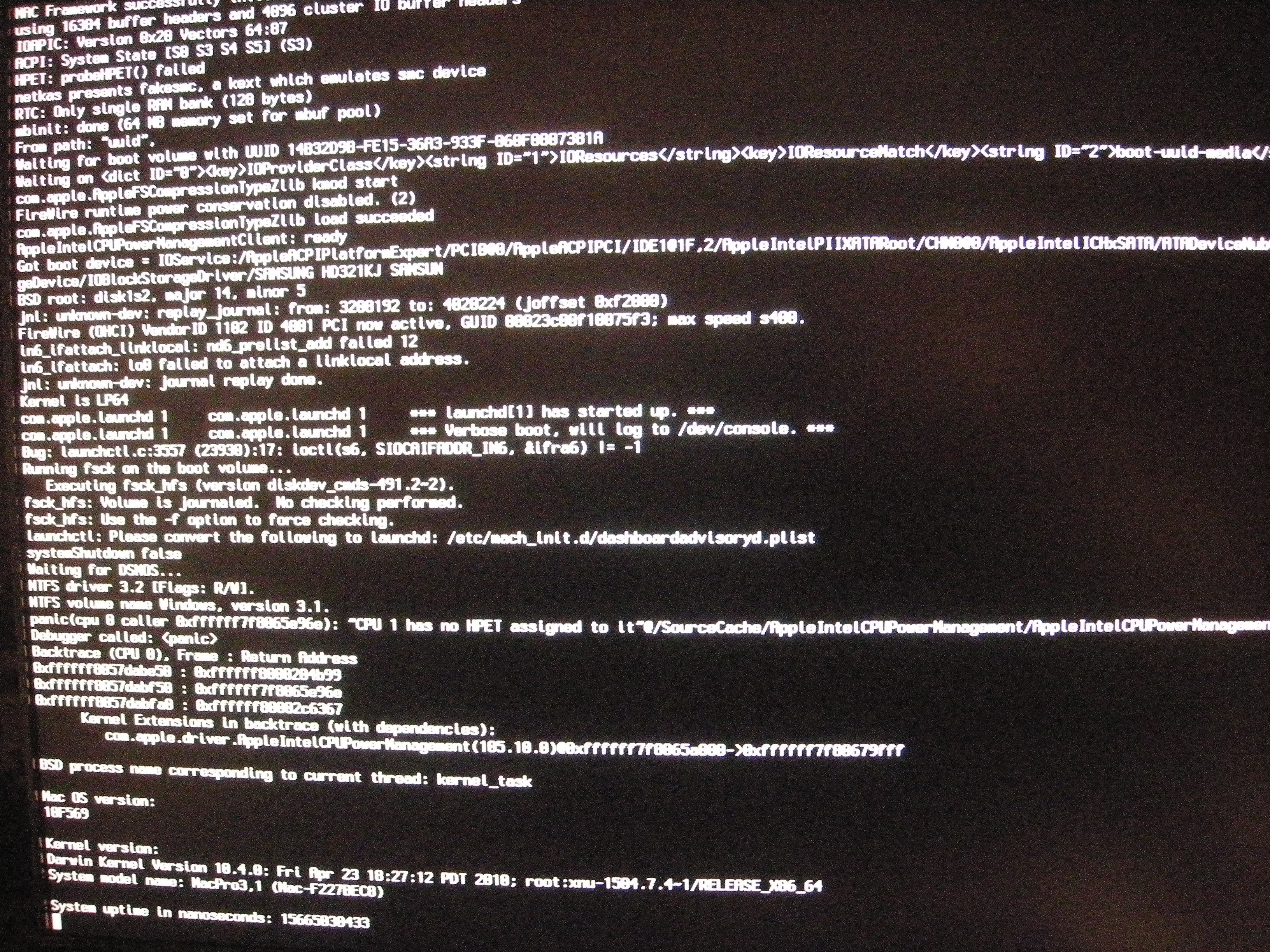

iRipper Posted September 2, 2010 Share Posted September 2, 2010 Excuse me for {censored} quality, gorrila style photos , but this is the KP I get. Maybe you'll be able to see something Link to comment Share on other sites More sharing options...
rednous Posted September 2, 2010 Share Posted September 2, 2010 @blackosx Here's the Chameleon Bulgarian localization @iRipper Something's wrong with your HPET section in the DSDT, imho. Your HPET should be similar to the below: Device (HPET) { Name (_HID, EisaId ("PNP0103")) Name (_STA, 0x0F) Name (_CRS, ResourceTemplate () { IRQNoFlags () {0} IRQNoFlags () {8} Memory32Fixed (ReadWrite, 0xFED00000, // Address Base 0x00000400, // Address Length ) }) } EDIT: Wow, man, your DSDT is huge and messy , seems as it's the original one. I would advice you to start from here -- DSDT mods/edits for P5K Boards and this recent thread too - DSDT Editor and Patcher. It's a long way to go but you have to modify your own DSDT. Link to comment Share on other sites More sharing options...

oldnapalm Posted September 2, 2010 Share Posted September 2, 2010 @iRipper: it's strange that "HPET: probeHPET() failed" in your log, since your DSDT has an HPET device defined. Does your BIOS config have an HPET option? You can try Chameleon's ForceHPET option. @RaMDaY: they are not options, you need all the 3 files. boot0 goes to MBR, boot1h goes to beginning of HFS partition and boot goes to HFS partition's root. You can replace boot0 by boot0hfs, then the HFS partition should not need to be active. Link to comment Share on other sites More sharing options...
iRipper Posted September 2, 2010 Share Posted September 2, 2010 Forcing HPET - KP without CPU M Extensions show that AppleHPET and AppleLPC are loaded. Link to comment Share on other sites More sharing options...

MaLd0n Posted September 2, 2010 Share Posted September 2, 2010 @iRipper extract your the DSDT unmodified My DSDT: your DSDT has some modifications, _pts is an example remove your DSDT, restart and then run this command on terminal perl -e 'open(CMD, "ioreg -lw0 \| grep DSDT|") or die; while(<CMD>) { chomp; if($_ =~ /\"DSDT\.?\d?\"=<([^>]*)>/) { $buff = $1; open(PIP, "|xxd -r -p > dsdt.aml") or die; print PIP "$1"; } }' DSDT will be generated in a user folder or use windows, everest acpitool Link to comment Share on other sites More sharing options...
iRipper Posted September 2, 2010 Share Posted September 2, 2010 Okay here's the generated DSDT dsdt.aml.zip Link to comment Share on other sites More sharing options...
MaLd0n Posted September 2, 2010 Share Posted September 2, 2010 Okay here's the generated DSDT http://www.insanelymac.com/forum/index.php...t&p=1514836 dsdt.aml_iRipper.zip Link to comment Share on other sites More sharing options...
iRipper Posted September 2, 2010 Share Posted September 2, 2010 http://www.insanelymac.com/forum/index.php...t&p=1514836 dsdt.aml_iRipper.zip KK, so what have you changed and what I should do now? Link to comment Share on other sites More sharing options...
MaLd0n Posted September 2, 2010 Share Posted September 2, 2010 add in your boot.plist DropSSDT Yes GeneratePStates Yes GenerateCStates Yes dsdt.aml in the Extra folder restart without nullcpu... *read the first post *do not forget to remove the old DSDT Link to comment Share on other sites More sharing options...

iRipper Posted September 2, 2010 Share Posted September 2, 2010 It boots, it booooots!!! Muhahahha "lightning strike" Awww {censored}, mmmmonster KP, without CPU M Snackole: No HPET options in BIOS Link to comment Share on other sites More sharing options...

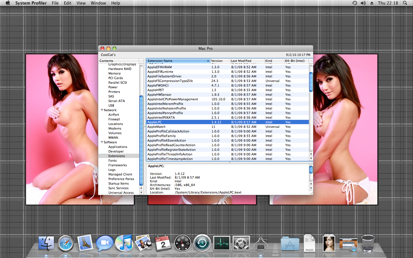

iRipper Posted September 2, 2010 Share Posted September 2, 2010 Still KP. System boots faster though With MaLd0n's DSDT only AppleLPC is loaded. Apple HPET is not. Link to comment Share on other sites More sharing options...
