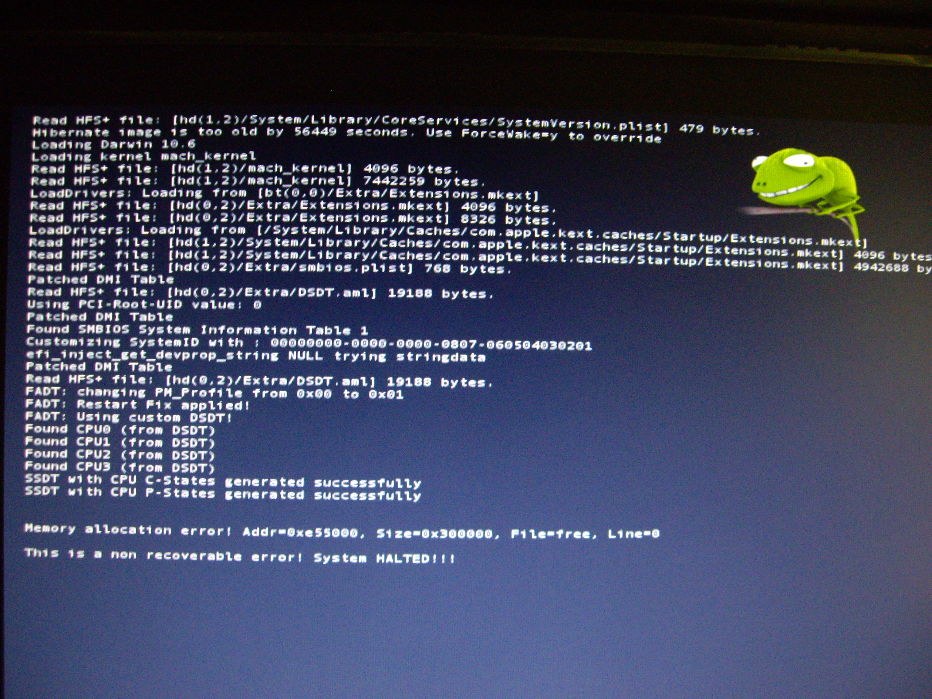

scrax Posted July 23, 2010 Share Posted July 23, 2010 try to use "Wait"="Yes" option in boot.plist to check chameleon log. I need some debug information from it. Maybe SSDT patcher didn't found CPUs in DSDT. Where is knowing bug in CPU name detection algo. I'll fix it later. Hi, I've made some test with revision 352 but it gives me memory allocation error with DropSSDT,EnablePStates and EnableCStates all set to "Yes" CPU DSDT code: Scope (_PR) { Processor (CPU0, 0x00, 0x00000810, 0x06) {} Processor (CPU1, 0x01, 0x00000810, 0x06) {} Processor (CPU2, 0x02, 0x00000810, 0x06) {} Processor (CPU3, 0x03, 0x00000810, 0x06) {} } c.a.B.p code: [size=1]<?xml version="1.0" encoding="UTF-8"?> <!DOCTYPE plist PUBLIC "-//Apple//DTD PLIST 1.0//EN" "http://www.apple.com/DTDs/PropertyList-1.0.dtd"> <plist version="1.0"> <dict> <key>Boot Banner</key> <string>Yes</string> <key>Graphics Mode</key> <string>1920x1080x32</string> <key>GraphicsEnabler</key> <string>No</string> <key>DropSSDT</key> <string>Yes</string> <key>GeneratePStates</key> <string>Yes</string> <key>GenerateCStates</key> <string>Yes</string> <key>Instant Menu</key> <string>Yes</string> <key>Kernel</key> <string>mach_kernel</string> <key>Kernel Flags</key> <string>arch=i386</string> <key>Quiet Boot</key> <string>No</string> <key>SystemType</key> <string>1</string> <key>Theme</key> <string>Default</string> <key>Timeout</key> <string>0</string> <key>Wait</key> <string>No</string> <key>device-properties</key> <string></string> </dict> </plist>[/size] memory allocation error: If I use C-State in DSDT and so I put EnableCStates=No in c.a.B.p i can boot up, but no speedstep (like with the value injected in DSDT). Please note that i'm using Zotac GF9300 WIFI ITX, with a q9300 overclocked @2.62 The only way I can have speedstep with this configuration is with P-StateChanger (i've not tested with VoodooPowerMini yet) With DSDTSE I can see the 4 ssdt table attached here: SSDT.zip My q9300 was seen as Xeon before the upgrade, now it's unknown Like snackole i've just compiled it with "make clean; make" and changed the boot in root, boot1h and boot0 are from ANVAL bootloader. Now I'll test with the 204 on the official Chameleon repo. mem detection not tested ( my ddr2 was not recognized on the last version Rekursor released some time ago) Link to comment https://www.insanelymac.com/forum/topic/225766-chameleon-rc5-mode-with-mem-detection-enabled-and-automatic-p-states-c-states-generation-for-native-power-managment/page/3/#findComment-1516751 Share on other sites More sharing options...

scrax Posted July 23, 2010 Share Posted July 23, 2010 EDIT: As reported in another topic, it works but with an old dsdt i was using, not with my last one. CPU recognized as Quad core Xeon as expected... Solved the problem with the DSDT not working. It was Scope (_PR) section that need to be at the beginning of the dsdt not at line 300 like oit was in my dsdt. I've not tried the modded mem detection from rek (nice to see you back again on this) because in 204 it's still not working for me. My ram are 2x2GB TeamElite DDR2 800Mhz on the zotac gf9300 wifi itx Link to comment https://www.insanelymac.com/forum/topic/225766-chameleon-rc5-mode-with-mem-detection-enabled-and-automatic-p-states-c-states-generation-for-native-power-managment/page/3/#findComment-1517106 Share on other sites More sharing options...
