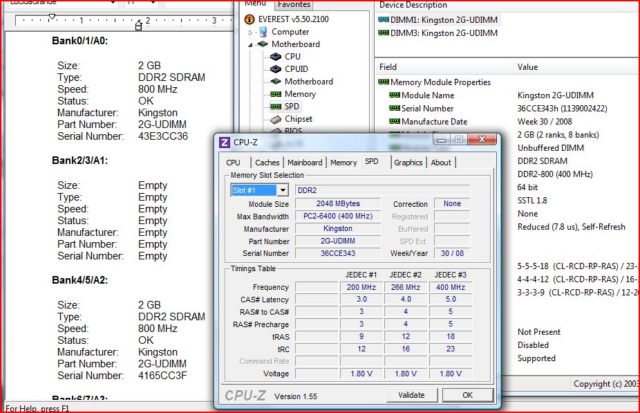

scrax Posted July 24, 2010 Share Posted July 24, 2010 The new version (download in the first post) resolves issue with improper ACPI CPU name detection causing not working C-States and/or P-States in some cases. It's the problem I was having with the Scope (_PR) at line 300, isn't it?, I can confirm that now it works without moving it at the top of the DSDT! thank you mozodojo! now that speedStep is working good i'll post my memory recognition problems: Slot memoria: ECC: Disabilitato Bank0/1/A0: Dimensioni: 2 GB Tipo: DDR2 SDRAM Velocità: 800 MHz Stato: OK Produttore: N/A Codice prodotto: N/A Numero di serie: N/A Bank2/3/A1: Dimensioni: 2 GB Tipo: DDR2 SDRAM Velocità: 800 MHz Stato: OK Produttore: N/A Codice prodotto: N/A Numero di serie: N/A this is what i get from rev204 now i'll test rev218 and report back if there are any differences. Link to comment Share on other sites More sharing options...

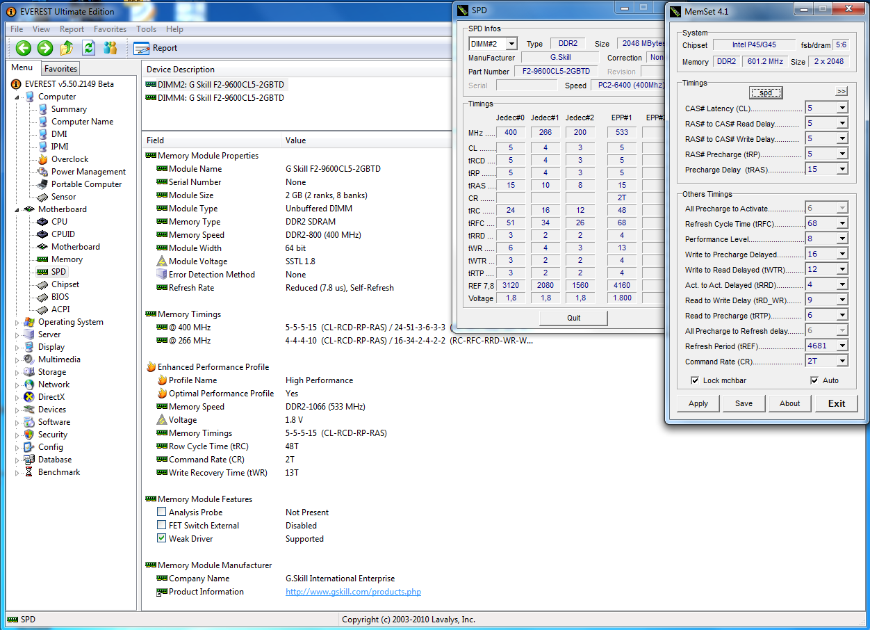

mm67 Posted July 24, 2010 Share Posted July 24, 2010 These memory sticks seem to have incorrect SPD information since all Windows programs also see them PC2-6400 sticks. Here for example Everest and Memset: I guess the real speed would have to be read from somewhere else: Link to comment Share on other sites More sharing options...
VCH888 Posted July 24, 2010 Share Posted July 24, 2010 I have G Skill Intl (F2-8500CL5-2GBPK) 2 x 2 GB DDR2 @ 1066 MHz that have SPD Ext/EPP and get report @ 800 MHz. I look at source code it will get info from SPD, not from EPP. I hope rekursor and mozodojo can solve this problem. You can learn about ram at http://en.wikipedia.org/wiki/Serial_presence_detect. Link to comment Share on other sites More sharing options...
mm67 Posted July 24, 2010 Share Posted July 24, 2010 In my case even reading EPP wouldn't help since that profile is for only 1066 MHz. There is a Windows program called spdtool, with that it's possible to change SPD information and set serial number for example. Maybe I'll try that with some old cheaper sticks. Link to comment Share on other sites More sharing options...
