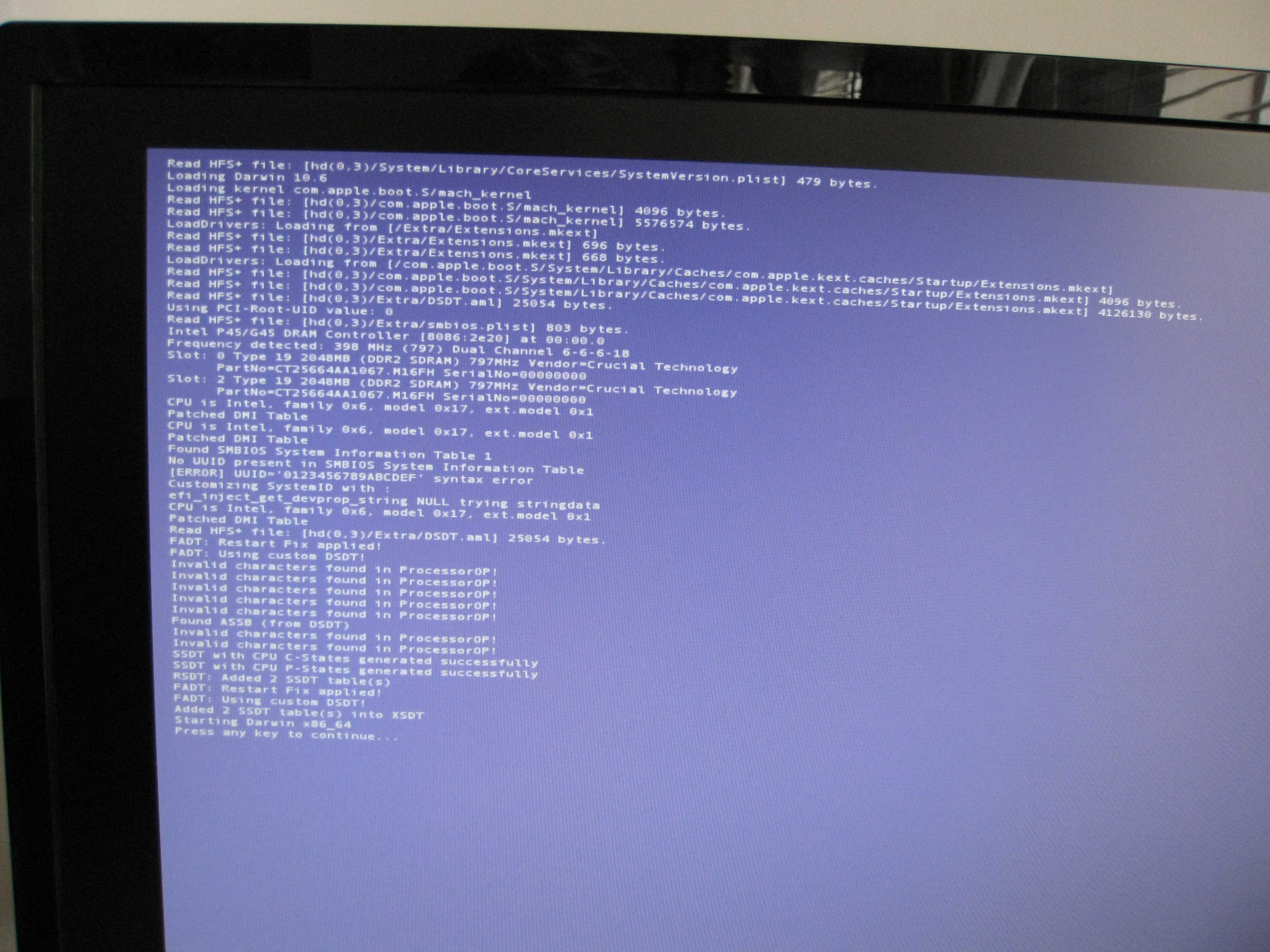

FKA Posted July 25, 2010 Share Posted July 25, 2010 FormerlyKnownAs, you are using older loader version. The problem is fixed already. No using boot_8 Actually just sorted it. I think my problem is that Everest is clipping the start of the DSDT binary code when extracting. Just added this bact to the top of my DSDT (in red.) and all works well { [color="#ff0000"]Scope (_PR) { Processor (P001, 0x01, 0x00000410, 0x06) {} Processor (P002, 0x02, 0x00000000, 0x00) {} Processor (P003, 0x03, 0x00000000, 0x00) {} Processor (P004, 0x04, 0x00000000, 0x00) {} } [/color] Name (SP1O, 0x4E) Name (IO3B, 0x0290) Name (IO3L, 0x10) Name (IOCE, 0x87) Name (IOCL, 0xAA) Name (PEBS, 0xE0000000) Name (PEBL, 0x10000000) Name (SRCB, 0xFED1C000) Name (SRCL, 0x4000) Name ( As previously said my pstates work native but I've noticed if I use GeneratePStates=Yes I get much lower temps! Now just to sort my UUID error. This EFI BIOS seems much smoother than the standard AMI. Huge thank you mojodojo and rekursor D Link to comment https://www.insanelymac.com/forum/topic/225766-chameleon-rc5-mode-with-mem-detection-enabled-and-automatic-p-states-c-states-generation-for-native-power-managment/page/7/#findComment-1518502 Share on other sites More sharing options...
