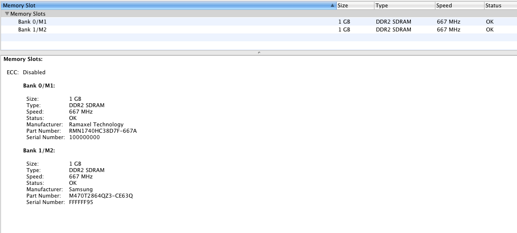

This is normal, because there is no serial number available by the spd memory,
so in that case we generate one ...
It doesn't matter what number it contains in that case.
-Rek

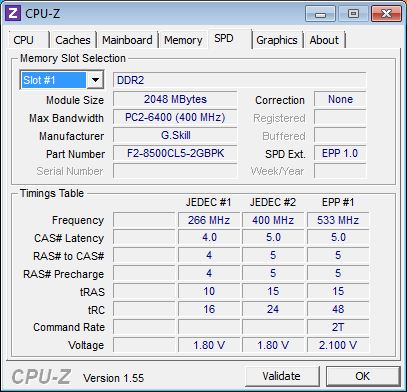

Devices: 945GCM-S2L, DDR2 667 MHz 2 x 1 GB
I could see mem detection at booting correctly but mem report in System Profiler was wrong.
updated @ 21.01
Devices:EP45-UD3R, G.Skill DDR2 1066 MHz 2 x 2 GB
rekusor's boot
AsereBLN's boot
from CPU-Z

Thank you very much for fixing mem report.
Bank0/1/A0:
 Type:	DDR2 SDRAM
 Speed:	667 MHz
 Status:	OK
 Manufacturer:	Kingston
 Part Number:	9905316-005.A04LF
 Serial Number:	FFFFFF94
Bank2/3/A1:
 Type:	DDR2 SDRAM
 Speed:	667 MHz
 Status:	OK
 Serial Number:	FFFFFF8E
I will report EP45-UD3R & DDR2 1066 MHz 2 x 2 GB later.

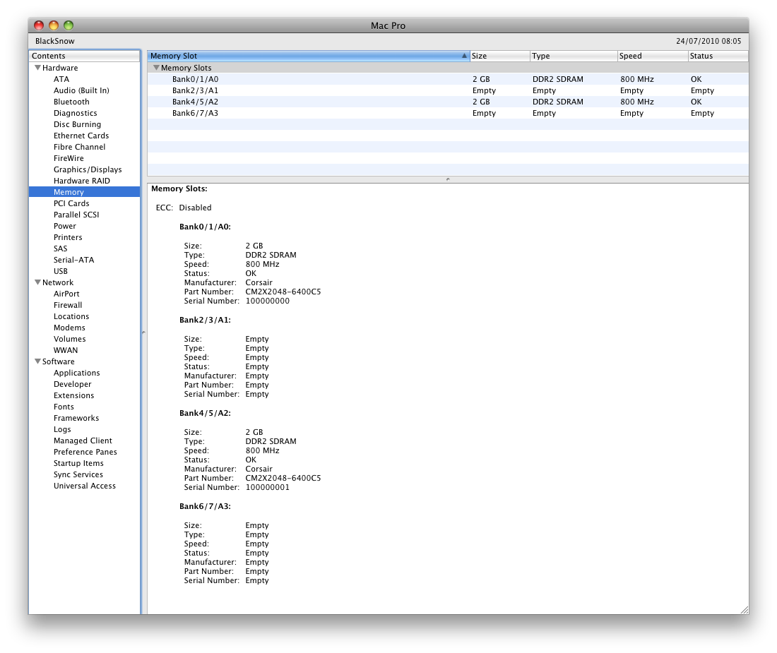

Hi Rekursor
I've just got round to trying out your revised boot files and here's my report from using boot_3.zip (r210).
Result
• The GUI appears in the blink of an eye.. So fast!.. nice :D
• Your memory detection had previously worked for my system as far as showing me Size, Type, Speed and Status. But now I have Manufacturer and Part Number too :D
My serial number still shows as blank, but it did with Asere's loader too and back when I was testing that Asere said to me the reason was because he's 99% sure the serial number is missing from the SPD.
So for me, your revisions are perfect. Well done :)
For reference my memory is: Corsair 4GB (2x2GB) DDR2 800MHz/PC2-6400 XMS2 CL5 1.8v
I have attached a screenshot of SystemProfiler.

Also for me. Speed still wrong too. Should be 900 MHz in oc. It's 800. Not a big problem but...
Unfortunately, the OC speed can't be fixed with latest changes because it needs special (new) code addon to read the oc speed directly from the memory controller ...
