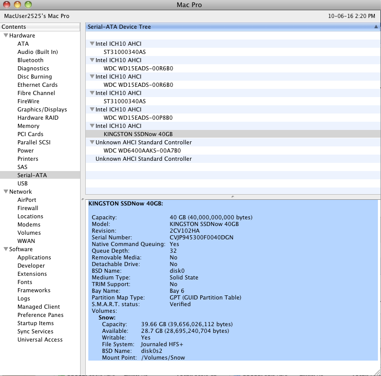

MacUser2525 Posted June 16, 2010 Share Posted June 16, 2010 I guess trim function for ssd's is coming. In my macbook 13'' the sustem identifies my intel ssd as solid state now.In my hackintosh however it identifies it as rotational drive. See the photos I get Solid State on my hackintosh after the update. Link to comment https://www.insanelymac.com/forum/topic/221273-released-update-to-1064/page/4/#findComment-1490912 Share on other sites More sharing options...

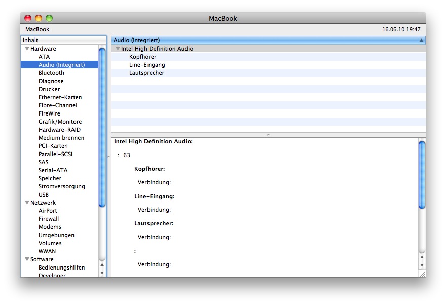

Acid_Burn Posted June 16, 2010 Share Posted June 16, 2010 After Update to 10.6.4 i have a Error in System Profiler "Audio" on HacMac AND orig. MacBook! See my Screenshot. Many User have the same Error! Link to comment https://www.insanelymac.com/forum/topic/221273-released-update-to-1064/page/4/#findComment-1491078 Share on other sites More sharing options...
