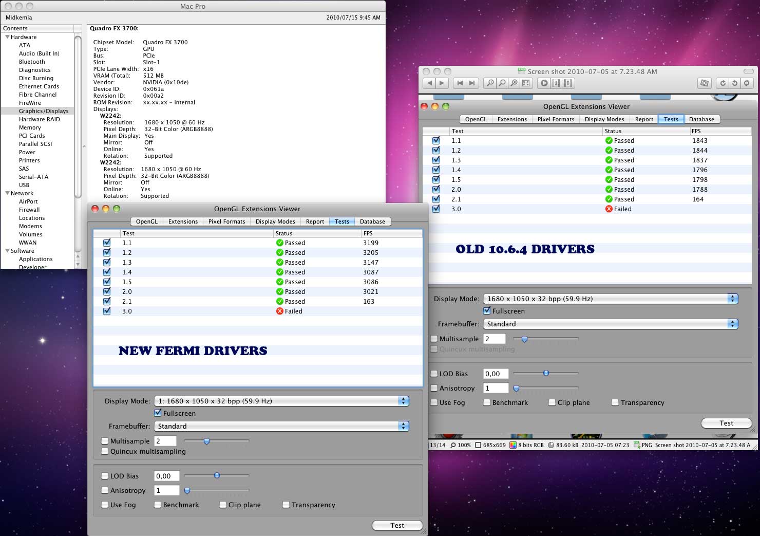

macwanabe Posted July 15, 2010 Share Posted July 15, 2010 Hi A friend of mine is bringing me a Galaxy GTX 460 OC 1GIG from Hong Kong, she bought it yesterday. Will have it the 24th then we can do the testing. Price was US $220. I installed the new drivers from the first post and see a dramatic speed increase in the OpenGL extension Viewer benchmark. I flashed my 8800Gt to a Quadro FX 3700. And looking at the first post its more than 3 times faster than GTX 480 with current drivers. Link to comment https://www.insanelymac.com/forum/topic/214219-fermigtx-480gtx-470/page/10/#findComment-1511426 Share on other sites More sharing options...
