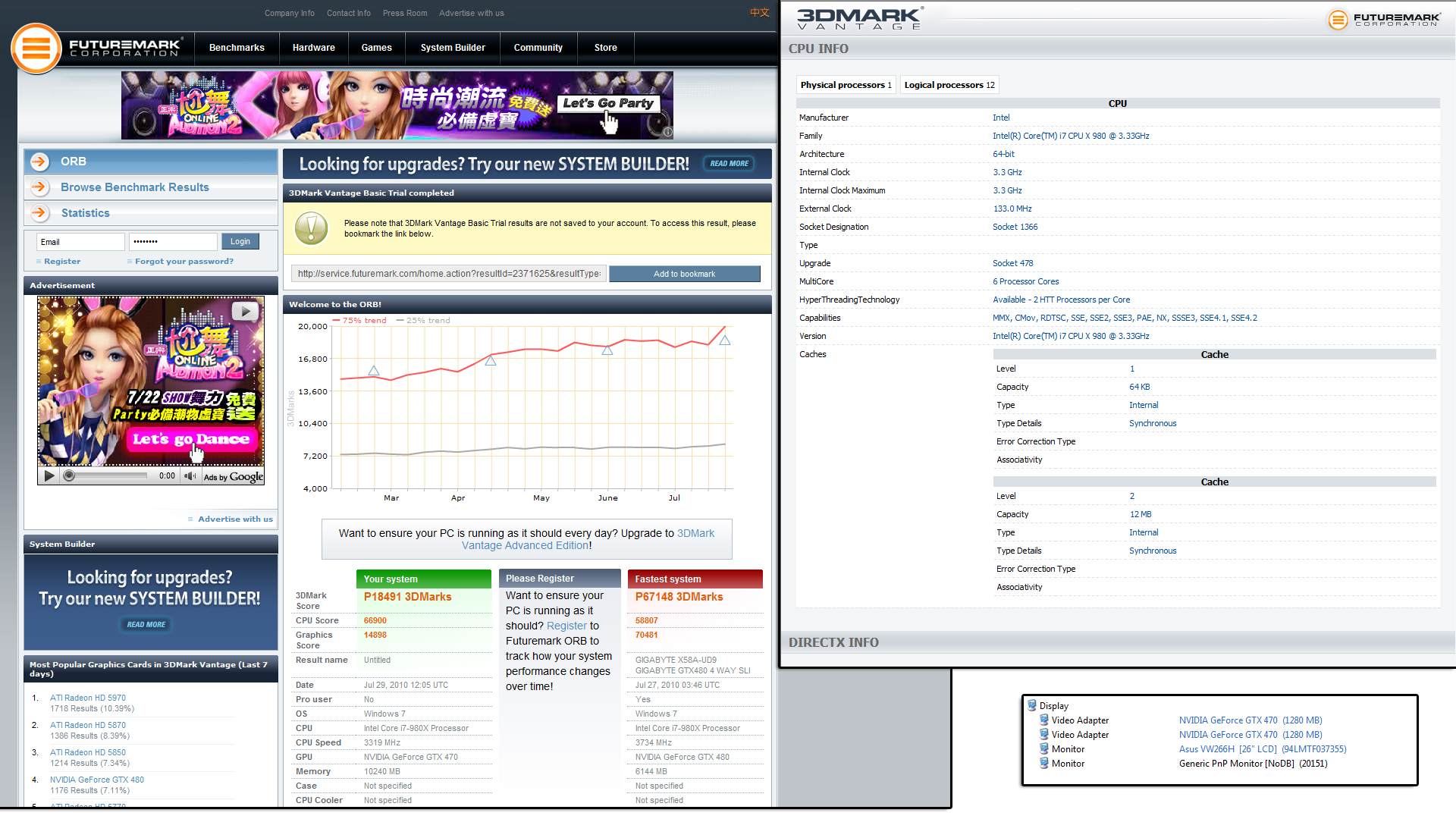

rabbit74 Posted July 29, 2010 Share Posted July 29, 2010 Here is some additional info about my GTX-465 flashed to 470 Mostly finished testing now. Tried a couple different ROMs and it seems to be operating best with the MSi Twin Frozr GTX-470 ROM. Performance in OSX is pretty lousy. Cinebench is giving it 23 f/s, actually coming in quite a bit lower than my GTX-260. And the card is running pretty hot. I tested it under win7-64 for comparison, same card, same MSi ROM. Runs cooler in Win as I can adjust the fan speed. CineBench in win gives it 43 f/s, pretty serious difference. I also get occasional video scaling in OSX. Not something I want to see at all from such an expensive card. I am assuming the massive difference between the two operating environments is because the drivers we are using are actually for the 285,295 GTX as nVidia has still not released OSX drivers for any 4xx cards yet. My final judgment is to stick with GTX-260, 285, 295 for now. The GTX-460 does not work at all in OSX so if you are looking for a recommendation, I am saying better to wait for better driver support from nVidia. Bang for your buck, the best card in my mind is the GTX-260. Unfortunately it has been discontinued. If you can, grab one while stores still have them in stock. Here is a sample video of the video scaling Does anybody have an actual GTX-470, (unmodified) and can post a cinebench score for OSX for comparison? rabbit Link to comment https://www.insanelymac.com/forum/topic/214219-fermigtx-480gtx-470/page/15/#findComment-1520971 Share on other sites More sharing options...
Pink Waters Posted July 29, 2010 Share Posted July 29, 2010 I am assuming the massive difference between the two operating environments is because the drivers we are using are actually for the 285,295 GTX as nVidia has still not released OSX drivers for any 4xx cards yet. Hi rabbit, How 2xx drivers are driving 4xx ?! with QE and all ? these drivers should at least have some 4xx support, so thats why the cards are partially working now. however, If these drivers do not contain any 4xx support as you claim, with the new mac refreshes which come with only ATIs, I doubt there would be any support for 4xx in the future! Link to comment https://www.insanelymac.com/forum/topic/214219-fermigtx-480gtx-470/page/15/#findComment-1520974 Share on other sites More sharing options...
rabbit74 Posted July 29, 2010 Share Posted July 29, 2010 Hi rabbit, How 2xx drivers are driving 4xx ?! with QE and all ? these drivers should at least have some 4xx support, so thats why the cards are partially working now. however, If these drivers do not contain any 4xx support as you claim, with the new mac refreshes which come with only ATIs, I doubt there would be any support for 4xx in the future! Let us hope that changes. r. Link to comment https://www.insanelymac.com/forum/topic/214219-fermigtx-480gtx-470/page/15/#findComment-1520978 Share on other sites More sharing options...

warjack Posted July 29, 2010 Share Posted July 29, 2010 @rabbit74: Did you have any problems with your card when you used Windows 7? Does it run correctly, especially if you play some games? How much memory has your GTX465? 1024MB or 1280MB? I'm asking because I'm a litte bit afraid that my eVGA GTX465 won't run correctly under Windows if I flash it with a GTX470 ROM. Link to comment https://www.insanelymac.com/forum/topic/214219-fermigtx-480gtx-470/page/15/#findComment-1520998 Share on other sites More sharing options...
rabbit74 Posted July 29, 2010 Share Posted July 29, 2010 @rabbit74: Did you have any problems with your card when you used Windows 7? Does it run correctly, especially if you play some games? How much memory has your GTX465? 1024MB or 1280MB? I'm asking because I'm a litte bit afraid that my eVGA GTX465 won't run correctly under Windows if I flash it with a GTX470 ROM. Sorry. I am not a gamer. I only used benching tools to test it. So, I really can't give you a solid answer to your question. System is showing the card has 1280MB. r. Link to comment https://www.insanelymac.com/forum/topic/214219-fermigtx-480gtx-470/page/15/#findComment-1520999 Share on other sites More sharing options...
warjack Posted July 29, 2010 Share Posted July 29, 2010 Sorry. I am not a gamer. I only used benching tools to test it. So, I really can't give you a solid answer to your question. System is showing the card has 1280MB. r. Ok, thanks for the fast answer. What benchtools did you use? If the card was fully load with them that would be a good sign that its working probably. Had you tried to get your untouched GTX465 working with OS X or had you flashed the ROM immediately? I hope I can get it working but have to wait for the parcel service. Link to comment https://www.insanelymac.com/forum/topic/214219-fermigtx-480gtx-470/page/15/#findComment-1521003 Share on other sites More sharing options...
rabbit74 Posted July 29, 2010 Share Posted July 29, 2010 Ok, thanks for the fast answer. What benchtools did you use? If the card was fully load with them that would be a good sign that its working probably. Had you tried to get your untouched GTX465 working with OS X or had you flashed the ROM immediately? I hope I can get it working but have to wait for the parcel service. I only tested it as 470. To be honest I am a Linux and Mac guy. I have win7-64 for testing purposes only and am pretty useless in the windoz environment. I tested it with geekbench, CineBench, and FutureMark. FutureMark seems to be the real test. It ran the test flawlessly and the scores are attached. The GPU got up to 74c though during the test. normally at 50-55c I hope that helps. r. Link to comment https://www.insanelymac.com/forum/topic/214219-fermigtx-480gtx-470/page/15/#findComment-1521038 Share on other sites More sharing options...
