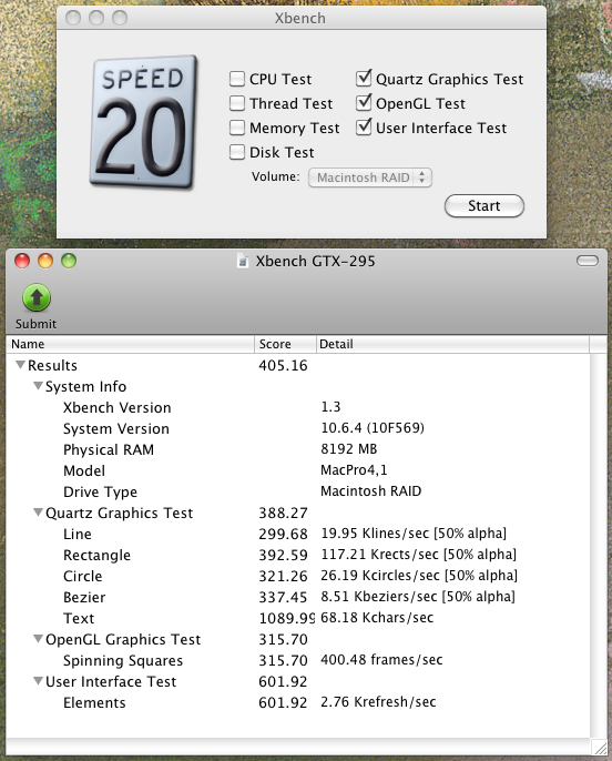

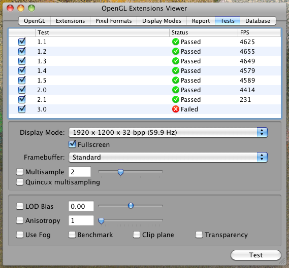

meroy Posted July 2, 2010 Share Posted July 2, 2010 -- Snow Leopard 10.6.4 Here are the results for the OpenGL Extension Viewer / Xbench running on a GTX 295 Single-PCB edition at 684/1512/1180 MHz. I'm posting this here so folks can compare with the next driver update suited for GTX 470/480. I too am interested in the new GTX 470/480 Fermi architecture and will come back to this thread when the drivers are updated to fully support Fermi. Only one GPU is used during testing for the results provided below. -- Benchmark 1920x1200x32 1.1 2250 FPS 1.2 3371 FPS 1.3 2837 FPS 1.4 2272 FPS 1.5 2286 FPS 2.0 1580 FPS 2.1 203 FPS -- Single Cube 1920x1200x32 1.1 4625 FPS 1.2 4655 FPS 1.3 4649 FPS 1.4 4579 FPS 1.5 4589 FPS 2.0 4414 FPS 2.1 231 FPS -- Xbench Quartz Graphics Test: 388.27 OpenGL Graphics Test: 315.70 User Interface Test: 601.92 CUDA 3.1 now allows one to specify the GPU devices to use via the CUDA_VISIBLE_DEVICES environment variable. I have mine set to 1. This allows a better balanced system for me. The user interface (OpenGL) will run on device 0 and remain fluid and fast. CUDA apps will run on device 1. This allows both GPUs on the GTX 295 to be utilized by OS X. I like this feature so very much. In addition, I added to /S/L/E/AppleGraphicsPowerManagement.kext/Contents/Info.plist. The entry is added below MacPro4,1. ... <key>MacPro4,1</key> <dict> [color="#0000FF"] <key>Vendor10deDevice05eb</key> <dict> <key>Heuristic</key> <dict> <key>ID</key> <integer>0</integer> <key>IdleInterval</key> <integer>250</integer> <key>SensorOption</key> <integer>1</integer> <key>SensorSampleRate</key> <integer>4</integer> <key>TargetCount</key> <integer>5</integer> <key>Threshold_High</key> <array> <integer>87</integer> <integer>87</integer> <integer>87</integer> <integer>100</integer> </array> <key>Threshold_Low</key> <array> <integer>0</integer> <integer>87</integer> <integer>87</integer> <integer>87</integer> </array> </dict> <key>LogControl</key> <integer>0</integer> <key>control-id</key> <integer>18</integer> </dict>[/color] <key>Vendor10deDevice05e2</key> <dict> ... The results for SmallLuxGPU (OpenCL) are posted here: http://www.insanelymac.com/forum/index.php...p;#entry1499698 Link to comment https://www.insanelymac.com/forum/topic/214219-fermigtx-480gtx-470/page/8/#findComment-1502879 Share on other sites More sharing options...
