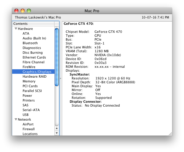

voll@ Posted July 16, 2010 Share Posted July 16, 2010 Manli GF GTX470 - work 1. 10.6.4 2.nvidia 19.5.8f03 3. NVDAGF100Hal.kext 4 add DSDT Device (PEGP) { Name (_ADR, 0x00030000) Name (_PRW, Package (0x02) { 0x09, 0x05 }) Device (GFX0) { Name (_ADR, Zero) Method (_DSM, 4, NotSerialized) { Store (Package (0x18) { "AAPL,slot-name", "PCI-E x16", "@0,compatible", Buffer (0x0B) { "NVDA,NVMac" }, "@0,device_type", Buffer (0x08) { "display" }, "@0,name", Buffer (0x0F) { "NVDA,Display-A" }, "@1,compatible", Buffer (0x0B) { "NVDA,NVMac" }, "@1,device_type", Buffer (0x08) { "display" }, "@1,name", Buffer (0x0F) { "NVDA,Display-B" }, "NVCAP", Buffer (0x18) { /* 0000 */ 0x04, 0x00, 0x00, 0x00, 0x00, 0x00, 0x03, 0x00, /* 0008 */ 0x00, 0x00, 0x00, 0x00, 0x00, 0x00, 0x00, 0x07, /* 0010 */ 0x00, 0x00, 0x00, 0x00 }, "VRAM,totalsize", Buffer (0x04) { 0x00, 0x00, 0x00, 0x50 }, "device_type", Buffer (0x0D) { "NVDA,GeForce" }, "model", Buffer (0x17) { "NVIDIA GeForce GTX 470" }, "rom-revision", Buffer (0x2B) { "nVidia GeForce GTX 470 OpenGL Engine [EFI]" } }, Local0) DTGP (Arg0, Arg1, Arg2, Arg3, RefOf (Local0)) Return (Local0) } } Link to comment https://www.insanelymac.com/forum/topic/214219-fermigtx-480gtx-470/page/11/#findComment-1512197 Share on other sites More sharing options...

rabbit74 Posted July 16, 2010 Share Posted July 16, 2010 Almost there. Got all the kexts, Device iDs and Chameleon installed. But still can only boot to low graphics mode. I think my Device ID might differ. I have the Gigabyte GTX-460, 768MB and in profiler I see a slightly different device id Display: Type: GPU Bus: PCIe PCIe Lane Width: x16 VRAM (Total): 64 MB Vendor: NVIDIA (0x10de) Device ID: 0x0e22 Revision ID: 0x00a1 I attached my iOReg info. If someone knows how to check the device id string and could let me know how it's done or where to find more info on finding the device id I would really appreciate it. currently using device id string: "0x06c010de&0xffe0ffff" for the GTX-460 1G rabbit. Gigabyte_GTX_460_768.GDDR5.ioReg.info.zip Link to comment https://www.insanelymac.com/forum/topic/214219-fermigtx-480gtx-470/page/11/#findComment-1512420 Share on other sites More sharing options...
VCH888 Posted July 16, 2010 Share Posted July 16, 2010 Almost there. Got all the kexts, Device iDs and Chameleon installed. But still can only boot to low graphics mode. I think my Device ID might differ. I have the Gigabyte GTX-460, 768MB and in profiler I see a slightly different device id Display: Type: GPU Bus: PCIe PCIe Lane Width: x16 VRAM (Total): 64 MB Vendor: NVIDIA (0x10de) Device ID: 0x0e22 Revision ID: 0x00a1 I attached my iOReg info. If someone knows how to check the device id string and could let me know how it's done or where to find more info on finding the device id I would really appreciate it. currently using device id string: "0x06c010de&0xffe0ffff" for the GTX-460 1G rabbit. try to add 0x0e2210de Go to 1st post. Link to comment https://www.insanelymac.com/forum/topic/214219-fermigtx-480gtx-470/page/11/#findComment-1512436 Share on other sites More sharing options...
