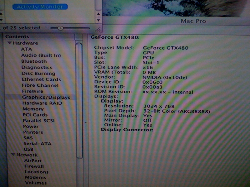

lkelly2006 Posted April 20, 2010 Share Posted April 20, 2010 Possible progress!! I manually installed three packages inside an apple update, http://www.apple.com/downloads/macosx/driv...evgagtx285.html, and set graphicsenabler=yes: I apologize for the screenshot, had to use iPhone as OSX won't allow me: As you can see System Profiler recgonizes the name of the Nvidia GTX 480 but no properties such as ram and features such as OpenCL/Quartz Extreme. Any thoughts? Link to comment https://www.insanelymac.com/forum/topic/214219-fermigtx-480gtx-470/#findComment-1452112 Share on other sites More sharing options...
