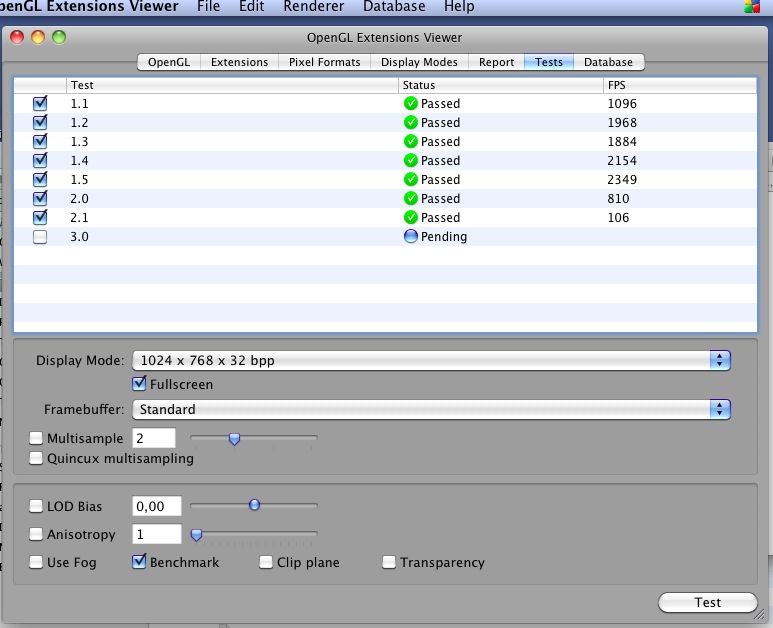

mitch_de Posted June 21, 2010 Share Posted June 21, 2010 PS:Where can I find the bench for OpenCL? Here http://www.macupdate.com/info.php/id/33632/smallluxgpu There is also an console tab in the tool if the tool didnt crash but gives no results. To get known if OpenGL runs well (no game needed) the best tool is OpenGLExtensionsViewer. Run the tests , if they are very low, you dont have OpenGL and the CPU does the work as Softwarerenderer. http://www.macupdate.com/info.php/id/17087...tensions-viewer Screenshoot shows 8800GTX in benchmark mode (activate that). Link to comment https://www.insanelymac.com/forum/topic/214219-fermigtx-480gtx-470/page/5/#findComment-1495174 Share on other sites More sharing options...

mitch_de Posted June 21, 2010 Share Posted June 21, 2010 Be carefull with "OpenGL working" without an real test (like OpenGLExtensionviewer, Cinema4DBench,...or even older(bad) XBench OpenGL). Some OpenGL Apps (like GoogleEarth , others) may not fail if OpenGL drivers not work - they use automaticly Apple Software OpenGL Renderer (CPU only work!) insted - perhaps without you see that HW OpenGL doesnt work really. I also had such OH?! when i had an bad Nvidia driver installed (was my fault ). OpenGL worked! - but extreme slow because Apple Software Renderer and NOT GPU! The faster the cpu the more you dont "feel" that slowness in first sight. I attached my XBench 8800GTX, C2D CPU, Quartz, OpenGL, UI values - (XBench OpenGL is overaged bench - better use much modern OpenGLExensionsViewer Test as bench, but may helpful to see if it works!) If Fermi is much slower in that tasks QE/OpenGL is not working really. Link to comment https://www.insanelymac.com/forum/topic/214219-fermigtx-480gtx-470/page/5/#findComment-1495235 Share on other sites More sharing options...

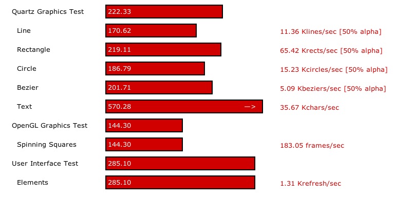

mitch_de Posted June 22, 2010 Share Posted June 22, 2010 I am a bit confused that a lot reports "working" here but no one does report if OpenGL Benches / OpenGL Tools + Apps + Games are working to and how fast. Sure, the full speed of new Fermi need lots of fermi specific opti but it would be helpfull what REALLY works and what not. So please take a few minutes to check OpenGL with OpenGLExtensionsviewer Bench / XBENCH or smallluxgpu, or any other OpenGL App. THANKS Link to comment https://www.insanelymac.com/forum/topic/214219-fermigtx-480gtx-470/page/5/#findComment-1495993 Share on other sites More sharing options...

cmf Posted June 22, 2010 Author Share Posted June 22, 2010 I am a bit confused that a lot reports "working" here but no one does report if OpenGL Benches / OpenGL Tools + Apps + Games are working to and how fast. first post, second screen. what did i do wrong? Could someone maybe upload the kext files in the way there should be?I really tried everything I could imagine... and read this thread a thousand times.... argh! 0x06c010de&0xfff0ffff should actually work fine, because of the (& 0xfff0ffff) this applies to all devices from 0x06c010de to 0x06cf10de. dunno what else you could have done wrong. you did clear your cache though? side note: i noticed the vsync issue on my mbp too, so not a fermi driver problem, but a general nvidia driver problem ... Link to comment https://www.insanelymac.com/forum/topic/214219-fermigtx-480gtx-470/page/5/#findComment-1496176 Share on other sites More sharing options...

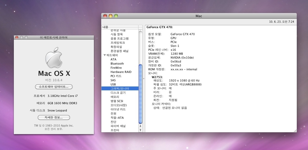

Bbongkkumi Posted June 22, 2010 Share Posted June 22, 2010 I used.. EVGA GTX 470. Work fine... First.. 10.6.4 update. 1. Installed the aserebln_fermi bootloader 2. Real Mac Nvidia Driver install ( Kext -> kexthelper ) 3. Added to the NVDAGF100Hal.kext & NVDAResman.kext the following ID: 0x06cd010de&0xfff0ffff (I have the 470) 4. Reboot If HDMI use... NVCAP use.. Boot options. Link to comment https://www.insanelymac.com/forum/topic/214219-fermigtx-480gtx-470/page/5/#findComment-1496190 Share on other sites More sharing options...

hellboy Posted June 23, 2010 Share Posted June 23, 2010 I used.. EVGA GTX 470.Work fine... First.. 10.6.4 update. 1. Installed the aserebln_fermi bootloader 2. Real Mac Nvidia Driver install ( Kext -> kexthelper ) 3. Added to the NVDAGF100Hal.kext & NVDAResman.kext the following ID: 0x06cd010de&0xfff0ffff (I have the 470) 4. Reboot If HDMI use... NVCAP use.. Boot options. You don't need anymore NVDAFF100Hal.kext ans NVDAResman.kext ? Link to comment https://www.insanelymac.com/forum/topic/214219-fermigtx-480gtx-470/page/5/#findComment-1496756 Share on other sites More sharing options...
