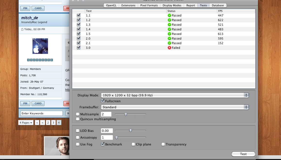

mitch_de Posted June 24, 2010 Share Posted June 24, 2010 No, my EVGA GTX 470 3D works, but, it drags in TF2 with max settings. AA kills it, which makes sense considering valve is saying 10.6.4 drivers are {censored}. Nonetheless, it does work. GREAT !!! Could you at least DL (only 2 MB!) und run the OpenGLExtensionsViewer (Test tab for bench, activate benchmark ) and post the results screen ? http://www.macupdate.com/info.php/id/17087...tensions-viewer Link to comment https://www.insanelymac.com/forum/topic/214219-fermigtx-480gtx-470/page/6/#findComment-1497521 Share on other sites More sharing options...
elitee Posted June 24, 2010 Share Posted June 24, 2010 This is with MacPro3,1 - 4,1 is about 1/4 the FPS Link to comment https://www.insanelymac.com/forum/topic/214219-fermigtx-480gtx-470/page/6/#findComment-1497532 Share on other sites More sharing options...

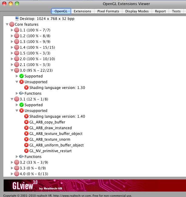

mitch_de Posted June 24, 2010 Share Posted June 24, 2010 Much tanks submitting first OpenGLExtensionsViewer Result Information: This results are very valide/reliable compared to XBench OpenGL results. The results are (like ever) dependend from resolution. Means the higher the res the less "points". The not run 3.0 Bench happens if at least one of the needed subfunctions is not available - ny HW and/or drivers. YOu can see more details for thos case in the first TAB as OpenGL 3.x (x supported / out of y) This is with MacPro3,1 - 4,1 is about 1/4 the FPS - happens if AGPM (GPU Powermanagement) NOT works ! Not working may mean: stay always at maximum GPU clk or at minimum GPU clk. The Mac ID is used in the AGPM as reference how the AGPM must be handled (beside the GPU type). Normally AGPM often not works on our hackintoshs without changing some .plist and/or using AGPM.kext injectors. But not working normally means idle mode is disabled - always runs max. clk, not minimum clk. If someone has time to check + test OpenCL (may not work, may crash) by rytracing on GPU with smallluxGPU would be very interesting. Fermi does much faster work than old 8800 and also GTX 285. Use the High / UltraHigh Benchmark mode to measure time in seconds. Also the OpenCL pixelfilter bench (does same as CoreImage but its OpenCL code) is interesting - measures MegaPixels/Sec and Nvidia is there very fast compared to ATI because faster VRAM. http://www.macupdate.com/info.php/id/33632/smallluxgpu (50 MB DL, easy to use) Attached : 8800GTX OpenGL Details of what is supported/unsuppoerted (HW and driver). Link to comment https://www.insanelymac.com/forum/topic/214219-fermigtx-480gtx-470/page/6/#findComment-1497774 Share on other sites More sharing options...
