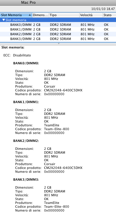

quinielascom Posted January 9, 2010 Share Posted January 9, 2010 Made a new version. Changes: FACP RestartFix enabled by default if you have an Intel CPU Jedec Memory Manufactor Code Lookup for some common vendors (OCZ, G.Skill, Crossair, GeIL, Kingston) Asere, thanks but version 1.1.2 still not show nothing ... Tested with Chipset GM960/GM965 ICH8. And the Platform ID in system profiler is wrong (checked it in Everest and BIOS) but at least with your patched boot i can inject the correct one with PlatformUUID.kext. Link to comment https://www.insanelymac.com/forum/topic/201902-chameleon-rc4-is-out/page/5/#findComment-1380659 Share on other sites More sharing options...

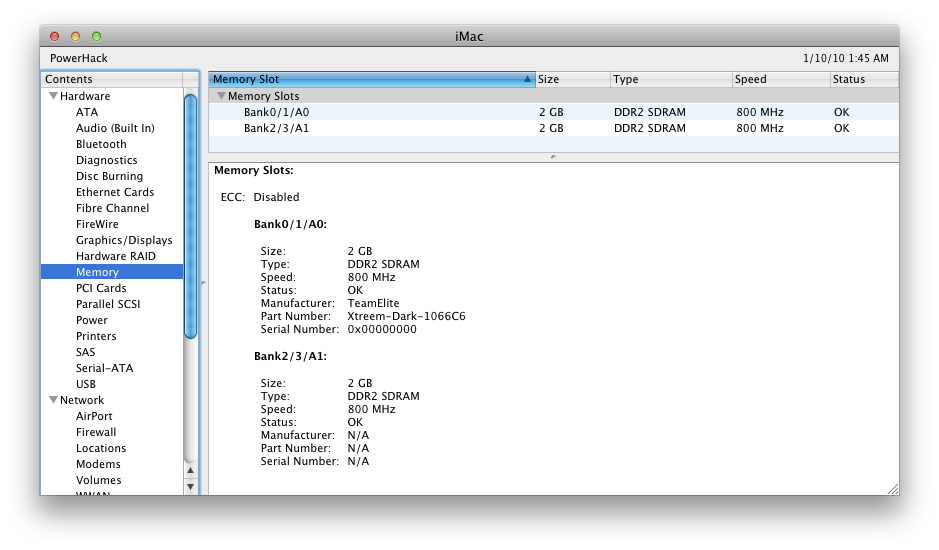

sk1nhead Posted January 9, 2010 Share Posted January 9, 2010 Added TeamElite lookup too in Version 1.1.2. Thank You, here's my memory screenshot on 112 now with detected manufacturer... - question, is the bank2 suppose to be N/A? not an issue though since even using smbios plist, i never notice nor pay attention to that until now haha.. BTW, I have noticed that after the boot0/boot1 message, I get a blinking cursor for 2 seconds then it writes a line "efi_something............" then OS X starts booting. Is there anyway to make the boot loader silent? At least hide the blinking cursor and the efi_.... message i think i saw that too (if it's the same), using the boot w/o theme and QuietBoot=Y but before the apple logo appears there's an annoying text that displays in the middle of my screen hehe.. Link to comment https://www.insanelymac.com/forum/topic/201902-chameleon-rc4-is-out/page/5/#findComment-1380731 Share on other sites More sharing options...

Asere Posted January 9, 2010 Share Posted January 9, 2010 Manufacturer: 0x7f7f7f7f7f02 Added Patriot for the next version. @Asere is that memory stuff the code from MemTest?As far I know there is a conflict in licensing... No, it's not memtest based. It's based on a phone call (mch clkcfg), the existing spd stuff and my work. Tested with Chipset GM960/GM965 ICH8. Read my first post. Your chipset still isn't supported. Until now only: P55 & P35/P45/X38/X48 + ICH10, ICH9, ICH7. Thanks Asere - works awesome Now... not that I don't love your graphic for the boot...but how do I change it back to the Chameleon? Dumbass question I know Now if I could only get rid of my last two sound assertion errors thanks again! Use a theme of your choice in Extra/Themes. Default Theme Name is "Default". For others you must configure Theme=<Name> in com.apple.Boot.plist. The logo is the file: artwork/themes/default/logo.png Link to comment https://www.insanelymac.com/forum/topic/201902-chameleon-rc4-is-out/page/5/#findComment-1380850 Share on other sites More sharing options...

Asere Posted January 9, 2010 Share Posted January 9, 2010 Hi Asere. You're right about me confusing serial with part number. Here is my debug information using version 1.1.2 (sorry for the picture quality - cell phone camera). Please try out this version. It would be very nice if you could verify different memory speeds (400, 533, 666, 800 Mhz). Configure it in the BIOS and check whether the Booter detects the correct frequency. I can't do it. Asere Thank you - One more stupid OT question - I take it it I use your "embedded Theme" booter? Cant get it to pick up any theme I put in The Booter with the embedded theme shows only the embedded theme. You cannot override it. Use the small Booter "boot" instead. boot.zip Link to comment https://www.insanelymac.com/forum/topic/201902-chameleon-rc4-is-out/page/5/#findComment-1380899 Share on other sites More sharing options...

Dr. Hurt Posted January 10, 2010 Share Posted January 10, 2010 Please try out this version. It would be very nice if you could verify different memory speeds (400, 533, 666, 800 Mhz). Configure it in the BIOS and check whether the Booter detects the correct frequency. I can't do it. Asere Memory speed detection is working fine for me, although it's not rounding up (ie. it says 666 not 667Mhz, but thats just cosmetic.) The only issue remaining for me is memory detection (or reporting) for the second slot. Also, please add Master Chief's suggestion to make the boot loader silent. Open device_inject.c and change this line: printf("efi_inject_get_devprop_string NULL trying stringdata\n");into: verbose("efi_inject_get_devprop_string NULL trying stringdata\n"); // Used to be: printf(... Thanks in advance Link to comment https://www.insanelymac.com/forum/topic/201902-chameleon-rc4-is-out/page/5/#findComment-1381302 Share on other sites More sharing options...
