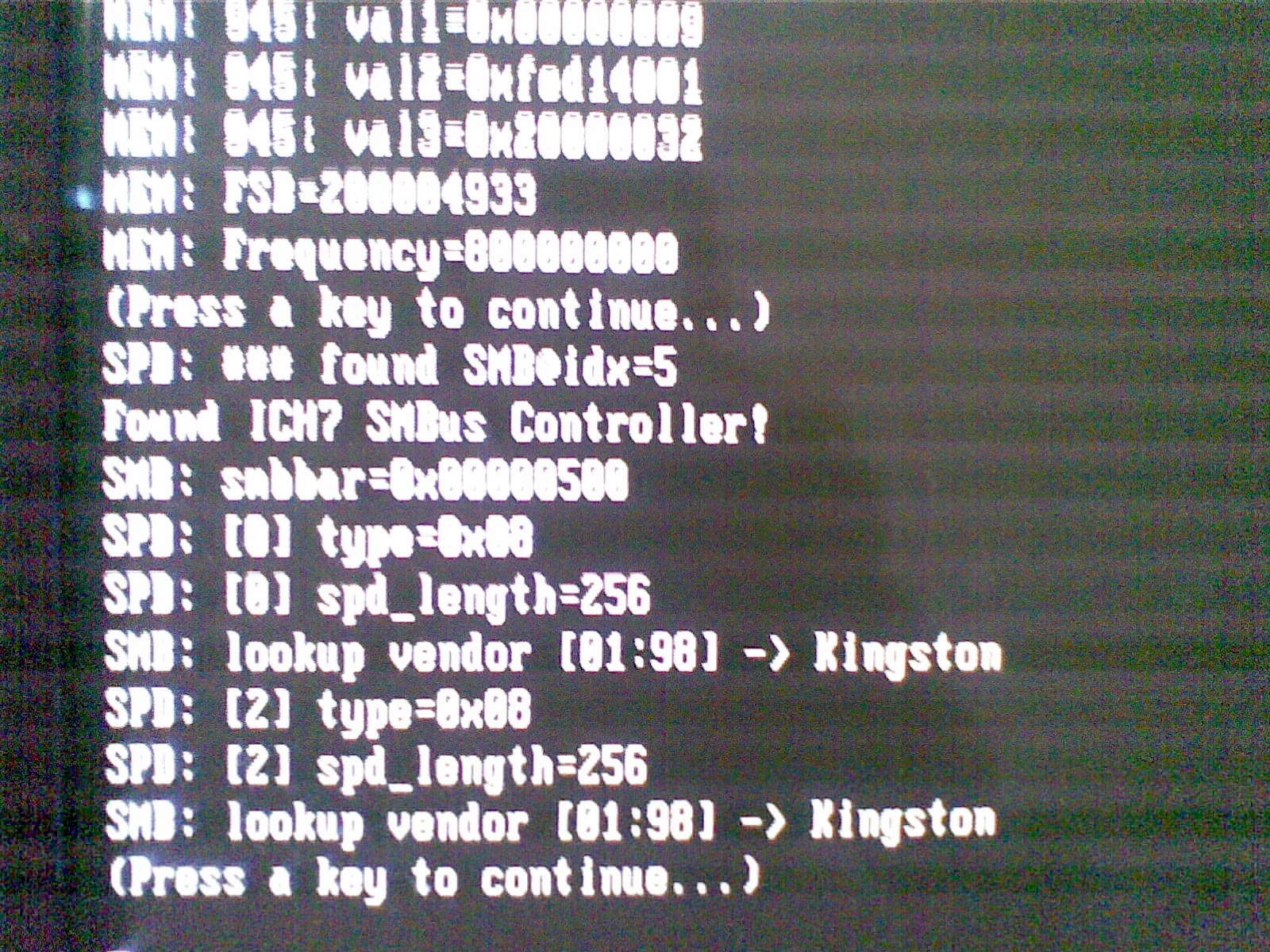

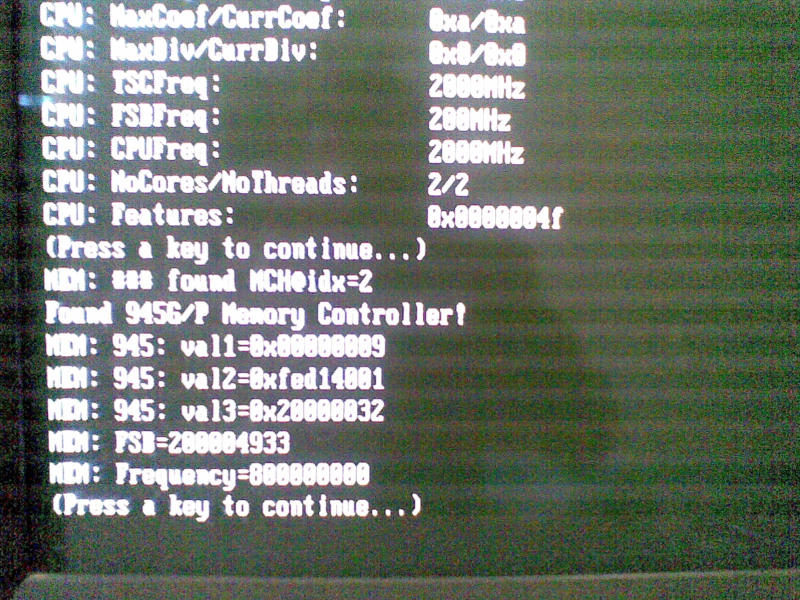

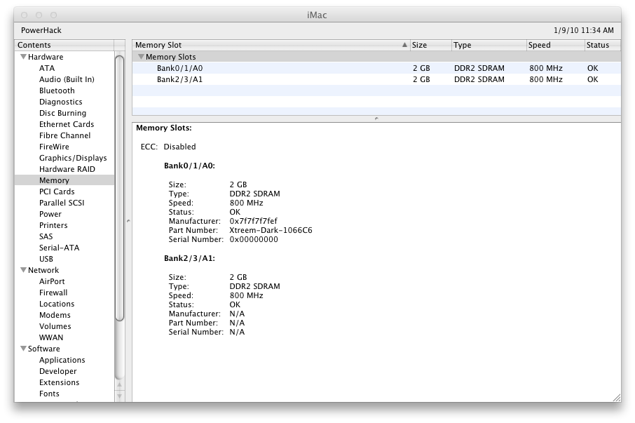

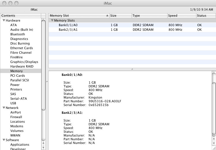

Dr. Hurt Posted January 9, 2010 Share Posted January 9, 2010 I have tried version 1.1.1 from efix forums and the results were better than before. Restart works default now, so thanks. Memory information is partly detected. Look at the screenshot below. It detects the information for one memory slot, and puts the serial number in place of the part number, and I don't know what that other number in the serial is. Or maybe I'm confusing the serial number with the part number?! Here is my SMBIOS extract before removing it. <key>SMmemmanufacter_1</key> <string>Kingston Technology</string> <key>SMmemmanufacter_2</key> <string>Kingston Technology</string> <key>SMmempart_1</key> <string>KVR800D2N6/1G</string> <key>SMmempart_2</key> <string>KVR800D2N6/1G</string> <key>SMmemserial_1</key> <string>99U5316</string> <key>SMmemserial_2</key> <string>99U5318</string> How do I enable debug mode? I'll post pics as soon as I have time because I'm at school now. Link to comment https://www.insanelymac.com/forum/topic/201902-chameleon-rc4-is-out/page/4/#findComment-1380335 Share on other sites More sharing options...

scwhar Posted January 9, 2010 Share Posted January 9, 2010 Thanks Asere, grabbed latest from here before it was pulled (account got no priveleges, can't DL, at efix). Works nicely - memory info detected: BANK1/DIMM1: Size: 2 GB Type: DDR2 SDRAM Speed: 1066 MHz Status: OK Manufacturer: OCZ Part Number: OCZ2G10662G Serial Number: 0x00000000 spot on, good job. Link to comment https://www.insanelymac.com/forum/topic/201902-chameleon-rc4-is-out/page/4/#findComment-1380518 Share on other sites More sharing options...

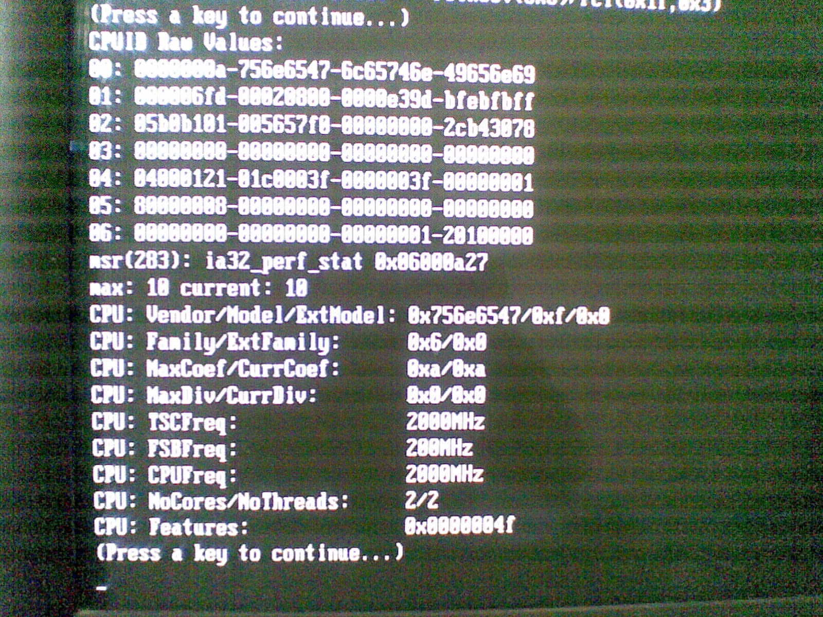

Asere Posted January 9, 2010 Share Posted January 9, 2010 hi Asere,please don't forget that all chameleon fork and modification must come with sources or diff file I've released the source, except for the memory stuff at the moment. BTW you wrote that you have fixed the cpu detection bug. Looking at your source, then it's not fixed. I will explain you why: cpuid(4) needs in ECX the cache level to query. BUT ECX is NOT initialized at all!!! Therefore is completely random whether it works or not. Only EAX is initialized. Disassemble your platform.o and you will see it. I have tried version 1.1.1 from efix forums and the results were better than before. Restart works default now, so thanks. Memory information is partly detected. Look at the screenshot below. It detects the information for one memory slot, and puts the serial number in place of the part number, and I don't know what that other number in the serial is. Or maybe I'm confusing the serial number with the part number?! How do I enable debug mode? I'll post pics as soon as I have time because I'm at school now. You're indeed confused about serial number and part number. To see the debugs, just copy boot_with_debugs to your stick and rename it to boot. here's how mine is detected Team Elite DDR2 1066 ram Added TeamElite lookup too in Version 1.1.2. Booter_AsereBLN_v1.1.2.zip AsereBLN_Booter_v1.1.2.patch.zip Link to comment https://www.insanelymac.com/forum/topic/201902-chameleon-rc4-is-out/page/4/#findComment-1380526 Share on other sites More sharing options...

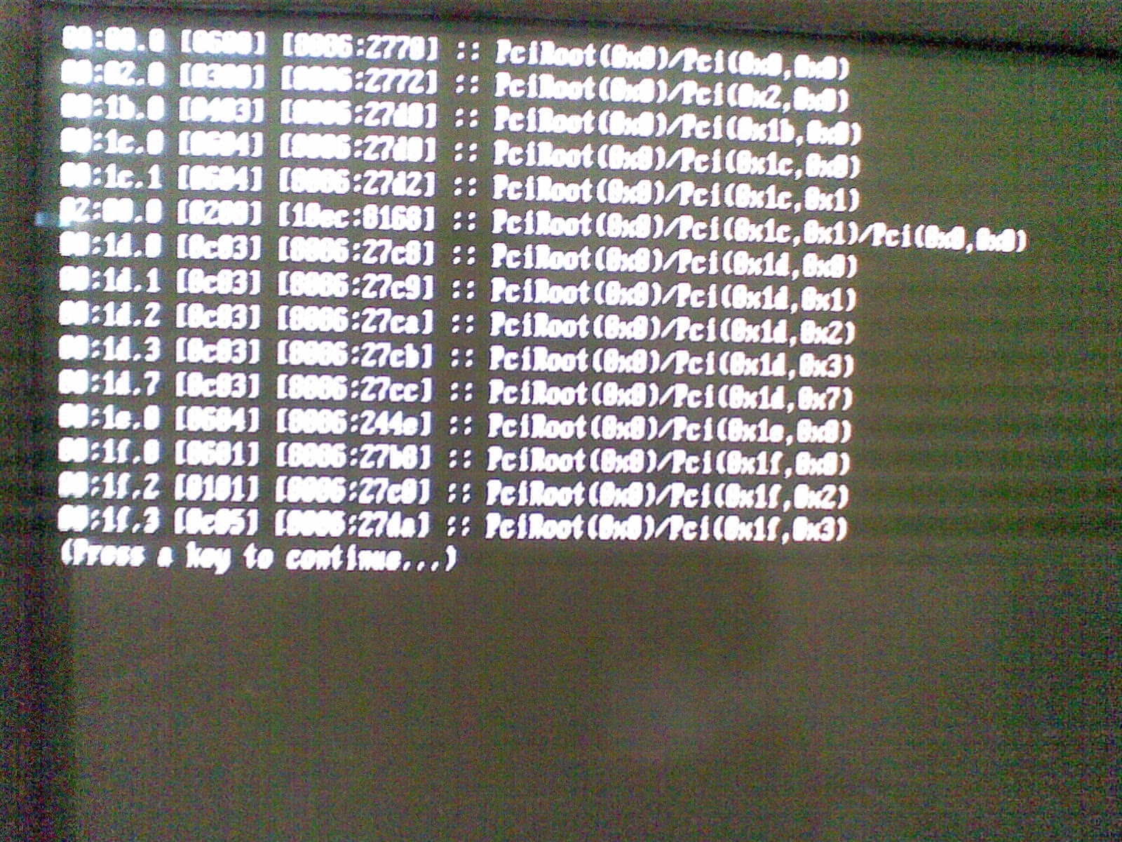

Dr. Hurt Posted January 9, 2010 Share Posted January 9, 2010 Hi Asere. You're right about me confusing serial with part number. Here is my debug information using version 1.1.2 (sorry for the picture quality - cell phone camera). BTW, I have noticed that after the boot0/boot1 message, I get a blinking cursor for 2 seconds then it writes a line "efi_something............" then OS X starts booting. Is there anyway to make the boot loader silent? At least hide the blinking cursor and the efi_.... message vielen Dank Link to comment https://www.insanelymac.com/forum/topic/201902-chameleon-rc4-is-out/page/4/#findComment-1380578 Share on other sites More sharing options...
