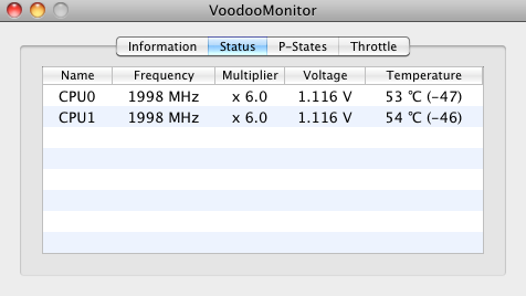

tinush Posted June 29, 2010 Share Posted June 29, 2010 @ mm67 Hi there mm67, can i ask a question? My previous Gigabyte board died and got a asus p5q-em This board with a e8500 gives vanilla speedstep, but i'm not sure if all is OK (temps at idle 53c) Is there anything i can change to get the temps down (on windows it idles at 34c) Thnx T P5Q_EM_reg.zip dsdt.dsl_tinush_p5q_em.zip Link to comment https://www.insanelymac.com/forum/topic/181631-dsdt-vanilla-speedstep-generic-scope-_pr/page/65/#findComment-1500816 Share on other sites More sharing options...
mm67 Posted June 29, 2010 Share Posted June 29, 2010 @ mm67 Hi there mm67, can i ask a question? My previous Gigabyte board died and got a asus p5q-em This board with a e8500 gives vanilla speedstep, but i'm not sure if all is OK (temps at idle 53c) Is there anything i can change to get the temps down (on windows it idles at 34c) Thnx T It looks like you don't have C-states, add C1E and your temps should be same as on Windows. Link to comment https://www.insanelymac.com/forum/topic/181631-dsdt-vanilla-speedstep-generic-scope-_pr/page/65/#findComment-1500822 Share on other sites More sharing options...
