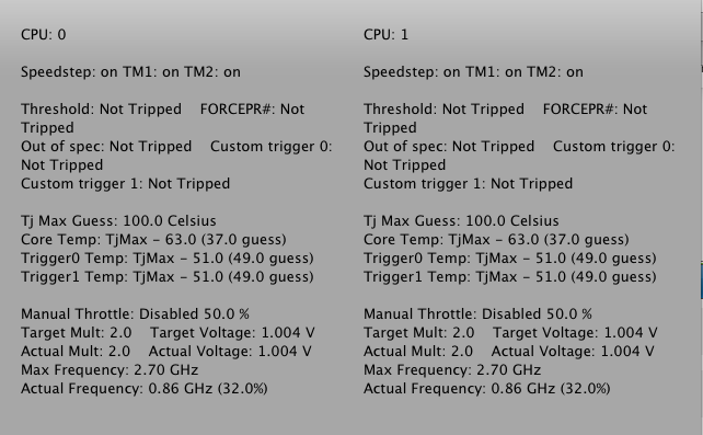

kdawg Posted June 27, 2010 Share Posted June 27, 2010 But i don't understand, this is the problem that i wrote some post ago. What is the difference? You are inserting with legacy the same parameters or no? I would say that i don't see the difference except the change to MacPro3,2 obviously. If you see voodoomonitor, the voltages drop together pstates? Or voltages remain always the higher value? Because otherwise i don't see the difference. After running a quick initial test using Keeza's DSDT patch, the voltage now is locked at maximum while my P states work normally. I need to run a few more tests to determine what happened. Using the CST from my earlier post C and P states seemed to work well even when overclocked. Link to comment https://www.insanelymac.com/forum/topic/181631-dsdt-vanilla-speedstep-generic-scope-_pr/page/63/#findComment-1499608 Share on other sites More sharing options...
mm67 Posted June 27, 2010 Share Posted June 27, 2010 After running a quick initial test using Keeza's DSDT patch, the voltage now is locked at maximum while my P states work normally. I need to run a few more tests to determine what happened. Using the CST from my earlier post C and P states seemed to work well even when overclocked. How are you monitoring the voltage ? VoodooMonitor does not show Vcore changes, mark-i and iStat with new Fakesmc will show the real Vcore that changes when C-states are working. Link to comment https://www.insanelymac.com/forum/topic/181631-dsdt-vanilla-speedstep-generic-scope-_pr/page/63/#findComment-1499612 Share on other sites More sharing options...
Smith@@™ Posted June 27, 2010 Share Posted June 27, 2010 After running a quick initial test using Keeza's DSDT patch, the voltage now is locked at maximum while my P states work normally. I need to run a few more tests to determine what happened. Using the CST from my earlier post C and P states seemed to work well even when overclocked. Ok, hence the problem about voltage could be given from cstate code? Another thing, but what is the advantage of using a legacy here, having to still enter the cstate code in the DSDT ? Thanks How are you monitoring the voltage ? VoodooMonitor does not show Vcore changes, mark-i and iStat with new Fakesmc will show the real Vcore that changes when C-states are working. voodoomonitor show me the vcore changes. istamenu with new fakesmc with plugin (rev 250) show me always the vcore higher (1,32v) like in bios. How do you do to see in voodoomonitor not vcore changes and in istat the drop of vcore together pstates? For me is completely the opposite. Link to comment https://www.insanelymac.com/forum/topic/181631-dsdt-vanilla-speedstep-generic-scope-_pr/page/63/#findComment-1499613 Share on other sites More sharing options...
kdawg Posted June 27, 2010 Share Posted June 27, 2010 Ok, hence the problem about voltage could be given from cstate code? Another thing, but what is the advantage of using a legacy here, having to still enter the cstate code in the DSDT ? Thanks voodoomonitor show me the vcore changes. istamenu with new fakesmc with plugin (rev 250) show me always the vcore higher (1,32v) like in bios. How do you do to see in voodoomonitor not vcore changes and in istat the drop of vcore together pstates? For me is completely the opposite. @mm67 and Smith, I'm not using the legacy kext just the DSDT patch. I use mark-i exclusively for voltage because the current releases of FakeSMC tend to break C-States. I also tend to loose C-States when overclocking. Although until just recently overclocking and C-States were working. I need to find out what I did to loose them. Link to comment https://www.insanelymac.com/forum/topic/181631-dsdt-vanilla-speedstep-generic-scope-_pr/page/63/#findComment-1499629 Share on other sites More sharing options...
mm67 Posted June 27, 2010 Share Posted June 27, 2010 Ok, hence the problem about voltage could be given from cstate code? Another thing, but what is the advantage of using a legacy here, having to still enter the cstate code in the DSDT ? Thanks voodoomonitor show me the vcore changes. istamenu with new fakesmc with plugin (rev 250) show me always the vcore higher (1,32v) like in bios. How do you do to see in voodoomonitor not vcore changes and in istat the drop of vcore together pstates? For me is completely the opposite. VoodooMonitor only shows the VID, on iStat I see real Vcore changing like this, idle: On full load: Link to comment https://www.insanelymac.com/forum/topic/181631-dsdt-vanilla-speedstep-generic-scope-_pr/page/63/#findComment-1499631 Share on other sites More sharing options...
Smith@@™ Posted June 27, 2010 Share Posted June 27, 2010 @mm67 and Smith,I'm not using the legacy kext just the DSDT patch. I use mark-i exclusively for voltage because the current releases of FakeSMC tend to break C-States. I also tend to loose C-States when overclocking. Although until just recently overclocking and C-States were working. I need to find out what I did to loose them. Can you attach your version of mark-i? All that i try don't work well on my series p5q. Link to comment https://www.insanelymac.com/forum/topic/181631-dsdt-vanilla-speedstep-generic-scope-_pr/page/63/#findComment-1499632 Share on other sites More sharing options...
