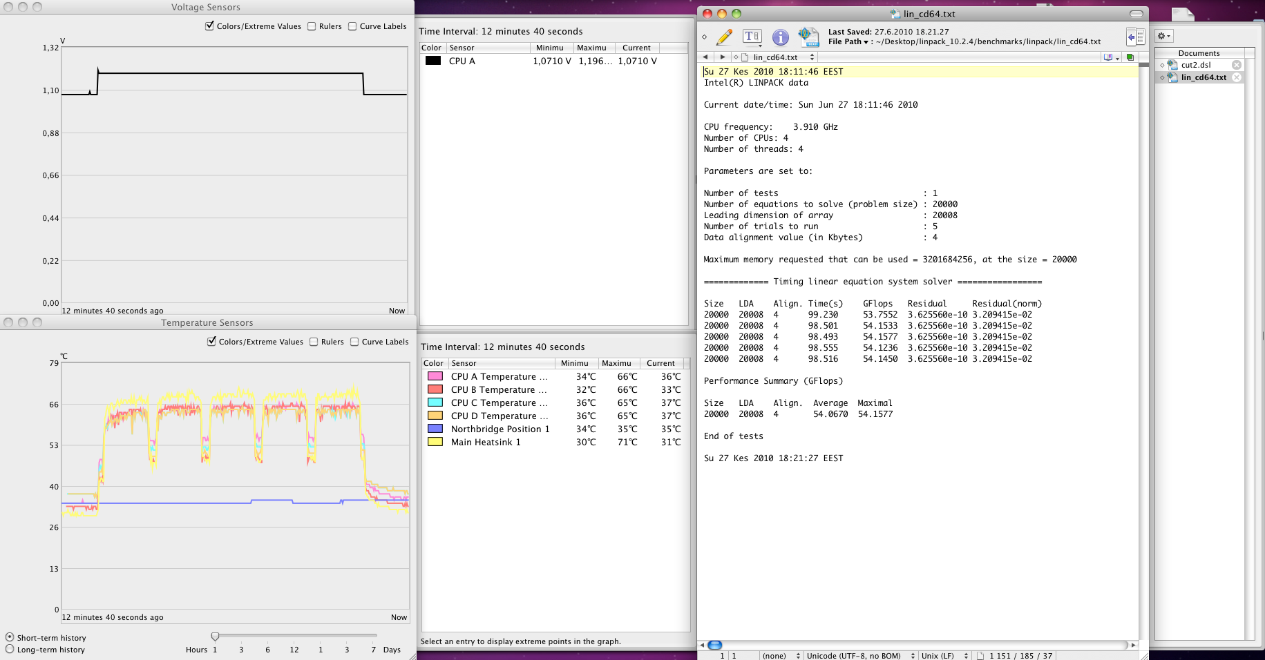

With Keeza's patch no overclock
With Keeza's patch overclocked to 3.8GHz

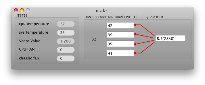

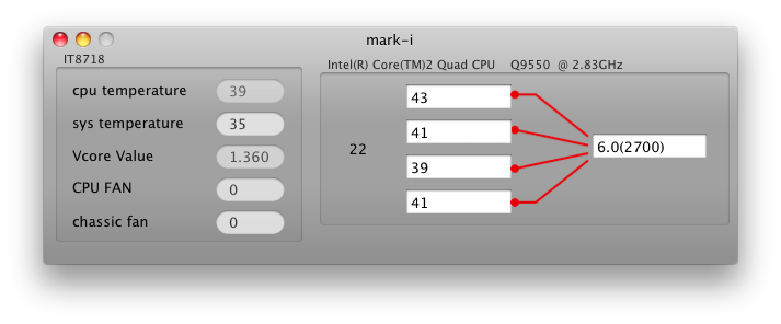

VoodooMonitor only shows the VID, on iStat I see real Vcore changing like this, idle:
On full load:
i don't know, istat don't show me the drop of voltage. Which plugin you're using? Winbound or ite? Or superio? Or acpimonitor with code in dsdt for fan, voltage, etc. etc.

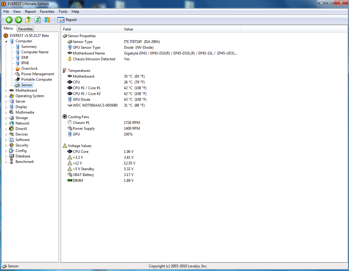

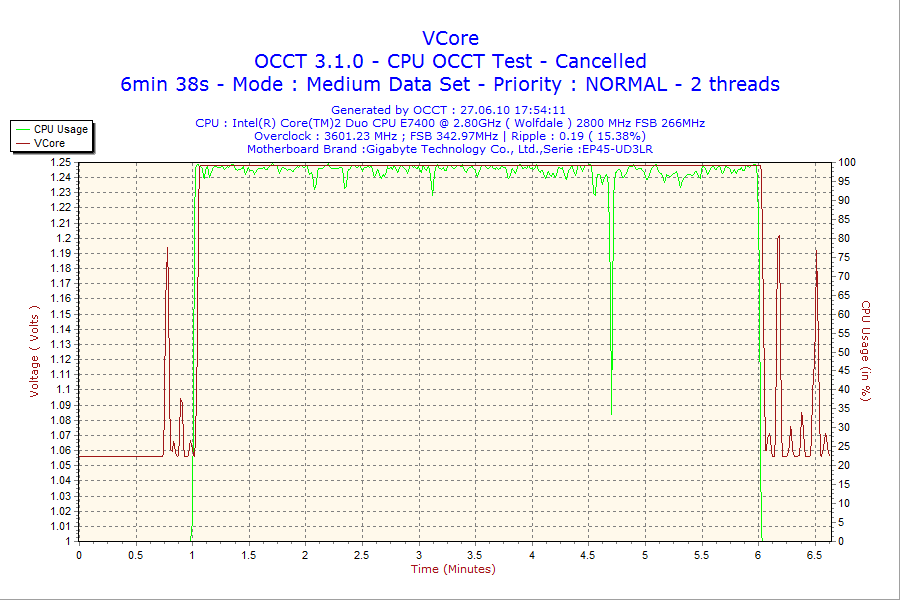

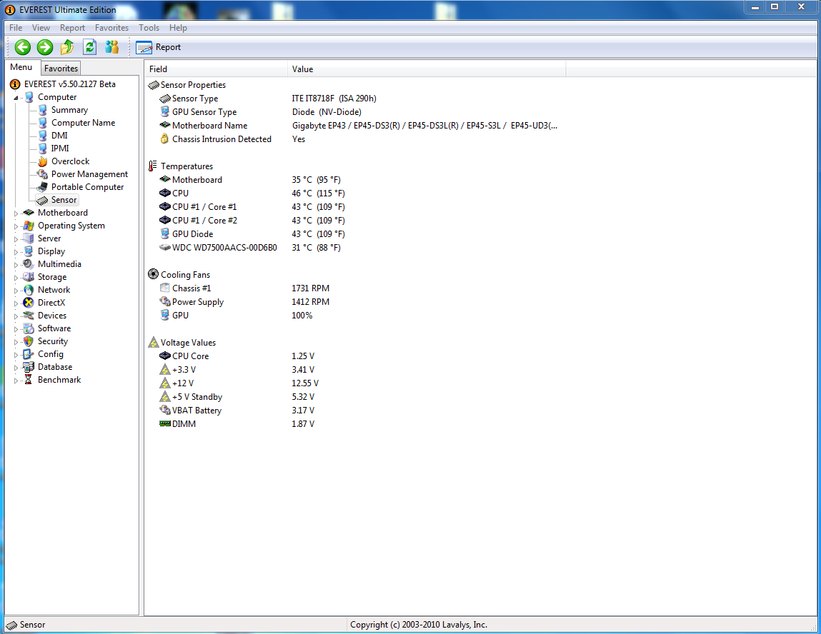

That's exactly what you see on that OCCT screenshot, Vcore is 1.06 V when idling, on load it goes to 1.25 V. And do remember that I have LLC enabled so there is no Vdroop, only a very small Vdrop. Without LLC graphics would look bit different.
Ok, but i need a confirmation, by the way, what is the program that you use on osx in screen. Occt?
OCCT is a Windows program, on OS X I use Hardware Monitor 4.9. Here are some Everest screenshots.
Idle:
On load:
Oh finally! Thanks so much for confirmation, thanks :( These screen are "amazing" for me now, because delete my doubts. In that screens on my series p5q i see always the same voltage in load and in idle :)
