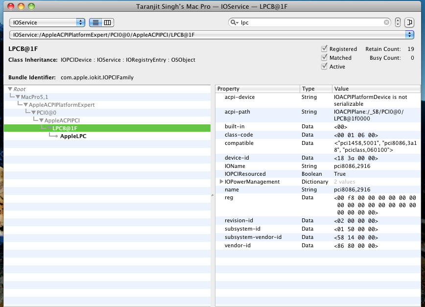

EDIT - also (sorry if you've already covered this) .. but do you have LPC device in IOReg??
I clear and reload caches everytime I add/reload kexts, always do it.
I patched the LPC code just like youve explained in your first post, its there in ioreg. I'll attach the snapshot. C states maybe? Also do I need to do the ssdt thing, havent yet figured out what ssdt means.

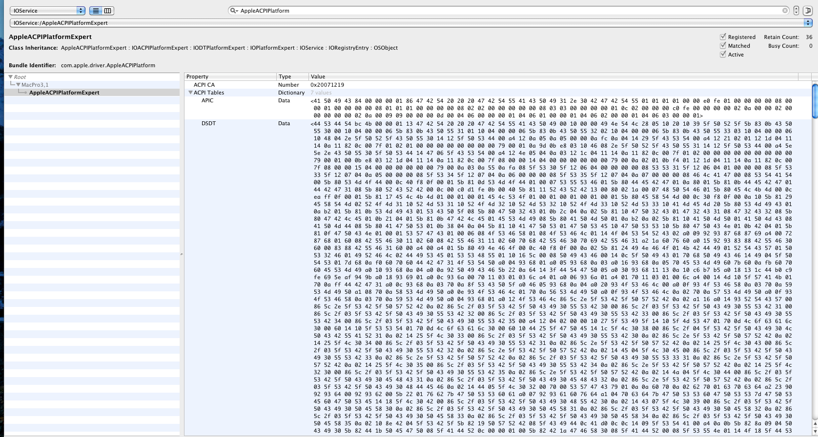

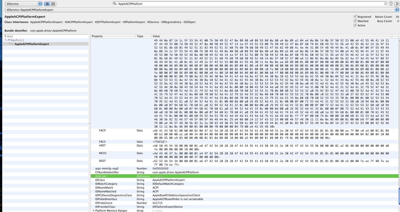

I think this is right but:
DropSSDT=Yes if you are using P-States from DSDT
DropSSDT=No if you want to test to see if it works natively without _PSS data in DSDT
You can see if native tables are loaded if you check AppleACPIPlatformExpert in Ioreg under ACPI Tables
Tried that t oo keeza, DropSSDT is set to NO now, booting without pstates in current DSDT.
Im attaching the ACPI Tables ioreg sshot, do I need to check for a specific setting under ACPI tables?

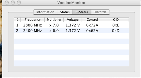

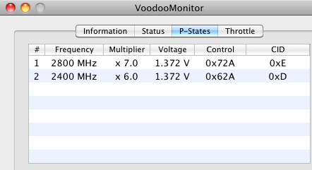

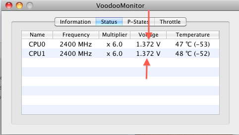

One other thing the 'Status' section in vmonitor, the voltage fluctuates from 1.372 to 1.164 very rarely,
but in 'P states' section stays stable at 1.372Voltage and 0x72A and 0x62A control instead of 0x61D

is it? use kextstat can you see appleLPC.kext or run I0regexplorer search LPC.

Kextstat finds apple.LPC !

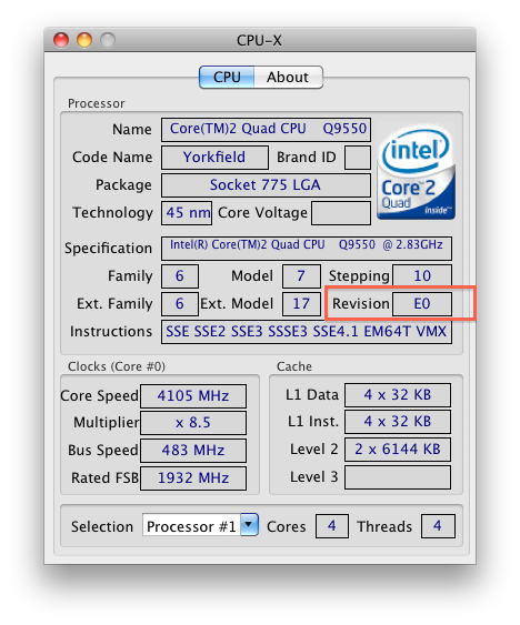

First you need to know what is the revision of your Q9550, if you have E0 like me then it is possible to use C-states C1E, C2E and C4E, if it is revision C0 then it will only do C1E.
You can use Cpu-X to check which revision of cpu you have.
I have E0 revision of Q9550

Just replace P-states with your own ones and you will have working P-states and C1E
"ioreg -lw0 | grep CSTInfo" returns nothing...
That means cst-tables don't load ?
