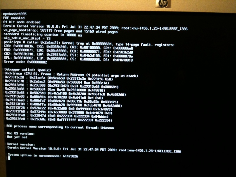

zhta1972 Posted August 25, 2009 Share Posted August 25, 2009 Anyone with success at Ga-EP45-DS3R ?, i'm getting panics at boot "Mac osx version: not yet set" i tried almost everything , bootloaders , edit PlatformUUID , boot with -x32 , boot -x , dsmos , fakesmc and so on... After the kexts loading at first boot , i'm getting a panic "Mac osx version : Not yet set" Anyone had success with same motherboard ? GA-EP45-DS3R ? Any Ideas ? Thank you... Link to comment https://www.insanelymac.com/forum/topic/181098-try-to-install-sl-on-a-ga-p35-ds3/page/3/#findComment-1235512 Share on other sites More sharing options...

longtom Posted August 26, 2009 Share Posted August 26, 2009 Anyone with success at Ga-EP45-DS3R ?, i'm getting panics at boot "Mac osx version: not yet set" i tried almost everything , bootloaders , edit PlatformUUID , boot with -x32 , boot -x , dsmos , fakesmc and so on... After the kexts loading at first boot , i'm getting a panic "Mac osx version : Not yet set" Anyone had success with same motherboard ? GA-EP45-DS3R ? Any Ideas ? Thank you... Try to install it from an USB or external HDD, like this Guide. Worked for me till now, previously had same problem as you. Now i can't install Chameleon on Snow partition, gonna boot from external Harddrive and refer to Snow Partition for copying user files. Keep you informed... Link to comment https://www.insanelymac.com/forum/topic/181098-try-to-install-sl-on-a-ga-p35-ds3/page/3/#findComment-1236017 Share on other sites More sharing options...

ximekon Posted August 26, 2009 Share Posted August 26, 2009 Still got the same kernel panic on my GA-EP35-DS3L with this kit, although the video was in the right resolution. what does your kernel panic say exactly? did you change uuid in smbios.plist and platformuuid.kext? did you boot with -x32 to 32bit mode? did you try to run into single user mode to create mkext for snow leo first? Link to comment https://www.insanelymac.com/forum/topic/181098-try-to-install-sl-on-a-ga-p35-ds3/page/3/#findComment-1236375 Share on other sites More sharing options...
derpuma Posted August 26, 2009 Author Share Posted August 26, 2009 Yeah, ximekon is right! See the Textfile in my files and do that 3 Lines in Singel User Mode Terminal... Means Bott up SL with -x32 -s and you can do these 3 steps! Link to comment https://www.insanelymac.com/forum/topic/181098-try-to-install-sl-on-a-ga-p35-ds3/page/3/#findComment-1236400 Share on other sites More sharing options...

se_dony Posted August 26, 2009 Share Posted August 26, 2009 hi! installed snow leopard just fine. installed chameleon 2.0rc1, netkas pcefi 10.1 and the DSDT.aml and kernel extensions from from derpuma. i have set the kernel flag for 32bit in my com.apple.Boot.plist when trying to boot i get a kernel panics like zhta1972: "Mac osx version: not yet set" at the top of the kernel panic it says that the it's using the 64bit kernel. even if i specify the -x32 flag at the chameleon boot prompt it loads the 64bit kernel and panics right after loading the extensions (no matter if in single user mode or whatever...) any ideas? my board is a ga-p35-ds3 rev. 1.0 thanks in advance Link to comment https://www.insanelymac.com/forum/topic/181098-try-to-install-sl-on-a-ga-p35-ds3/page/3/#findComment-1236567 Share on other sites More sharing options...
nameless2k Posted August 26, 2009 Share Posted August 26, 2009 hi! installed snow leopard just fine. installed chameleon 2.0rc1, netkas pcefi 10.1 and the DSDT.aml and kernel extensions from from derpuma. i have set the kernel flag for 32bit in my com.apple.Boot.plist when trying to boot i get a kernel panics like zhta1972: "Mac osx version: not yet set" at the top of the kernel panik it says that the it's using the 64bit kernel. even if i specify the -x32 flag at the chameleon boot prompt it loads the 64bit kernel and panics right after loading the extensions (no matter if in single user mode or whatever...) any ideas? my board is a ga-p35-ds3 rev. 1.0 thanks in advance everybody: screenshots of kp's please. no clairvoyants here who can see your screens magically from all over the planet - tried the usbboot stick from above? - permissions set to partition/harddrive prior to installation? read blackosx's snow leopard tutorial - right uuid in platformuuid.kext and smbios.plist? - ahci enabled in bios? - mkext created on first snow leo boot? read derpuma's snow leopard textfiles that come with his kexts - linux harddisks attached? detach (unplug cable!) Link to comment https://www.insanelymac.com/forum/topic/181098-try-to-install-sl-on-a-ga-p35-ds3/page/3/#findComment-1236598 Share on other sites More sharing options...
se_dony Posted August 26, 2009 Share Posted August 26, 2009 everybody: screenshots of kp's please. no clairvoyants here who can see your screens magically from all over the planet - tried the usbboot stick from above? - permissions set to partition/harddrive prior to installation? read blackosx's snow leopard tutorial - right uuid in platformuuid.kext and smbios.plist? - ahci enabled in bios? - mkext created on first snow leo boot? read derpuma's snow leopard textfiles that come with his kexts - linux harddisks attached? detach (unplug cable!) ok, you're right about the screenshot. here is exactly what i did or what my system looks like: ahci enabled in bios guid partitioned hdd 1. partition snow leopard, 2. partition leopard set permissions (as mentioned in blackosx's guide) installed snow leopard from leopard onto 1. partition installed chameleon 2.0 rc1 and pcefi 10.1 copied stuff from der puma package to /Extra/ changed the uuid in platformuuid.kext and smbios.plist after this i rebooted and could not get snow leopard to boot a single time, not even in single user mode. hence i never got to creating mkext. the kernel panic comes right after loading the kexts, no matter what kernel flag or boot option i chose (tried -s, -v, -x, -x32). you can see in the screenshot that it still says "64 bit mode enabled" is this normal, even when i boot with -x32? i did not get the usb pen drive from above to boot (i do have to restore the dmg to the guid formated usb pen drive, right?) things that might result in problems: i never fixed or cared about any permissions on the disk. might this be a problem? what permissions should all the stuff in /Extra/ have? i used the dsdt.aml from derpuma, he has the same mainboard i think. might this pose a problem? ideas: i don't know why, but i guess somehow it's still booting the 64 bit kernel. even though i got -x32 in the com.apple.boot.plist and at the chameleon prompt. any ideas? thanks Link to comment https://www.insanelymac.com/forum/topic/181098-try-to-install-sl-on-a-ga-p35-ds3/page/3/#findComment-1236862 Share on other sites More sharing options...
