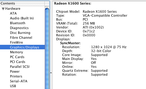

rsr Posted August 1, 2006 Share Posted August 1, 2006 Hey there... following this thread for a while now... Have Sapphire X1600 Pro AGP w/ 256 MB of memory on a Dell Dimension (P4 w/ Intel MoBo). Using Jas 10.4.6 plus 10.4.7 update + borisbadenov3.2... Great work! Everything works except DVI connector... a few questions: is it possible to change the login window resolution to the resolution of the deskop? Computer starts with lower rez during login and switches desktop to correct resolution once logged in... card is seen as PCI not AGP card... Xbench 2D Graphics Speed is kind of sluggish (30something range) but still acceptable. Can this be changed with the AGPart driver from the other thread? Or should I stay with what I have which is good enough... Better than ATI 9800 Pro with mouse tearing and mouse completely broken after iPhoto slide show, for example. ACPI S3 not working at all... Computer has to be hard-reset... Anybody managed to get around this? slightly Off Topic: Sound works in general but some applications (most noteably Skype and GarageBand) are mute. Though they do work with USB headset... Cheers R Does it get any better than this: Link to comment https://www.insanelymac.com/forum/topic/17767-borisbadenov-ati-x1000-series-solution/page/47/#findComment-153475 Share on other sites More sharing options...
barnz0432 Posted August 1, 2006 Share Posted August 1, 2006 I finally got my x1600xt fully working with the ripple in dashboard QE CE full Resolution Switching and i have mirror...but it says not supported, but it does work if I use dvi to analog converter on the dvi. Rotation is also supported All I did is have it updated to 10.4.6 and edit the ATINDRV.kext and replaced "<string>ATY,Wormy</string> to this <string>display</string>" and <string>IONDRVDevice</string> to this <string>IOPCIDevice</string> I tried many differnt solutions. The Neopheus installer 3.2, completely made my system unusable with artifacts, the boris method only gave me resolution and refresh switching. By just editing the atidrv.kext file made everything function like it should. iMovie, Final Cut, and the DVD player all function like they did with the gma 900. I found out that editing all the other files besides the atindrv seems unnessary because the acceleration works without any editing, the card just needs to be recognized to get the resolution and refresh without the tearing that you would get normally without any editing or just going into the boot.plist to lock the resolution. here is just some updated info for you guys. If if wasnt for everyone here at osx86 I couldnt have done it barnz0432 I just read your post. I had an old asus p4c800e deluxe board that the sound was the same as what you have now. I had to plug the speakers into the line out (blue connector to get garageband to play properly) barnz0432 Link to comment https://www.insanelymac.com/forum/topic/17767-borisbadenov-ati-x1000-series-solution/page/47/#findComment-153492 Share on other sites More sharing options...
cyclonefr Posted August 1, 2006 Share Posted August 1, 2006 barnz0432 we already knew that... for the X1600 PRO AGP : im having exactly the same issue, that could be fixed by the AppleI386.kext but still work in progress... For the ACPI S3 : no solution So u r all set Link to comment https://www.insanelymac.com/forum/topic/17767-borisbadenov-ati-x1000-series-solution/page/47/#findComment-153514 Share on other sites More sharing options...

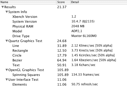

rsr Posted August 2, 2006 Share Posted August 2, 2006 for the X1600 PRO AGP : im having exactly the same issue, that could be fixed by the AppleI386.kext but still work in progress... Thanks for your reply... I just ran Xbench again for the graphics and attaching the results... This was significantly higher for my Radeon 9800 Pro / AGP. So in general, when having the "right" AppleI386.kext it should be possible to have that same performance on the X1600 Pro AGP as well? Link to comment https://www.insanelymac.com/forum/topic/17767-borisbadenov-ati-x1000-series-solution/page/47/#findComment-154042 Share on other sites More sharing options...
cyclonefr Posted August 2, 2006 Share Posted August 2, 2006 rsr yep u said it! Link to comment https://www.insanelymac.com/forum/topic/17767-borisbadenov-ati-x1000-series-solution/page/47/#findComment-154054 Share on other sites More sharing options...
