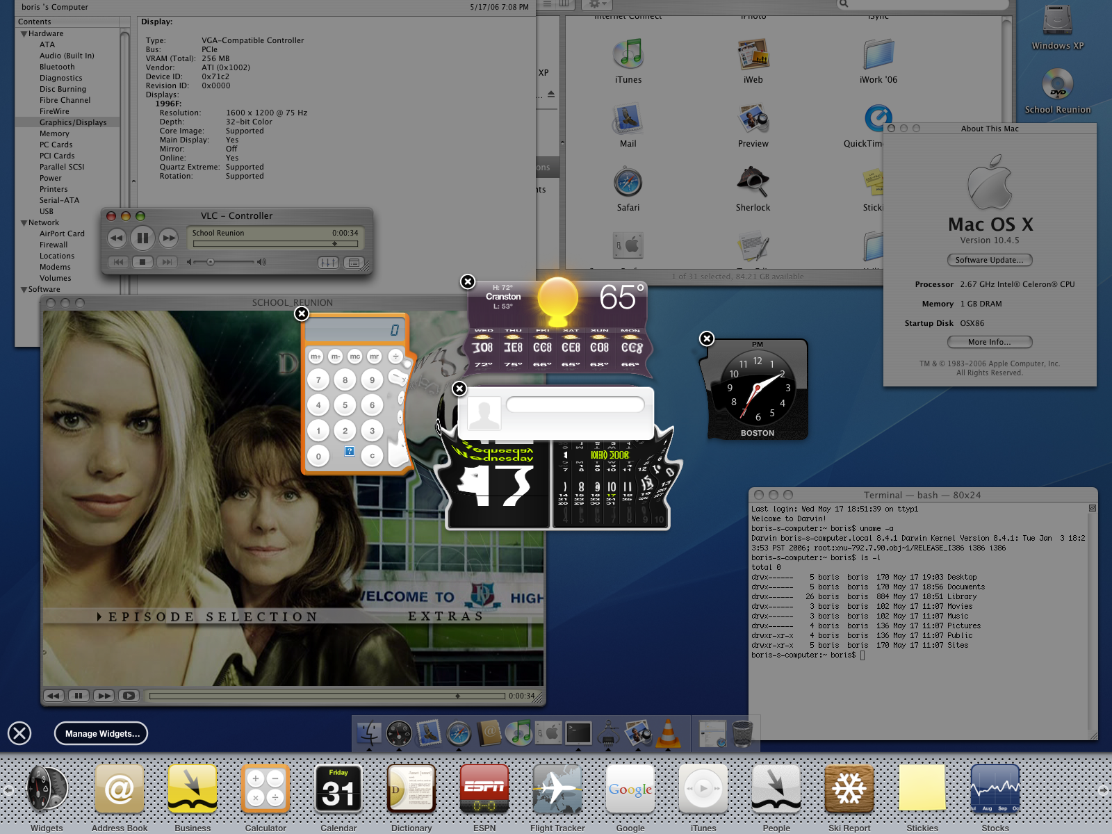

borisbadenov Posted May 17, 2006 Share Posted May 17, 2006 Regarding ATI X1600 Pro PCI-E. I would concider myself not much of a serious hacker but I did manage to get full compatability with my video card. I have an ASRock 775 Dual 915GL mobo, Celeron D 330J with onboard GMA900 and running 10.4.5. I recently purchased a MSI X1600 Pro PCI-E video card, read tons on this site, made notes, etc and after a good day's work, I finally got my card to work 100% with my set-up. Full QE-CI, refreshrates, resolutions changing, etc and not tearing! Look at my screen shot to prove it. Before I installed my card, I deleted all other ATI files (in the /system/library/extensions), the I edited my plist in each of the ATIRadeonX1000 files to match my device <key>IOPCIMatch</key> <string>0x71C21002</string> Then, inside my ATINDRV.kext, change <string>IONDRVDevice</string> to <string>IOPCIDevice</string> and change this line <key>IONameMatch</key> <string>ATY,WORMY</string> to read <key>IONameMatch</key><string>display</string> In the ATIRadeonX1000GA.plugin, you need to change your device ID twice and do note that it need to be backwards, <key>100271C2-0000-0000-0000-000a27898d3e</key> and <string>100271C2-0000-0000-0000-000a27898d3e</string> In all the plists, I just dele=ted all other references to other device ID's After this, I deleted the mext and kext.cache, and ran: sudo kext.cache -k /System/Library/Extentions AFter that, fix permissions, rebooted and smiled as my system worked as it should. Link to comment https://www.insanelymac.com/forum/topic/17767-borisbadenov-ati-x1000-series-solution/#findComment-114661 Share on other sites More sharing options...

dewdoobrown Posted May 18, 2006 Share Posted May 18, 2006 THANK YOU! I always had QE/CI working but NOT with resolution switching. Now my display panel shows all the refresh rates my monitors supports. I HIGHLY SUGGEST MODIFYING YOUR ATI FILES. I have an sapphire 512mb pci-e card. Now I can play games in any resolutions....and NO MORE TEARING......thank you Thank you! Now I am going to put my Dell FPW 20.1 DVI monitor and switch out my CRT. Kinda curious if I have dual monitor support.......BRB report back soon! Link to comment https://www.insanelymac.com/forum/topic/17767-borisbadenov-ati-x1000-series-solution/#findComment-114704 Share on other sites More sharing options...
borisbadenov Posted May 18, 2006 Share Posted May 18, 2006 dewdoobrown, Glad to hear I could have been a help. Now with this this final piece to the puzzle fixed, I think it is time for my Mactell to become my main OS Asapreta, as far as your card goes, I do not know but try it out and let us all know. Just back everything up so if it doesn't work, you can still easily repair your system. Remember, the terminal is your friend Link to comment https://www.insanelymac.com/forum/topic/17767-borisbadenov-ati-x1000-series-solution/#findComment-114747 Share on other sites More sharing options...

borisbadenov Posted May 18, 2006 Share Posted May 18, 2006 following these instructions?without using callisto??i0ve a sapphire x1600xt too, mac 10.4.6, qi/ce working but no cahnging resolution available...do u think i'm right following these steps?? thank u very much I have tried callisto and it never woked for me; using the exact instructions, each time I tried to change resolutions or refresh rate, my "mac" would die, saying I would need to reboot. I just began to tinker around and this worked for me, and others it seems. Follow the steps and maybe, in each of the ATI kexts, make sure you replace your device id as also replace IONDRVDevice for IOPCIDevice. Be sure to remove mkext and kext.cache and repair permissions Link to comment https://www.insanelymac.com/forum/topic/17767-borisbadenov-ati-x1000-series-solution/#findComment-114909 Share on other sites More sharing options...
