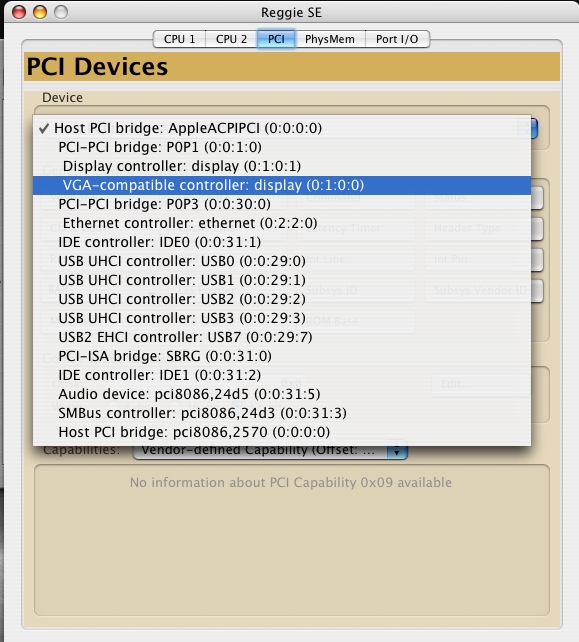

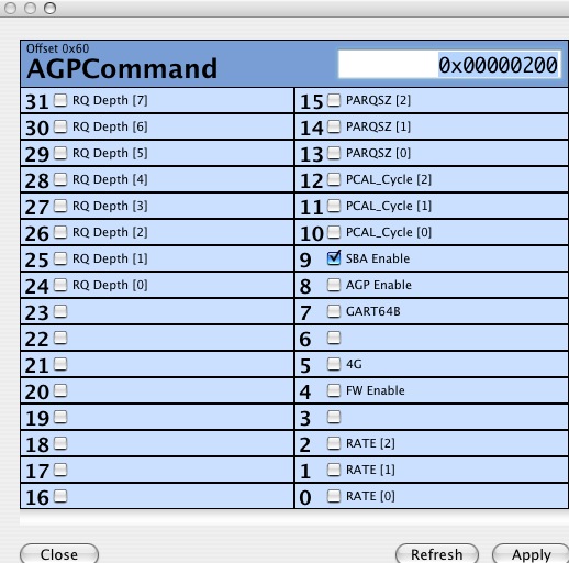

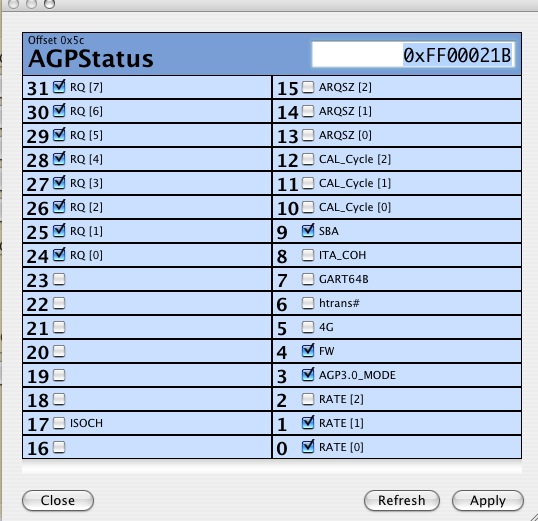

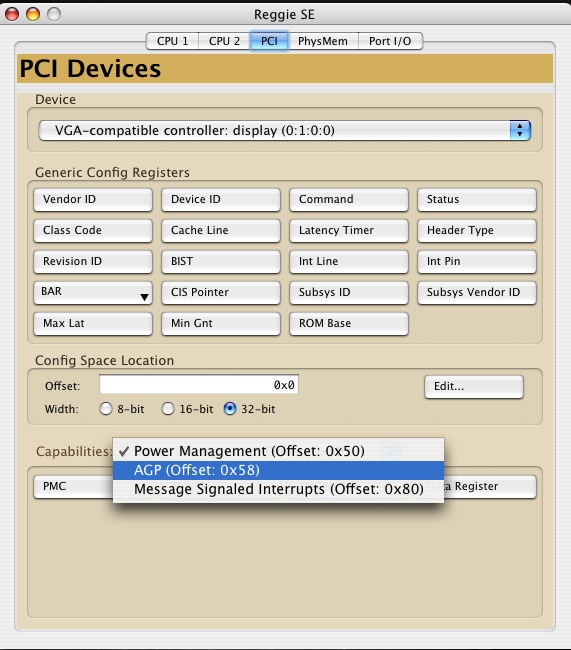

gu3d3s Posted September 13, 2006 Share Posted September 13, 2006 Hi friends, cyclonefr, you knows a program called reggie SE, it supplies varies information on hardware, and is part of developertools of apple, can be that it in help to make to function bus AGP + x1600 of one looked at. thanks guedes jr Link to comment https://www.insanelymac.com/forum/topic/17767-borisbadenov-ati-x1000-series-solution/page/51/#findComment-187585 Share on other sites More sharing options...
cyclonefr Posted September 13, 2006 Share Posted September 13, 2006 i dont know at all what it is...u should ask to tomh and joblo who r programming the agpgart driver...Btw did u flash ur sapphire with the latest bios? Link to comment https://www.insanelymac.com/forum/topic/17767-borisbadenov-ati-x1000-series-solution/page/51/#findComment-187586 Share on other sites More sharing options...
gu3d3s Posted September 13, 2006 Share Posted September 13, 2006 hi, not, I very found the high values in matching to the originals, you saw the values of fixed Core 590mhz? what you find? valley to run the risk? if system AGP to function I believe that we go to have an improvement of 40 50% in relation to the video... you spoke with the JaS on the subject? what it finds? []'s guedes jr EDIT: it sees this...: my hope is that these information can help! Link to comment https://www.insanelymac.com/forum/topic/17767-borisbadenov-ati-x1000-series-solution/page/51/#findComment-187688 Share on other sites More sharing options...
