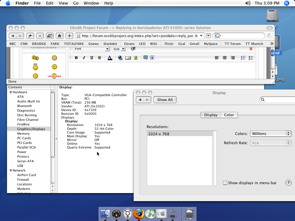

DrivinWest Posted June 8, 2006 Share Posted June 8, 2006 It seems that most people with the x1800s don't display anything or crash using 10.4.6 (right?). I can confirm my Sapphire x1800XL is working with the JaS 10.4.6 installation DVD using one of the two DVI outs though I am getting artifacts. This is with a fresh install and GMA900 NOT selected (though I do have GMA900 onboard). Now working on solving the artifact problem... Link to comment https://www.insanelymac.com/forum/topic/17767-borisbadenov-ati-x1000-series-solution/page/34/#findComment-126861 Share on other sites More sharing options...

DrivinWest Posted June 8, 2006 Share Posted June 8, 2006 I've read most of this thread through and through and as far as I can tell my situation is unique (but good!) so I'm hoping you guys in the know can give me your two cents. As I mentioned above I'm using an Sapphire x1800XL card with a DVI out to my LCD. Install was a fresh JaS 10.4.6 with GMA900 unselected even though I have GMA900 onboard. Take a look at my system profiler below: It says that QE and CI are supported. Can this be right? Before you guys applied the Boris method weren't you getting QE and CI as unsupported? Boris' 1st post included a screenshot which I'm assuming proved that CI and QE were working based on the widget ripples (right?). Anyway, here's mine: As you'll see from the 1st picture my resolution is limited to 1024x768 and I am getting some artifacts/mouse tearing. Can anybody shed some light on my system? Are my CI and QE really working? If so, is it really unique to have CI and QE working without having to do anything? Any suggestions on which steps to take 1st to get full resolution selection and eliminate artifacts? Thanks! Link to comment https://www.insanelymac.com/forum/topic/17767-borisbadenov-ati-x1000-series-solution/page/34/#findComment-126876 Share on other sites More sharing options...
