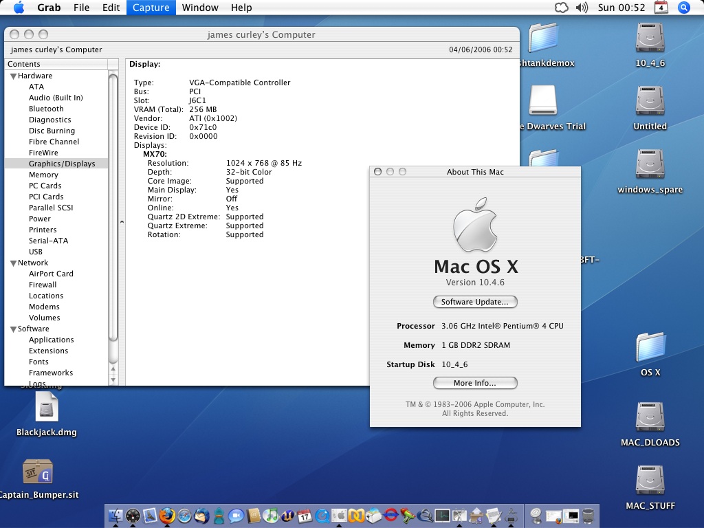

curlyboy Posted June 3, 2006 Share Posted June 3, 2006 Heres my ATIradeonX1000GA.plugin <?xml version="1.0" encoding="UTF-8"?> <!DOCTYPE plist PUBLIC "-//Apple Computer//DTD PLIST 1.0//EN" "http://www.apple.com/DTDs/PropertyList-1.0.dtd"> <plist version="1.0"> <dict> <key>CFBundleDevelopmentRegion</key> <string>English</string> <key>CFBundleExecutable</key> <string>ATIRadeonX1000GA</string> <key>CFBundleGetInfoString</key> <string>ATIRadeonX1000GA 1.4.26.11 (3493)</string> <key>CFBundleIdentifier</key> <string>com.apple.ATIRadeonX1000GA</string> <key>CFBundleName</key> <string>ATI RadeonX1000 Graphics Driver</string> <key>CFBundleShortVersionString</key> <string>1.4.26</string> <key>CFBundleVersion</key> <string>4.2.6</string> <key>CFPlugInDynamicRegistration</key> <string>NO</string> <key>CFPlugInFactories</key> <dict> <key>100271c0-0000-0000-0000-000a27898d3e</key> <string>ATIRadeonX1000GAFactory</string> </dict> <key>CFPlugInTypes</key> <dict> <key>ACCF0000-0000-0000-0000-000a2789904e</key> <array> <string>100271c0-0000-0000-0000-000a27898d3e</string> </array> </dict> <key>NSExecutable</key> <string>ATIRadeonX1000GA</string> <key>Personality</key> <dict> <key>IOProviderClass</key> <string>IONDRVFramebuffer</string> </dict> </dict> </plist> And its Fully working Link to comment https://www.insanelymac.com/forum/topic/17767-borisbadenov-ati-x1000-series-solution/page/30/#findComment-124480 Share on other sites More sharing options...
curlyboy Posted June 4, 2006 Share Posted June 4, 2006 just discovered that when plugged into vga system and monitor completely shuts down the way its meant too but when i waken it up again the monitor wont ciome back , But when plugged into the dvi port with supplied adapter it works perfect How come ?????? Link to comment https://www.insanelymac.com/forum/topic/17767-borisbadenov-ati-x1000-series-solution/page/30/#findComment-124484 Share on other sites More sharing options...
