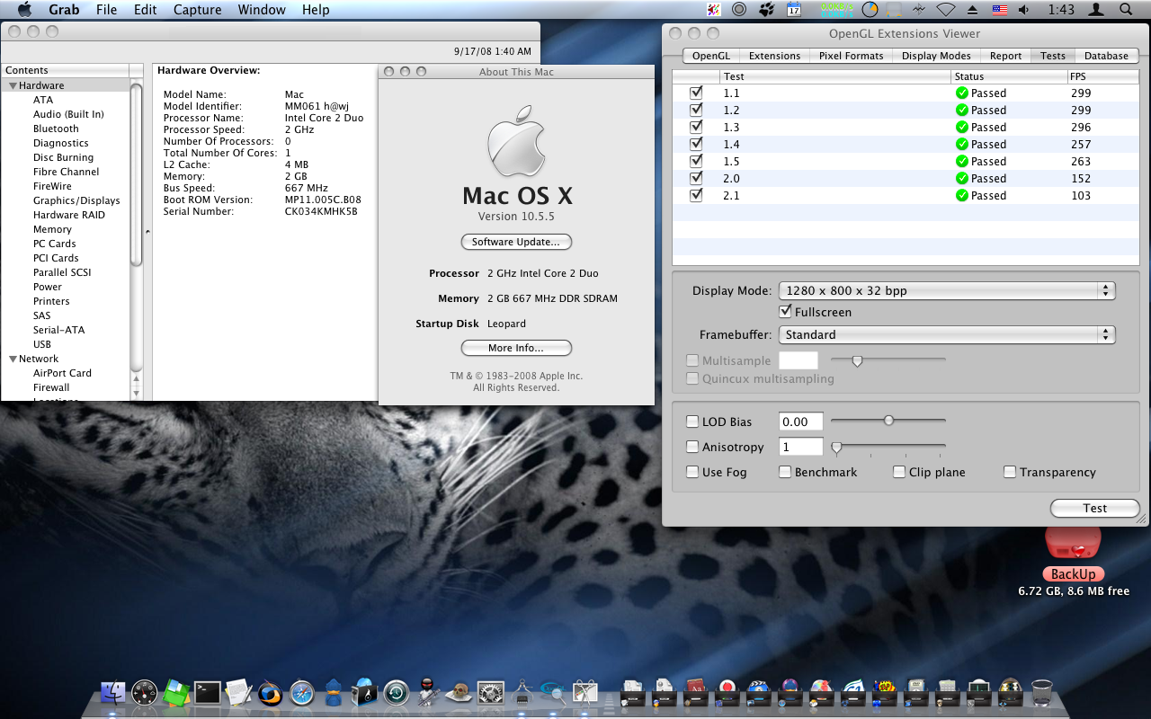

auqs10 Posted September 16, 2008 Share Posted September 16, 2008 Hi folks, yesterday the new 10.5.5 cat was launched and again I managed to install it respecting the method used for 10.5.2 , 10.5.3 and 10.5.4 Combo update packages. All parts are working (except 3in1 card reader) by using only one core (settings to start in com.apple.Boot.plist) are good, the speed is fine. The Intel GMA950 needs AppleIntelIntegratedFramebuffer.kext (192 kb/29.09.2007) otherwise the screen turns black after gray starting apple. The sound had to be patched (Taruga's v1.20 with dump file of Sigmatel9200.txt), and the IONetworkingFamily.kext (2.6 MB/11.11.2007) needs to be replaced. In order to have a good report of About This Mac needs replacing AppleSMBIOS.kext (52 kb/23.06.2008), the exact model of my Dell Inspiron 6400/E1505 it is shown MM061. Again I attached a screen capture to prove it. Link to comment https://www.insanelymac.com/forum/topic/15474-guide-dell-inspiron-6400940015201720e1405e1505e1705-intel-core-duo/page/68/#findComment-893542 Share on other sites More sharing options...
