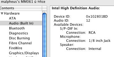

TheGreatDeceiver Posted October 28, 2008 Share Posted October 28, 2008 I tried the latest patch (35b) the only difference i noticed is that my sound card is actually now showing up in system profiler which is great! Unfortunately my problem still persists, the laptop speakers do not mute when I plug in my headphones. I've attached a screenshot of my sound card in the system profiler. I was also wondering what the hotkey is to switch to an external display? I had it working before with my atix1400 but haven't been able to get my nvidia gs7300 working yet. Gracias, Benos. hmm, here is mine: Intel High Definition Audio: Device ID: 0x102801BD Audio ID: 12 Available Devices: S/P-DIF Out: Connection: RCA Headphone: Connection: 1/8 inch Jack Speaker: Connection: Internal Microphone: Connection: 1/8 inch Jack the difference is that in my case headphones are listed, everything else is the same. are you sure you got the correct hda kext intalled in the end? maybe try to install it with kexthelper yourself instead of the dell patcher. delete or rename the original hda kext, then install new one, fix permissions. btw. which OSX version do you have installed? As for the external display I can't help you with my gma950. Mine works perfectly fine with external displays. Link to comment https://www.insanelymac.com/forum/topic/15474-guide-dell-inspiron-6400940015201720e1405e1505e1705-intel-core-duo/page/70/#findComment-946316 Share on other sites More sharing options...
sonotone Posted October 28, 2008 Share Posted October 28, 2008 I tried the latest patch (35b) you used; Build 0.35b (BETA) (updated 07/17/2008) but you need: Installer v1.3.1 (updated 10/21/2008) Link to comment https://www.insanelymac.com/forum/topic/15474-guide-dell-inspiron-6400940015201720e1405e1505e1705-intel-core-duo/page/70/#findComment-946472 Share on other sites More sharing options...
TheGreatDeceiver Posted October 28, 2008 Share Posted October 28, 2008 you used;Build 0.35b (BETA) (updated 07/17/2008) but you need: Installer v1.3.1 (updated 10/21/2008) ha, now that makes sense, haven't paid attention to that. hope he will be successful now. thanks Link to comment https://www.insanelymac.com/forum/topic/15474-guide-dell-inspiron-6400940015201720e1405e1505e1705-intel-core-duo/page/70/#findComment-947240 Share on other sites More sharing options...

benos Posted October 30, 2008 Share Posted October 30, 2008 ha, now that makes sense, haven't paid attention to that. hope he will be successful now. thanks Bad news guys The old installer seems to have worked way better... now when I use the latest installed I get no sound at all... here is a system profiler screenshot. I also received a BCM94311MCG wlan mini-pci (rev01) from ebay also known as the dell 1390, unfortunately can't get it to work either, I have a feeling it is the IONetworking.kext im using, I've got to try the vanilla 10.5.4 version, im not sure if the dell installer kept by original in backup because I have used the installer so many times? -Benos. -------------------------------------------------------------------------------------------------------------------------------------------------------- EDIT: I got my sound working properly with headphones! It could have been the pci kext i installed while trying to get this wireless card to work. The last sound kext i installed was from v1.12. If I work out what was going wrong I'll post details. For now I'm gonna get back to working on getting this Wireless card working. This topic seems to be very helpful to me - http://forum.insanelymac.com/index.php?sho...=128393&hl= Thanks again for all the help dudes -Benos. -------------------------------------------------------------------------------------------------------------------------------------------------------- EDIT: I was able to get my system fully supported now except for the MMC which I dont really care about, but unfortunately I still cannot get my external monitor working with this 7300gs i got from ebay, its vga port could be stuffed, because it says my cable is not connected in system profiler. I was able to get my Sigmatel9200 working by using the argus applehda patcher and then using the dell installer. Turns out some of my kexts like IONetworkingFamily and IOPCIFamily were old versions and I had to re-install iatkosv4i over the top to fix it. I recommend people use that kextload command shown in this topic - http://forum.insanelymac.com/index.php?sho...=128393&hl= - to check their kexts if they cannot get something to work. good luck maccing! -Benos. -------------------------------------------------------------------------------------------------------------------------------------------------------- EDIT: Special thanks to Jurek, he led me in the right direction to get my external display working, now I have a lovely setup . My broadcom ethernet is still dodgy but I can live with a reliable wireless for now. If anyone with an Inspiron 6400 is looking to get their Nvidia 7300Go working on 10.5.4 with dual display, I can guarantee that it works perfect Just look at this topic - http://forum.insanelymac.com/index.php?sho...mp;&do=findComment&comment=778676 Thanks again Jurek, Good luck dellintoshing, Peace out -Benos. Link to comment https://www.insanelymac.com/forum/topic/15474-guide-dell-inspiron-6400940015201720e1405e1505e1705-intel-core-duo/page/70/#findComment-948968 Share on other sites More sharing options...
