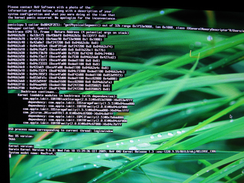

digital_dreamer Posted August 11, 2009 Author Share Posted August 11, 2009 Using 10.5.6 original, Mobo patch installer 3.7 hmmm. Something had changed system-wise. But, I can't tell from the kp log what that is. It's related to the SATA drives. It seems you using the GA/JMicron SATA ports. What do you have on those ports? I'd turn the Gigabyte/JMB322 SATA controller off and try to work without it, using the Intel SATA ports instead (blue/green), if at all possible. followed the script including the install of a RETAIL LEO 10.5.6 The main reason this install failed is because of using 10.5.6. 10.5.7 represents a major update for us Core i7 users in that it allows us to use the vanilla kernel (It's the first update that works with Apple's new Nephalem-based Mac Pros). The script is currently set up to NOT install a modified kernel by default, assuming you would be running 10.5.7. If, however, you want to run 10.5.6, then you would need to install a modified kernel and System.kext, like the Voodoo-based 9.6.0 kernel. That's simply a matter of extracting both files from the parent "Kernels/_Voodoo_9.6.0" folder and letting it reside directly in /Kernels. Then, run the Kext Installer again for the install. But, my suggestion is to install 10.5.7, instead, as that is uniquely designed for our systems and you can run the Apple-supplied kernel. You're almost there! best regards, MAJ EDIT: I might mention also, like the others have said, that most of the distros use a modified kernel in order to boot most systems. On our Core i7 systems, this requires a "busratio=20" flag (without the quotes), either at the boot prompt or within the kernel flags string in the boot.plist itself. Link to comment https://www.insanelymac.com/forum/topic/149505-guide-retail-os-x-install-1058-on-gigabyte-ga-ex58-ud5-core-i7-mobo/page/100/#findComment-1222556 Share on other sites More sharing options...
AppleIIGuy Posted August 11, 2009 Share Posted August 11, 2009 Failure. help please. That panic means you need jmicron ide kext patched to work with more than 4 gb of ram check out http://www.insanelymac.com/forum/index.php?showtopic=127611 Link to comment https://www.insanelymac.com/forum/topic/149505-guide-retail-os-x-install-1058-on-gigabyte-ga-ex58-ud5-core-i7-mobo/page/100/#findComment-1222578 Share on other sites More sharing options...
