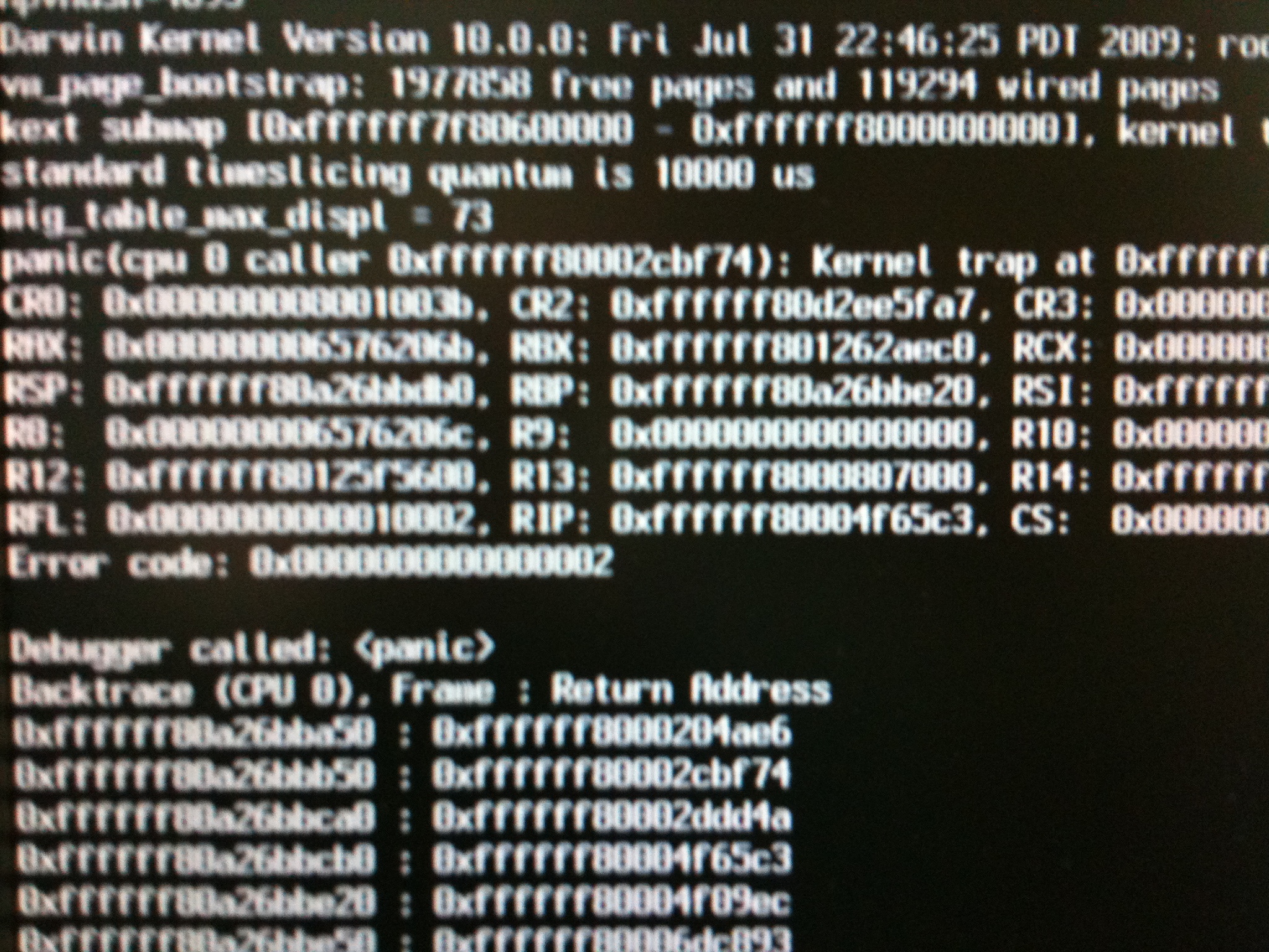

sanguine Posted August 22, 2009 Share Posted August 22, 2009 Hi, I would get a KP at the boot up see attached. What I did was run the script on my iMac, I stopped at "update boot caches" and also tried at "run DSDT patcher" both would give me tthe same KP. Any comments on where the cause of the problem is? cheers alvin Link to comment https://www.insanelymac.com/forum/topic/149505-guide-retail-os-x-install-1058-on-gigabyte-ga-ex58-ud5-core-i7-mobo/page/105/#findComment-1231725 Share on other sites More sharing options...

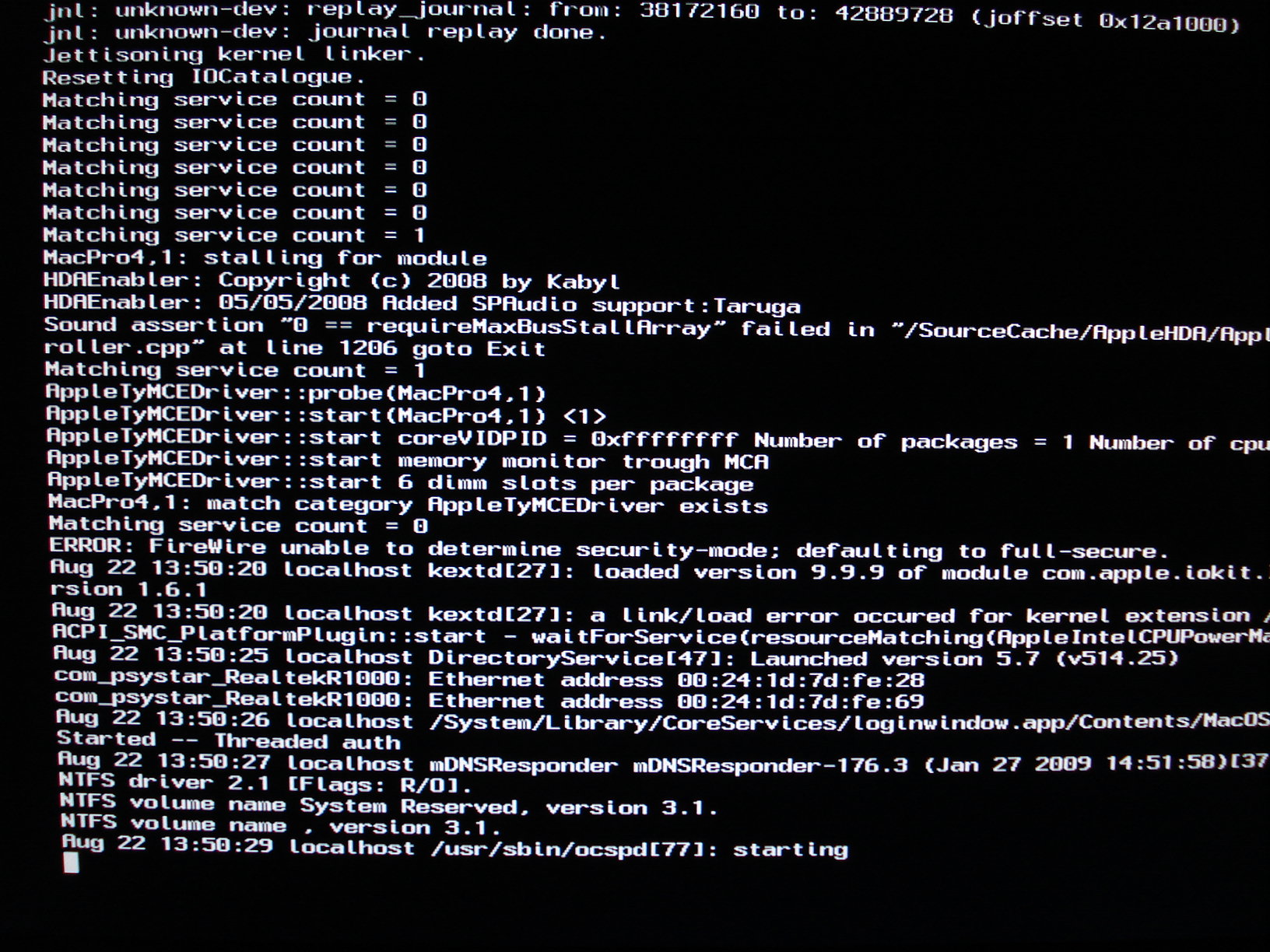

CruiSAr Posted August 22, 2009 Share Posted August 22, 2009 Hi Guys, I finally got my rig today and used DD's script to install Retail + 10.5.7 Combo Update. Did not run option 7 as the hard disk was not in my i7 build. Chameleon loads ok, I select osx and during boot, I get the dreaded grey wipe that tells me I need to restart my computer by holding the power button. I thought I missed a step so I reinstalled again but same error. Updated the bios to F8e, still no luck. Can anyone please tell me what the heck I am doing wrong? :censored2: lol I run in verbose mode and it gets stuck, see attahced image. My specs are GA-EX58-UD5 Core i7 @ 2.66 Ghz 12Gb Ram DDR3 Trichannel @ 1333Mhz Pioneer Bluray DVD combo Zotac GTX 285 1Gb Ram 2 X Western Digital Caviar Blue 640Gb I used the same bios settings as DD's picture in his install guide... Please Help Link to comment https://www.insanelymac.com/forum/topic/149505-guide-retail-os-x-install-1058-on-gigabyte-ga-ex58-ud5-core-i7-mobo/page/105/#findComment-1232303 Share on other sites More sharing options...
Tek Posted August 22, 2009 Share Posted August 22, 2009 Hi Guys, I finally got my rig today and used DD's script to install Retail + 10.5.7 Combo Update. Did not run option 7 as the hard disk was not in my i7 build. Chameleon loads ok, I select osx and during boot, I get the dreaded grey wipe that tells me I need to restart my computer by holding the power button. I thought I missed a step so I reinstalled again but same error. Updated the bios to F8e, still no luck. Can anyone please tell me what the heck I am doing wrong? :censored2: lol I run in verbose mode and it gets stuck, see attahced image. My specs are GA-EX58-UD5 Core i7 @ 2.66 Ghz 12Gb Ram DDR3 Trichannel @ 1333Mhz Pioneer Bluray DVD combo Zotac GTX 285 1Gb Ram 2 X Western Digital Caviar Blue 640Gb I used the same bios settings as DD's picture in his install guide... Please Help You mentioned you used the 10.5.7 combo update. I assume you're using the 10.5.6 retail DVD to install? I would try the 10.5.7 update and not the combo update. See what happens... Link to comment https://www.insanelymac.com/forum/topic/149505-guide-retail-os-x-install-1058-on-gigabyte-ga-ex58-ud5-core-i7-mobo/page/105/#findComment-1232324 Share on other sites More sharing options...
CruiSAr Posted August 22, 2009 Share Posted August 22, 2009 You mentioned you used the 10.5.7 combo update. I assume you're using the 10.5.6 retail DVD to install? I would try the 10.5.7 update and not the combo update. See what happens... Whats the difference betwen the 2 updates, I followed DD's directions explicitly...downloading the update now Link to comment https://www.insanelymac.com/forum/topic/149505-guide-retail-os-x-install-1058-on-gigabyte-ga-ex58-ud5-core-i7-mobo/page/105/#findComment-1232352 Share on other sites More sharing options...
Tek Posted August 22, 2009 Share Posted August 22, 2009 Whats the difference betwen the 2 updates, I followed DD's directions explicitly...downloading the update now The combo update allows you to upgrade from any 10.5 to 10.5.6 version to 10.5.7. The smaller update is only for updating from 10.5.6 to 10.5.7. I had problems with this before so its worth a try. Link to comment https://www.insanelymac.com/forum/topic/149505-guide-retail-os-x-install-1058-on-gigabyte-ga-ex58-ud5-core-i7-mobo/page/105/#findComment-1232354 Share on other sites More sharing options...
CruiSAr Posted August 22, 2009 Share Posted August 22, 2009 The combo update allows you to upgrade from any 10.5 to 10.5.6 version to 10.5.7. The smaller update is only for updating from 10.5.6 to 10.5.7. I had problems with this before so its worth a try. Ok, DVD was 10.5.6 so I will give it a try and see what happens...will post success or failure Link to comment https://www.insanelymac.com/forum/topic/149505-guide-retail-os-x-install-1058-on-gigabyte-ga-ex58-ud5-core-i7-mobo/page/105/#findComment-1232358 Share on other sites More sharing options...
CruiSAr Posted August 22, 2009 Share Posted August 22, 2009 The combo update allows you to upgrade from any 10.5 to 10.5.6 version to 10.5.7. The smaller update is only for updating from 10.5.6 to 10.5.7. I had problems with this before so its worth a try. Hi again Tek, No go, same error :-( , do you have more suggestions? Thanks in advance Link to comment https://www.insanelymac.com/forum/topic/149505-guide-retail-os-x-install-1058-on-gigabyte-ga-ex58-ud5-core-i7-mobo/page/105/#findComment-1232408 Share on other sites More sharing options...
L3B3R Posted August 23, 2009 Share Posted August 23, 2009 Hi again Tek, No go, same error :-( , do you have more suggestions? Thanks in advance That is a Mac error and may be due to your hardware. Try unplugging the Blueray player and see if that does anything. Just a thought. Link to comment https://www.insanelymac.com/forum/topic/149505-guide-retail-os-x-install-1058-on-gigabyte-ga-ex58-ud5-core-i7-mobo/page/105/#findComment-1232529 Share on other sites More sharing options...
CruiSAr Posted August 23, 2009 Share Posted August 23, 2009 That is a Mac error and may be due to your hardware. Try unplugging the Blueray player and see if that does anything. Just a thought. Still a no go . Its weird how some ppl can run DD'sscript and not have any problems. Anyways, I am fetching iAtkos V7, will install on my first HD and then try the retail install again on the second HD, maybe that might fix the problem Link to comment https://www.insanelymac.com/forum/topic/149505-guide-retail-os-x-install-1058-on-gigabyte-ga-ex58-ud5-core-i7-mobo/page/105/#findComment-1232648 Share on other sites More sharing options...
utya Posted August 23, 2009 Share Posted August 23, 2009 Cruisar, your problem is in GTX 285 1Gb Ram. Delete all graphics kext from script and than run script Link to comment https://www.insanelymac.com/forum/topic/149505-guide-retail-os-x-install-1058-on-gigabyte-ga-ex58-ud5-core-i7-mobo/page/105/#findComment-1232767 Share on other sites More sharing options...
CruiSAr Posted August 23, 2009 Share Posted August 23, 2009 Cruisar, your problem is in GTX 285 1Gb Ram. Delete all graphics kext from script and than run script Thanks a million, i did exactly what you said and was able to boot and after installed the kext for the GTX 285. I now have full retail install updated to 10.5.8, I however cant put the rig to sleep, it wakes up the moment I put i to sleep, any ideas? Thanks again Link to comment https://www.insanelymac.com/forum/topic/149505-guide-retail-os-x-install-1058-on-gigabyte-ga-ex58-ud5-core-i7-mobo/page/105/#findComment-1233361 Share on other sites More sharing options...
