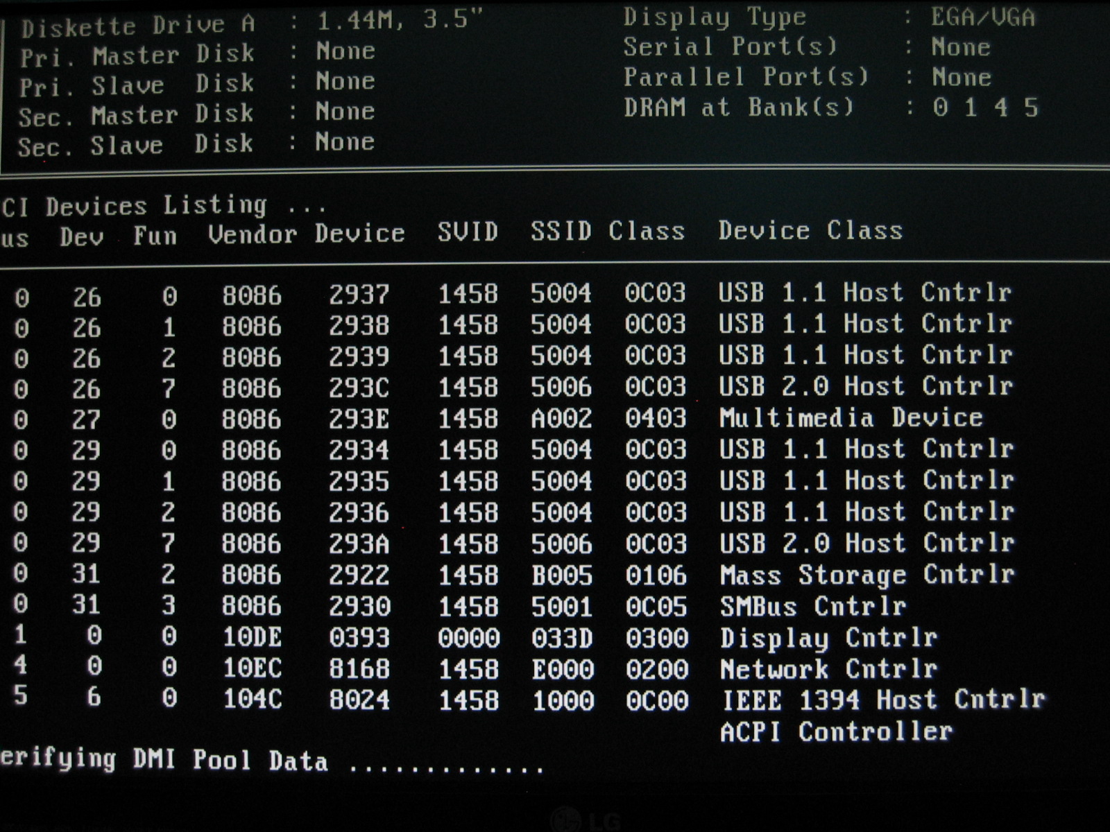

VCH888 Posted February 23, 2009 Share Posted February 23, 2009 To anyone I would like to learn something from your GA-E7AUM-DS2H. I want to learn whether and how Nvidia chipset control ALC889A. Can you see PCI device listing, like this picture, when you're starting up your system? My MOBO is EP35-DS3P. And, can anyone take a picture when GA-E7AUM-DS2H's starting up for me please? Thank you very much. Link to comment https://www.insanelymac.com/forum/topic/136510-gigabytes-nvidia-9400-powered-m-atx-mobo/page/16/#findComment-1089125 Share on other sites More sharing options...
bobisdead Posted February 23, 2009 Share Posted February 23, 2009 To anyone I would like to learn something from your GA-E7AUM-DS2H. I want to learn whether and how Nvidia chipset control ALC889A. Can you see PCI device listing, like this picture, when you're starting up your system? My MOBO is EP35-DS3P. And, can anyone take a picture when GA-E7AUM-DS2H's starting up for me please? Thank you very much. Here it is : good day bob Link to comment https://www.insanelymac.com/forum/topic/136510-gigabytes-nvidia-9400-powered-m-atx-mobo/page/16/#findComment-1089374 Share on other sites More sharing options...
