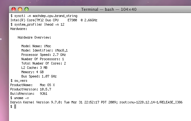

Shadow Sorcerer Posted May 15, 2009 Share Posted May 15, 2009 @blackosx: Updating from 10.5.6 was not so complicated for me. (?) I also used the combo update. However, I re-ran ep45-post-patch.sh from the install guide after that. The only kexts I had to take care of by hand were for audio. I did notice the "Error 35" bug had returned, but repatching IONetworkingFamily.kext took care of that. That was all my system required. I'm still using my old Chameleon install (1.x, which I did not need to reinstall after the update). My system also properly reboots (although I haven't tested sleep since it has never worked for me in the past). This kind of makes me wonder what's different between our systems... graphics maybe? I have a 7300GT enabled via Titan here. BIOS? (F8 here.) Link to comment https://www.insanelymac.com/forum/topic/135948-retail-dvd-1056-install-for-gigabyte-ga-ep45-ds3l/page/11/#findComment-1157476 Share on other sites More sharing options...
blackosx Posted May 15, 2009 Share Posted May 15, 2009 @blackosx: Updating from 10.5.6 was not so complicated for me. (?) I also used the combo update. However, I re-ran ep45-post-patch.sh from the install guide after that. The only kexts I had to take care of by hand were for audio. I did notice the "Error 35" bug had returned, but repatching IONetworkingFamily.kext took care of that. That was all my system required. I'm still using my old Chameleon install (1.x, which I did not need to reinstall after the update). My system also properly reboots (although I haven't tested sleep since it has never worked for me in the past). This kind of makes me wonder what's different between our systems... graphics maybe? I have a 7300GT enabled via Titan here. BIOS? (F8 here.) Hi Shadow Sorcerer You are absolutely correct. I restored my backup partition to my original Lensboard 10.5.6 install from a disk image I have which uses PC_EFI v9. Made sure it was fully up to date apart from 10.5.7, then did just what you said and Bingo!, it worked. Although I re-added the complete EP45-DS3L kext package, and the Disabler.kext to cure the Quicktime mouse skip, with UInstaller. This cured the reboot problem too. I think my other attempt got a bit too ambitious because I was using Chameleon v2, I got confused with the /Extra folder it uses to enable a fully vanilla install by having the modified extensions in the /Extra/Extensions folder, leaving the System/Library/Extensions untouched. I will try this again though and see if I can do it. As for the hardware my system details are in my sig, but I think it came down to my understanding of Chameleon rather than different hardware spec. But I have attached details to show you. Anyway, thanks again. And Lensboard, for your guide, I guess you can ignore my previous ramblings Link to comment https://www.insanelymac.com/forum/topic/135948-retail-dvd-1056-install-for-gigabyte-ga-ep45-ds3l/page/11/#findComment-1157585 Share on other sites More sharing options...

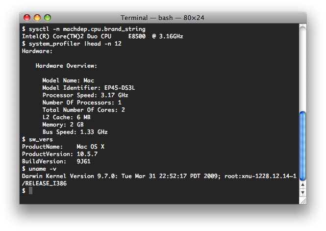

blackosx Posted May 18, 2009 Share Posted May 18, 2009 10.5.7 Update from 10.5.6 with Chameleon v2.0RC r431 Just to clear up my earlier experience, The successful way for me was as follows... • Boot into a different install. • Apply the 10.5.7 combo update to the 10.5.6 system. • Re-run PCWiz's UInstaller from lensboards guide and apply ALL the kexts ONLY. (NOT PC_EFI v9) • Add AppleDecrypt.kext, dsmos.kext & IntelCPUPMDisabler.kext to /Extra/Extensions. • Re-run the post-patch.sh (it will error complaining about permissions) • Reboot. Job done. Link to comment https://www.insanelymac.com/forum/topic/135948-retail-dvd-1056-install-for-gigabyte-ga-ep45-ds3l/page/11/#findComment-1158670 Share on other sites More sharing options...
