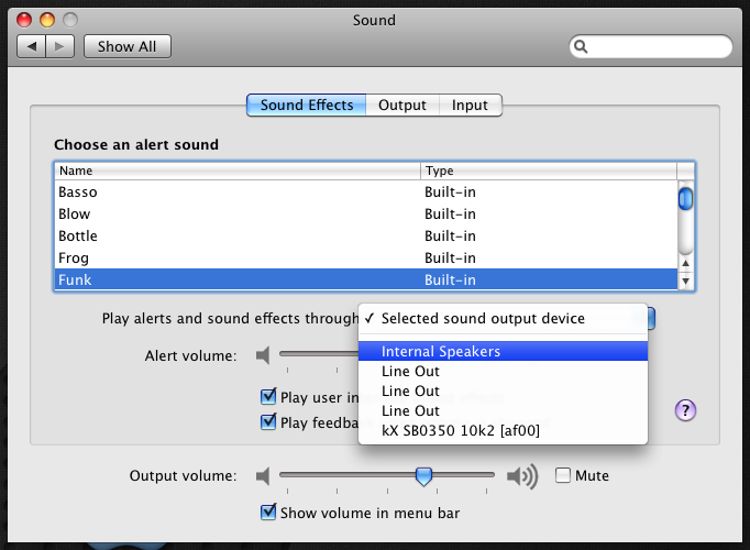

radov4n Posted May 30, 2009 Share Posted May 30, 2009 EVGA 132-BL-E758-A1 is a pretty easy board to work with, personally I like it more than UD5. The fan on it is virtually silent. The only problem is the sound card, but that's never been a problem for me since I use Audigy 2 card. But I believe there's a way to get it working. You can use DD's script to install retail 10.5.7 on it without much trouble. Link to comment https://www.insanelymac.com/forum/topic/132960-upcoming-intel-x58-mobos-core-i7-cpus/page/45/#findComment-1165865 Share on other sites More sharing options...

airwalk776 Posted May 31, 2009 Share Posted May 31, 2009 EVGA 132-BL-E758-A1 is a pretty easy board to work with, personally I like it more than UD5. The fan on it is virtually silent. The only problem is the sound card, but that's never been a problem for me since I use Audigy 2 card. But I believe there's a way to get it working. You can use DD's script to install retail 10.5.7 on it without much trouble. I took the HDA kexts from DD's script and changed the id's for the EVGA RELTEk 889 and I have all channels working give it a go just drop them in the /extra/extension folder and update boot cache. EVGA_Audio_Kext.zip Link to comment https://www.insanelymac.com/forum/topic/132960-upcoming-intel-x58-mobos-core-i7-cpus/page/45/#findComment-1167065 Share on other sites More sharing options...

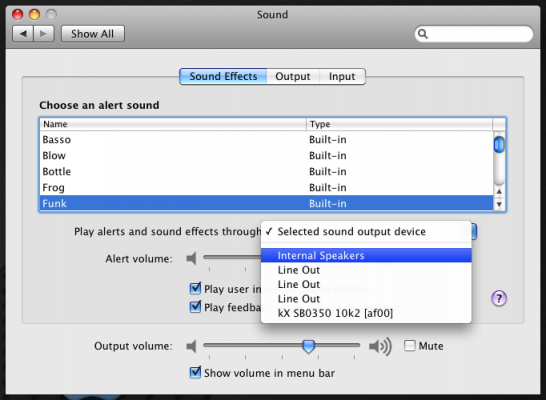

radov4n Posted June 1, 2009 Share Posted June 1, 2009 I took the HDA kexts from DD's script and changed the id's for the EVGA RELTEk 889 and I have all channels working give it a go just drop them in the /extra/extension folder and update boot cache. Ha! Cool, thanks a lot Edit: Added to /Extra/Stored_Kexts, updated boot cache, but for some reason that didn't work for me. Can only see my Audigy 2 in the System Preferences / Sound / Output. Edit 2: I am an idiot, I forgot HDAEnabler, looks like it's working, can use built-in realtek and my audigy Thanks again. Link to comment https://www.insanelymac.com/forum/topic/132960-upcoming-intel-x58-mobos-core-i7-cpus/page/45/#findComment-1167121 Share on other sites More sharing options...
Adrian M Posted June 2, 2009 Share Posted June 2, 2009 EVGA 132-BL-E758-A1 is a pretty easy board to work with, personally I like it more than UD5. The fan on it is virtually silent. The only problem is the sound card, but that's never been a problem for me since I use Audigy 2 card. But I believe there's a way to get it working. You can use DD's script to install retail 10.5.7 on it without much trouble. Hey radov4n, did you run into any problems, getting Mac OS 10.5.7 vanilla kernel running on this motherboard? does everything work, sleep, etc? From reading through here it almost seems that the evga board is easier to get working than the gigabytes? Of course it could just seem that way due to more people trying with gigabyte motherboards than anything else? Link to comment https://www.insanelymac.com/forum/topic/132960-upcoming-intel-x58-mobos-core-i7-cpus/page/45/#findComment-1167807 Share on other sites More sharing options...
airwalk776 Posted June 2, 2009 Share Posted June 2, 2009 Ha! Cool, thanks a lot Edit: Added to /Extra/Stored_Kexts, updated boot cache, but for some reason that didn't work for me. Can only see my Audigy 2 in the System Preferences / Sound / Output. Edit 2: I am an idiot, I forgot HDAEnabler, looks like it's working, can use built-in realtek and my audigy Thanks again. So it seems like you have everything working. I for the most part have everything working, 9800 GTX+ is solid now after I updated the bios, network ports are working, sound is working, my pci wireless it working, usb is working, firewire I cant test because I dont have any firewiredevices, Onlything I am stuck on is sleep and wake from sleep. with the EVGA X58 Mobo. Does yours work? Also what do you overclock yours to. I am at 3.9 stable with temps at 21 idle and 65 with load. Link to comment https://www.insanelymac.com/forum/topic/132960-upcoming-intel-x58-mobos-core-i7-cpus/page/45/#findComment-1168054 Share on other sites More sharing options...
radov4n Posted June 3, 2009 Share Posted June 3, 2009 So it seems like you have everything working. I for the most part have everything working, 9800 GTX+ is solid now after I updated the bios, network ports are working, sound is working, my pci wireless it working, usb is working, firewire I cant test because I dont have any firewiredevices, Onlything I am stuck on is sleep and wake from sleep. with the EVGA X58 Mobo. Does yours work? Also what do you overclock yours to. I am at 3.9 stable with temps at 21 idle and 65 with load. Might sound weird, but I haven't tested sleep. I kind-of can't reboot my machine atm, but when I do 'll get back when I do I run 3.2 ghz, around your temps. I should push it higher, having a nice fan and all. I am not sure about firewire either, I don't have a single fw device and I actually disabled the fw port in the bios. And another thing: I finally managed to install 10.5.7 on x58 i7 P6T, with 2 gtx 260's cards, using new netkas's kexts and universal injector. Here's a very lame overview: http://www.insanelymac.com/forum/index.php...t&p=1168561 Link to comment https://www.insanelymac.com/forum/topic/132960-upcoming-intel-x58-mobos-core-i7-cpus/page/45/#findComment-1168564 Share on other sites More sharing options...
