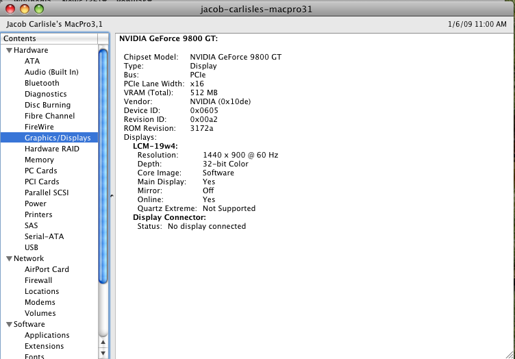

JCsHands Posted January 6, 2009 Share Posted January 6, 2009 Ok so I have the EVGA 9800 GT, it will work with NVinject, but I would like to use the EFI strings. I installed the 9000 series drivers and then followed your instructions on how to add the EFI strings into my com.apple.Boot.plist file. OS X boots, however I dont have QE or CI. Is there a step that I missed? Link to comment Share on other sites More sharing options...
