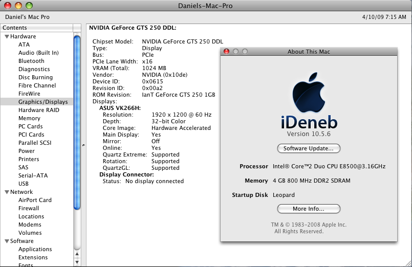

Ian T Posted April 10, 2009 Share Posted April 10, 2009 I just made an installer for the NVIDIA 9 Series Drivers taken from the new Macbookpro Update. Download it here: http://rapidshare.com/files/156247292/NVID...ver_v2.zip.html (Latest update- Version 2 - NVIDIA 9700m GTS added 062A-10DE dev id) (For the latest updates always use this link). My 9800 GTX now uses the correct Open GL Engine. 10.5.5 minimum requirement I would think. aqua-mac, i was wondering if you could give me some advice or pointers with regards to the nVidia GeForce GTS 250 1GB; which is a rebadged nVidia GeForce 9800 GTX+. i haven't had any luck with this installer (i continually get a kernel panic), then again the dev id for the GTS 250 is 0615 (061501de). i don't have any experience grabbing NVCAP or setting the VRAM totalsize manually. i haven't seen any gfx-strings for the 9800GTX+ with 1GB of RAM either. there have been some posts on the wiki that show people having success using OSX86Tools to install EFI strings into com.apple.Boot.plist, but that too also causes a kernel panic. i've tried other posts that use a customized 9800GTX kext, but so far no luck with those either. one would think it would be easy to reuse existing kexts for the 9800GTX/GTX+, but apparently it's a bit harder. thanks! best regards, ian t Link to comment https://www.insanelymac.com/forum/topic/132089-nvidia-9-series-driver-installer-v2/page/14/#findComment-1128853 Share on other sites More sharing options...
aqua-mac Posted April 10, 2009 Author Share Posted April 10, 2009 I have put up a in.plist for the GTS 250 1024 MB here. If it is basically a re badged 9800 GTX then you should have no problems and you should be able to get it to work. Did you also try something like NVDarwin.kext to check out if it is not something else that you are doing wrong? I would think 10.5.6 is also a given. Link to comment https://www.insanelymac.com/forum/topic/132089-nvidia-9-series-driver-installer-v2/page/14/#findComment-1129129 Share on other sites More sharing options...
Ian T Posted April 10, 2009 Share Posted April 10, 2009 I have put up a in.plist for the GTS 250 1024 MB here. If it is basically a re badged 9800 GTX then you should have no problems and you should be able to get it to work. Did you also try something like NVDarwin.kext to check out if it is not something else that you are doing wrong? I would think 10.5.6 is also a given. aqua-mac, i think i may have asked you for assistance a bit prematurely... but, thank you very much for responding... i was up till 8:30am PST trying to get things working with your how-to here: http://aquamac.proboards.com/index.cgi?boa...=509&page=1 I used your use of GFX Strings in conjuction with EFI v8 or higher. For my setup, the graphics card is located at "PciRoot(0x0)/Pci(0x1,0x0)/Pci(0x0,0x0)" NVCAP is BAAAAAAAAwAMAAAAAAAABwAAAAA=, which is the same for most any 9000 series graphics card. NVPM is AQAAAAAAAAAAAAAAAAAAAAAAAAAAAAAAAAAAAA==, which seems to be the same for most, some don't have it included. VRAM,totalsize is AAAAQA== for 1024 I modded in.plist to include my information: model = NVIDIA GeForce GTS 250 rom-revision = IanT eVGA GeForce GTS 250 1GB I then ran ./gfxutil -i xml -o hex ./in.plist ./out.hex, and copied the hex from out.hex to /Extra/com.apple.Boot.plist under device-properties. Your hint on including, worked like a charm!: <key>Graphics Mode</key> <string>1920x1200x32</string> Since I am using Chameleon 2.0RC1-r431, the changes to com.apple.Boot.plist were added to /Extra/com.apple.Boot.plist, instead of /Library/Preferences/SystemConfiguration/com.apple.Boot.plist I then referenced this thread > NVIDIA 9 Series Driver Installer v2... After I ran your installer, I added 0x061510de&0xffe0ffff to both NVDAResman.kext/Contents/Info.plist and NVDANV50hal.kext/Contents/Info.plist I also ran PCWiz's DSDT Patcher GUI, which created dsdt.aml; I placed it into /Extra/dsdt.aml I crossed my fingers and it was completely supported!! QE/CI Full Support (see attached image) I am also happy to report that I am able to restart and shutdown normally!! I read on some posts/replies that restart/shutdown didn't work, it would turn off/power off the signaling from the video card and the monitor would go to sleep. aqua-mac, without both your guides, I wouldn't have been able to figure it out... i also want to thank your fans (myself included), some of their troubles/solutions also helped light the way for me!!! My next step is to reproduce my success by installing vanilla using BOOT-132 method + Retail DVD. again, thank you for responding, I very much appreciate it!!! ps. i tried nvdarwin.kext and nvinject.kext, the kernel panicked. i think i even tried nvdarwin installer 1.25, the system would boot, but no display on either DVI-I connectors. i was able to reboot the system typing blindly though. pps. system specs for people that are wondering... ASUS P5Q LGA775 Intel P45 ATX Motherboard (ALC1200.kext) Intel Core 2 Duo E8500 3.16GHz 4GB (2x2GB) OCZ SLI-Ready Edition PC2-6400 Memory 5-4-4-15 @ 2.1v LG GGC-H20L BLURAY/HDDVD Reader DVD+-R Writer 1TB Western Digital Caviar Black WD1001FALS Netgear WG311T Wireless Adapter Up to 108Mbps (Atheros Wireless Adapters, pci168c,13-wep tested only) Antec Sonata III Case w/500 Earth Watts Power Supply Artic Cooling Freezer 7 Pro (keeps the CPU at a nice 25c) ART 26-in-1 Flash Memory Reader (tested and working properly in OS X) Link to comment https://www.insanelymac.com/forum/topic/132089-nvidia-9-series-driver-installer-v2/page/14/#findComment-1129503 Share on other sites More sharing options...

aqua-mac Posted April 11, 2009 Author Share Posted April 11, 2009 Nice one Ian, glad you got it working, and also to know that the GTS 250 can work without 10.5.7 update that should be due soon. Link to comment https://www.insanelymac.com/forum/topic/132089-nvidia-9-series-driver-installer-v2/page/14/#findComment-1129922 Share on other sites More sharing options...

Ian T Posted April 12, 2009 Share Posted April 12, 2009 Nice one Ian, glad you got it working, and also to know that the GTS 250 can work without 10.5.7 update that should be due soon. aqua-mac, thank you for your kind words! do you know if 10.5.7 has any graphics updates? thanks a million! IanT Link to comment https://www.insanelymac.com/forum/topic/132089-nvidia-9-series-driver-installer-v2/page/14/#findComment-1130398 Share on other sites More sharing options...
aqua-mac Posted April 12, 2009 Author Share Posted April 12, 2009 There is an Nvidia update with 10.5.7, but I was hoping for GTX 260/280 support, but I am told it does not have this. Hopefully 10.5.8 will. Snow Leopard has support but still obviously has a number of bugs. Leo on the other hand is incredibly stable these days. Link to comment https://www.insanelymac.com/forum/topic/132089-nvidia-9-series-driver-installer-v2/page/14/#findComment-1130424 Share on other sites More sharing options...
