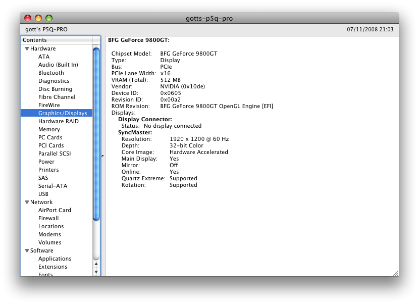

nfinity_ Posted November 7, 2008 Share Posted November 7, 2008 Great work! I got my 9800GT / 512MB working. EFi-StriNG: 640200000100000001000000580200000d00000002010c00d041030a000000000101060000010101 60000007fff04000e0000004e00560050004d0000002000000001000000000000000000000000000 00000000000000000000000000220000005600520041004d002c0074006f00740061006c00730069 07a006500000008000000000000201c0000006400650076006900630065005f00740079007000650 00000f0000004e5644412c506172656e740e0000006e0061006d00650000000b000000646973706c 17922000000400030002c006400650076006900630065005f00740079007000650000000b0000006 6973706c617922000000400031002c006400650076006900630065005f0074007900700065000000 b000000646973706c6179100000006d006f00640065006c00000016000000424647204765466f726 652039383030475420000000400031002c0063006f006d00700061007400690062006c0065000000 e0000004e5644412c4e564d616314000000400030002c006e0061006d0065000000120000004e564 412c446973706c61792d4114000000400031002c006e0061006d0065000000120000004e5644412c 46973706c61792d4220000000400030002c0063006f006d00700061007400690062006c006500000 0e0000004e5644412c4e564d6163100000004e005600430041005000000018000000040000000000 3000c00000000000007000000001e00000072006f006d002d007200650076006900730069006f006 0000002a000000424647204765466f72636520393830304754204f70656e474c20456e67696e6520 b4546495d have fun (wasnt able to attach .plist file) ... but shouldnt be needed anyways. Link to comment Share on other sites More sharing options...

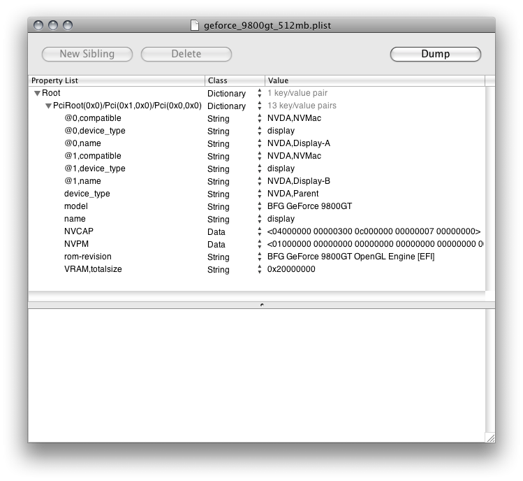

aqua-mac Posted November 10, 2008 Author Share Posted November 10, 2008 That's why it is reporting 256 mb. Did you not try making your own GFX String. Instructions are here: http://aquamac.proboards106.com/index.cgi?...&thread=509 Link to comment Share on other sites More sharing options...
Assa55in Posted November 11, 2008 Share Posted November 11, 2008 Yes but that website is for a 9800 gtx i have the 9800m gt won' that mess up some of my settings and also why isn't there a refresh rate next to the resolution Link to comment Share on other sites More sharing options...
aqua-mac Posted November 11, 2008 Author Share Posted November 11, 2008 This will also work for any Graphics card, you need to select a download with the same amount of memory then change the part where the name of the card is. Follow the instructions and make the string. You do not set a refresh rate. Once everything is working correctly, that can be selected from displays in System preferences. Here I modded the plist for you, download it and follow the instructions at my website. gfxutil_512_MB_9800M_GT.zip Link to comment Share on other sites More sharing options...
