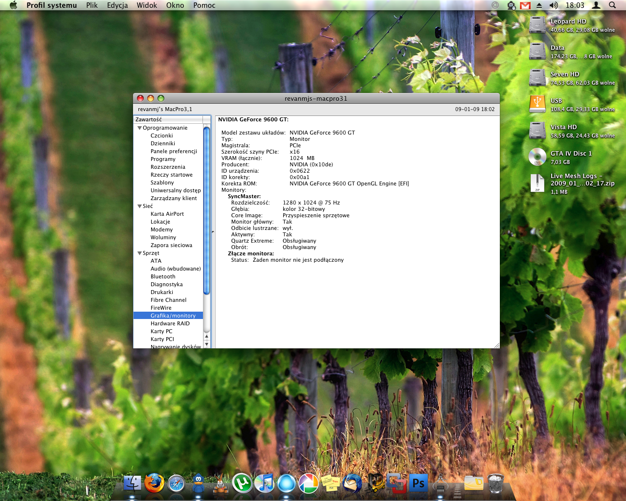

revanmj Posted January 11, 2009 Share Posted January 11, 2009 Works very well with my Palit GeForce 9600 GT I used EFI-string generated by OSx86 Tools Link to comment Share on other sites More sharing options...
