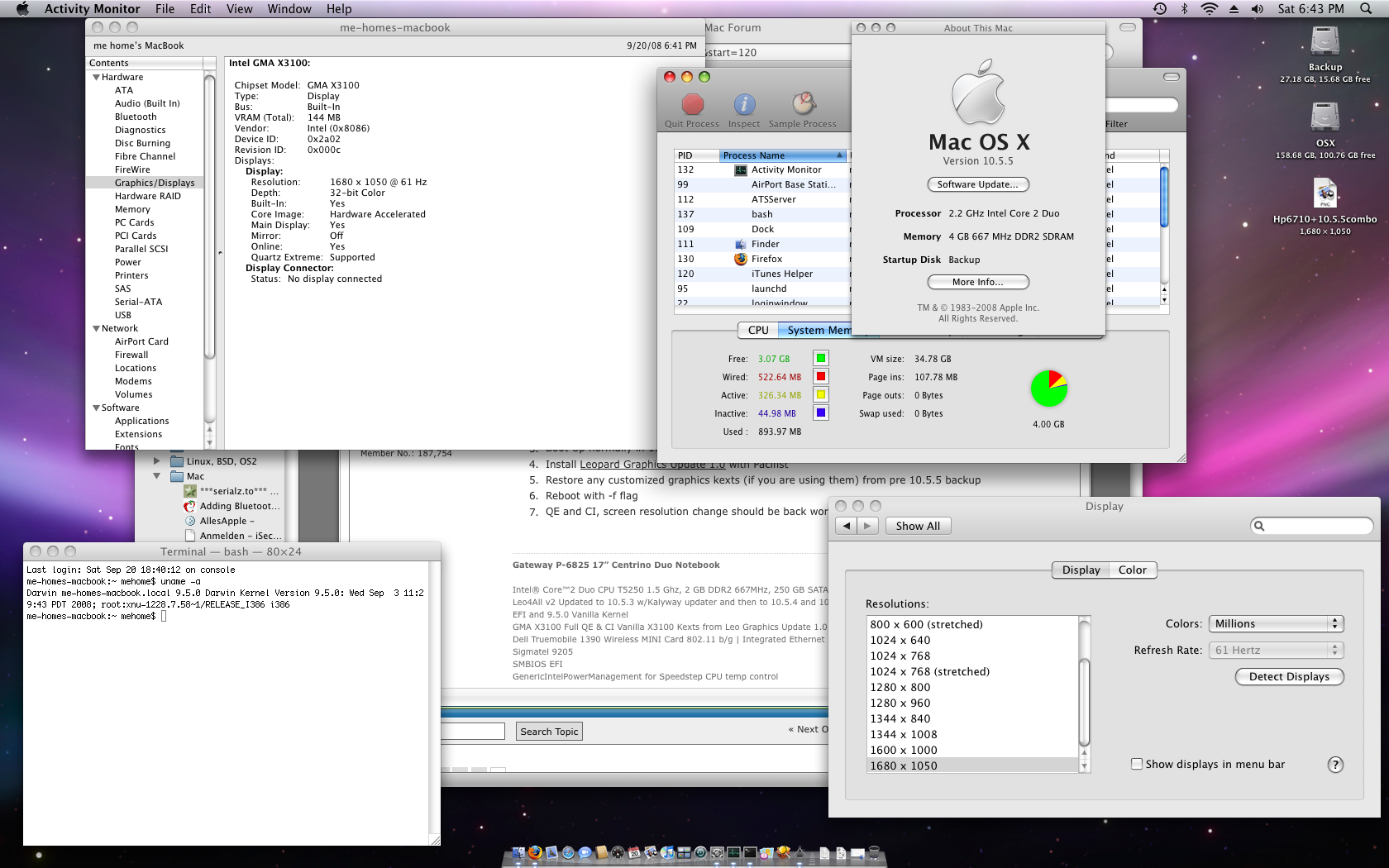

jayman30 Posted September 20, 2008 Share Posted September 20, 2008 Hackintosh problem??? Success mostly here on my Gateway Hack, installed via OSX Software Update, but got the "black screen of death" with 2 mouse cursors on reboot. I have Intel Integrated X3100 GMA 965 Graphics. FIX FOR INTEL X3100: Reboot into Single User Mode Manually Delete X3100 Kexts from /System/Library/Extensions Boot Up normally in 1024x768 Mode Install Leopard Graphics Update 1.0 with Pacifist Restore any customized graphics kexts (if you are using them) from pre 10.5.5 backup Reboot with -f flag QE and CI, screen resolution change should be back working! Link to comment https://www.insanelymac.com/forum/topic/126203-release-1055/page/6/#findComment-898814 Share on other sites More sharing options...
me@home Posted September 20, 2008 Share Posted September 20, 2008 THANK YOU ! You saved me, I did just install the X3100 out of the Leop. Graphics Update 1.0 but now working with full QE + CI. Link to comment https://www.insanelymac.com/forum/topic/126203-release-1055/page/6/#findComment-898878 Share on other sites More sharing options...
