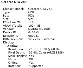

I hope this thread will be of use to those having some trouble with CUDA because of failed driver injection...
I know the solution must be simple but searches of the threads have revealed little.
I just updated to a more recent Chameleon bootloader for Gigabyte GA-X58A-UD7 board using this excellent guide
http://www.efixusers.com/showthread.php?t=605
The main reason is that I am trying to get CUDA working with my EVGA GTX 285
The problem is that I can't get the Chameleon boot loader to inject the NVIDIA.ROM properly.
System profiler shows the rom version as:
ROM Revision: xx.xx.xx - internal
I have been trying to get chamelon to inject the EVGA rom (156k) with the following com.apple.Boot.plist

Any tips on how to get the rom properly injected?

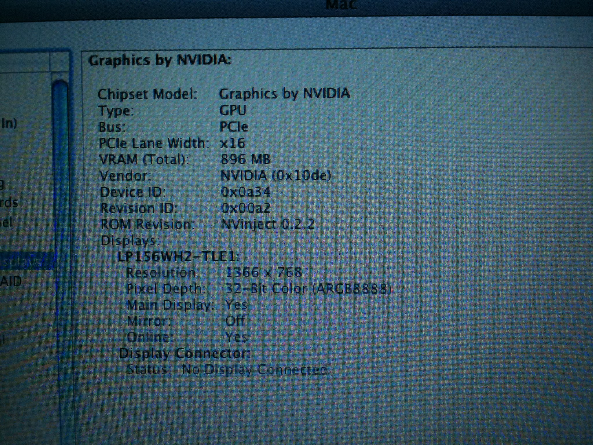

Well spank my ass and call me Sally!
Posting earlier got me motivated again to make this card (GeForce 210) work. Sure enough Once I dumped my own BIOS, ran NVCAP, created an EFI string using generic 512 setting and then remembered to disable Graphics Enabler by removing it from the com.apple.Boot.plist completely, the card is working perfect.
Helps to have a test/dev environment installed separate that is a mirror of my production drive so I could keep playing with it.
I also got 210, great to see that is working for you. Could you do little guide for newbie like me.
I had PC all my life, I don't know how to dump BIOS, run NVCAP and create an EFI string.
This is last thing I'm missing.

HI Guys,having problems getting my gt240m (Mobile) to work,becouse i cant find a working compatible string .Im Using NVenabler but without QE,CL etc.Anyone willing to help and provide a working GFX String?
Ive been trying tons of Nvidia String bo non is similar to my gt240M.
Having a Acer Aspire 5739g with Snow Leopard Retail 10.6.3
Regards Oliver
