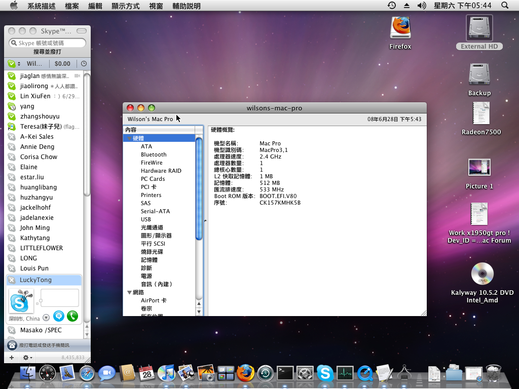

bronicaps150 Posted July 8, 2008 Share Posted July 8, 2008 Dear All, I had almost suscess install Kelyway 10.5.2 with my old 865 chipset 512M RAM AGP system (on-board sound and Lan out of the box ),only 1950Pro AGP work only 1024*768 milion color and USB devise should plug-in before boot-up. I plan to buy a new rig, I would like to know for P45 system: Should be OK for Kelyway 10.5.2 method ? Due to I am a Linux dummy. Pls share your install step if possible ,Thanks All. Link to comment https://www.insanelymac.com/forum/topic/112033-osx86-on-intel-p45-chipset/page/3/#findComment-811401 Share on other sites More sharing options...
